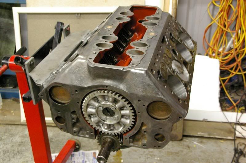

to me the way you have mounted It I would be happy, as you have got the centre of gravity lower down which helps when turning it. if in doubt what I do is cut a piece of wood to go under the snout of the crank when the pulley is off. make it a little bit longer than what you measure from the floor to the underside of the crank. about a half inch. this will take some of the weight off the stand, and distribute the weight.
I do this with flatheads as when I put them in the stand they seem to sag forward and I just like to be a bit safer. the other sort of stand is like this, this is a sort of copy of an original ford part that mounted off the exhaust bolts, very sturdy and stops the weight hanging out away from the mounting surface so much.
I also prefer the 4 leg ones as they won't tip over and these things are like motor bikes, if they start to go your in trouble.
