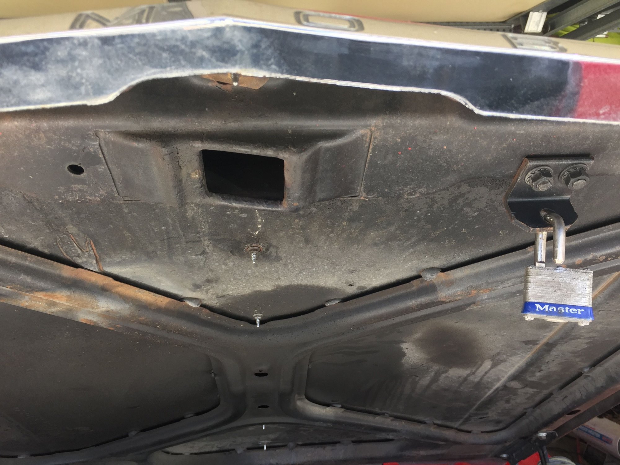

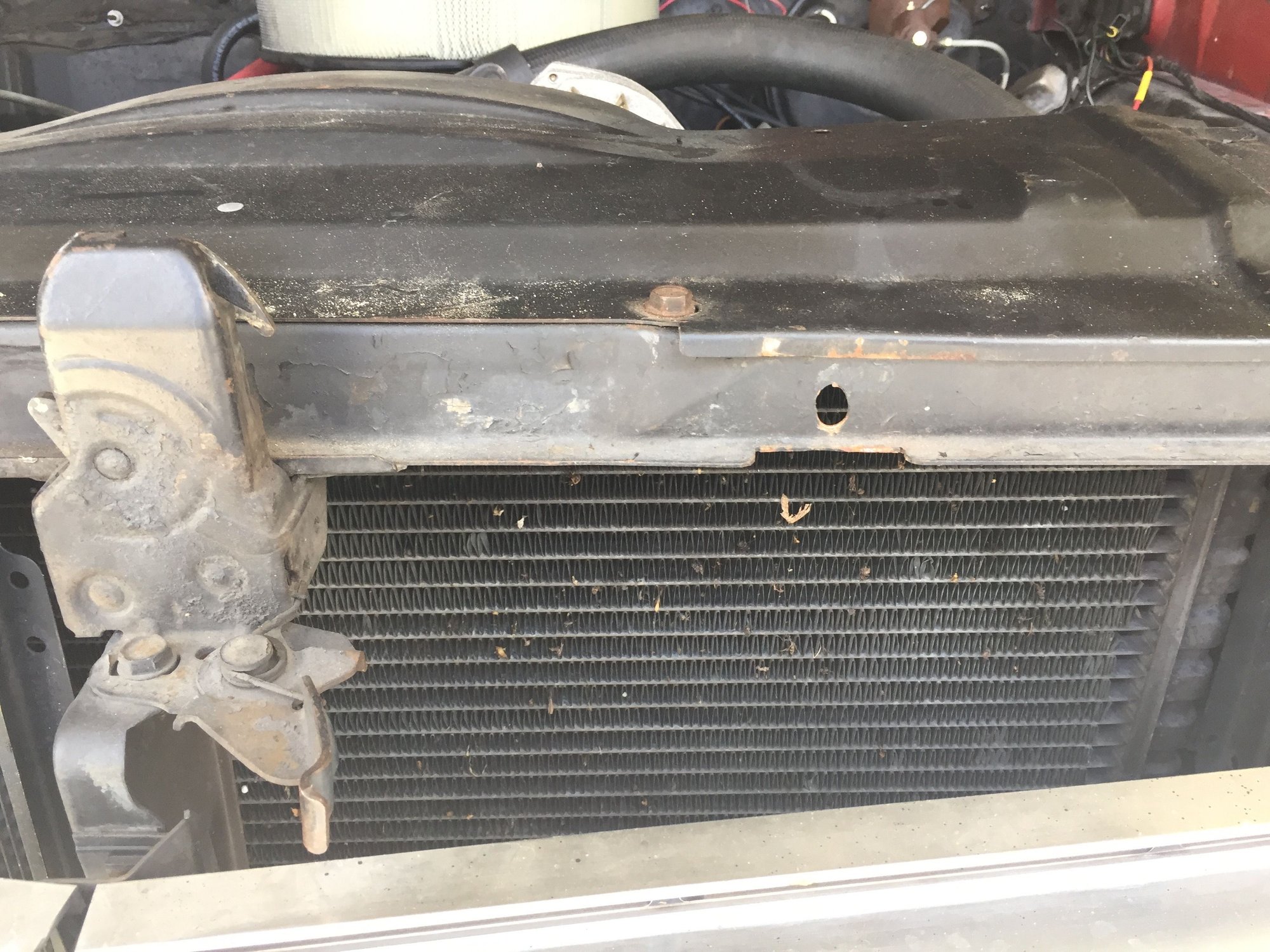

20 years ago drove my 66 convertible from nj to key west florida. since you can open hood direct from ouside i installed a small piece of angle steel to bottom of hood with a hole that ligned up with a hole i drilled into front radiator support and put a small padlock. just enough room to get hand up there to use key, impossible to cut lock or use bolt cutter.

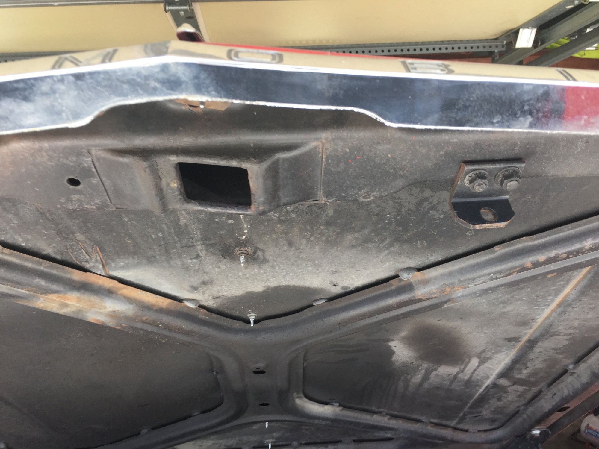

second pic just shows lock on bracket, its hard to take a pic when locks installed, difficult to see up under the hood
