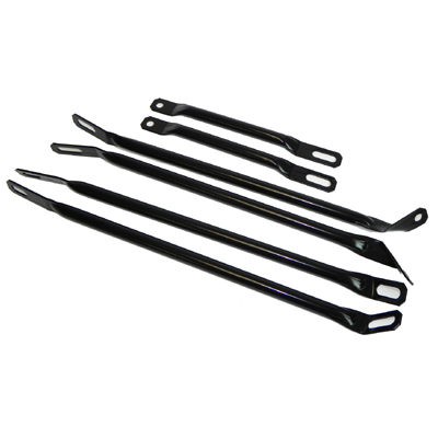

Greg, that brace is from a 71-72 A body front bumper - I'm positive.
Dave - the braces have slots so the front bumper can be positioned and the brace tightened to the bumper and frame. Does the other end look like one of these long ones??
I also think if the CS and lower models needed those braces, they would have been installed from the factory. Note the length and position of the braces for the VC I posted earlier. I would ditch them as they don't really serve any practical purpose.
The ones I have look like the third set from the top in your pic, but if those ones are for the VC, then they're not the ones I have, as mine are too short to go from the rad support to the firewall.

No Dave, those are the front bumper braces for ALL the Olds A bodies in 71/72. And yes that includes VC. But the VC had different braces for the cowl to rad support. You should look and see if your car is perhaps missing a set of braces on the front bumper. There should be six of them holding the bumper in place.

Where would they be Allan?

Attached to the front bumper and bracket bolted to the frame rail. Look in your 72 Cutlass Assembly Manual - Section 14 page 100

I don't have an AM...would be in the CSM or body manual?
