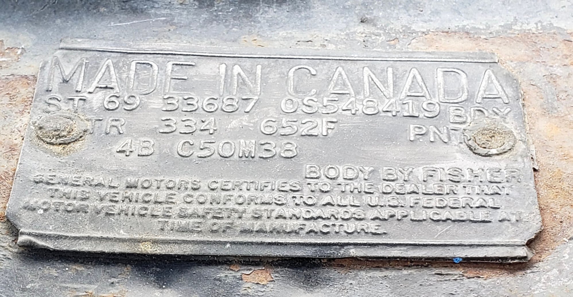

Can’t seeming to work out the original paint code any help will be very appreciated.

Why is it a "bad" cowl tag?
Your lower body color is 65, Topaz
The "F" indicates a Sable vinyl top. The "2" before the "F" was used by Oshawa to indicate a vinyl top. A "1" before the letter would have indicated a convertible top. Other Fisher plants apparently didn't feel the need to point this out, as the body style code would have told you if it was a convertible or not.
