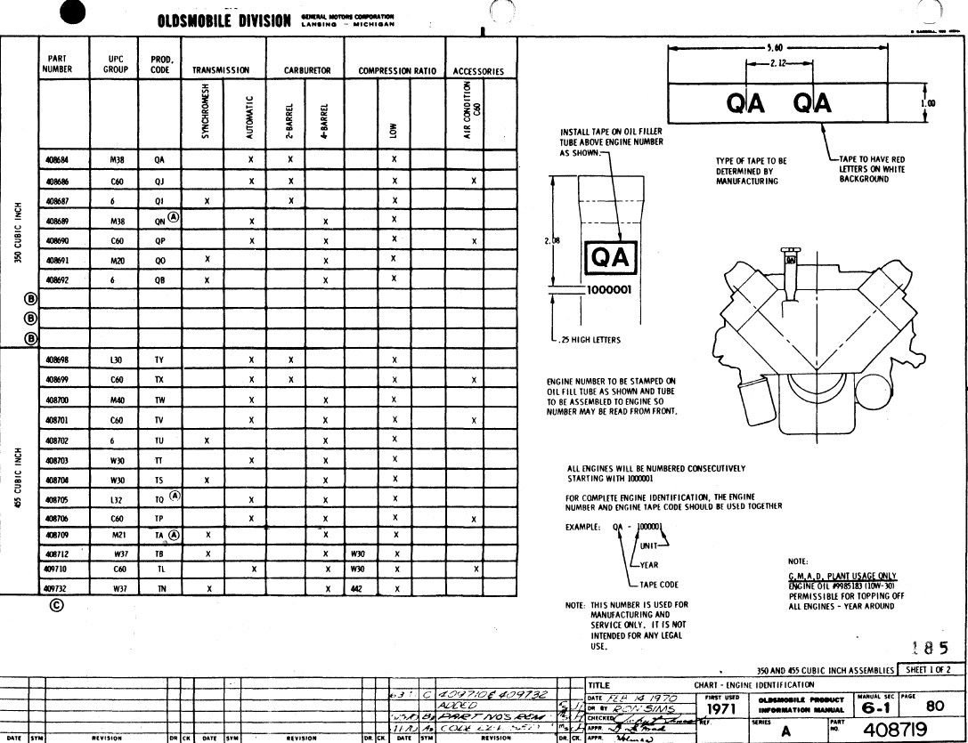

Have a DECAL
TL 409710 TL
A4ASNW30
Eng assy manual shows just
TL
Which is right

With regards to a DECAL only, I believe the correct DECAL = TL (red letters, white background)
Any other number would not be a decal but instead a STAMPED engine number.
