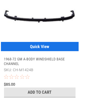

Is this repopped? Where or who? I cant find one.its just the inside piecr and not the cowl

I don’t know much about the A bodies, but all the fixes I’ve ever seen involve custom welding.
To avoid that see if you can find such a part for a Chevelle or Lemans, or GTO
With my big cars, it wouldn’t be a question. Nothing like this is reproduced.

This might be what you're looking for
https://autobodyspecialt.com/1968-72...-base-channel/

Open it up to reveal the extent before ordering parts. You may need more... lots more.
Pull the fenders. Look at the firewall to frame mounts.
Can you weld with a mig or tig?

Good that the cowl is at least available.

I had the same issue with my car, you may want to source it from a doner car. I don't think that repop panel will give you enough material. As previously stated, there is a high probability that there is much more to fix once it's removed.

I'm not sure on the above panel..I havent seen it but it said slides over.
The only way is to clean weld bonds
to my knowledge
