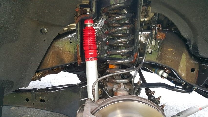

Here is my 11 F250 after a fresh saucing..that's 10 years fo driving in this schizt.. Note the added Ford plastic inner wheel wells. $130. Only the Platinums come with them standard???

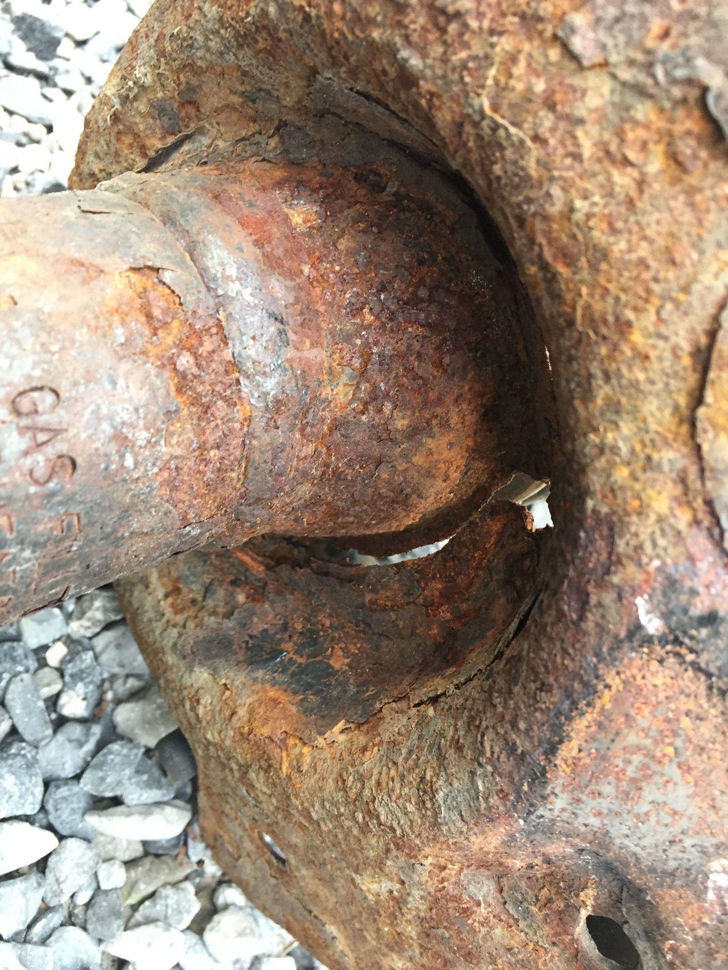

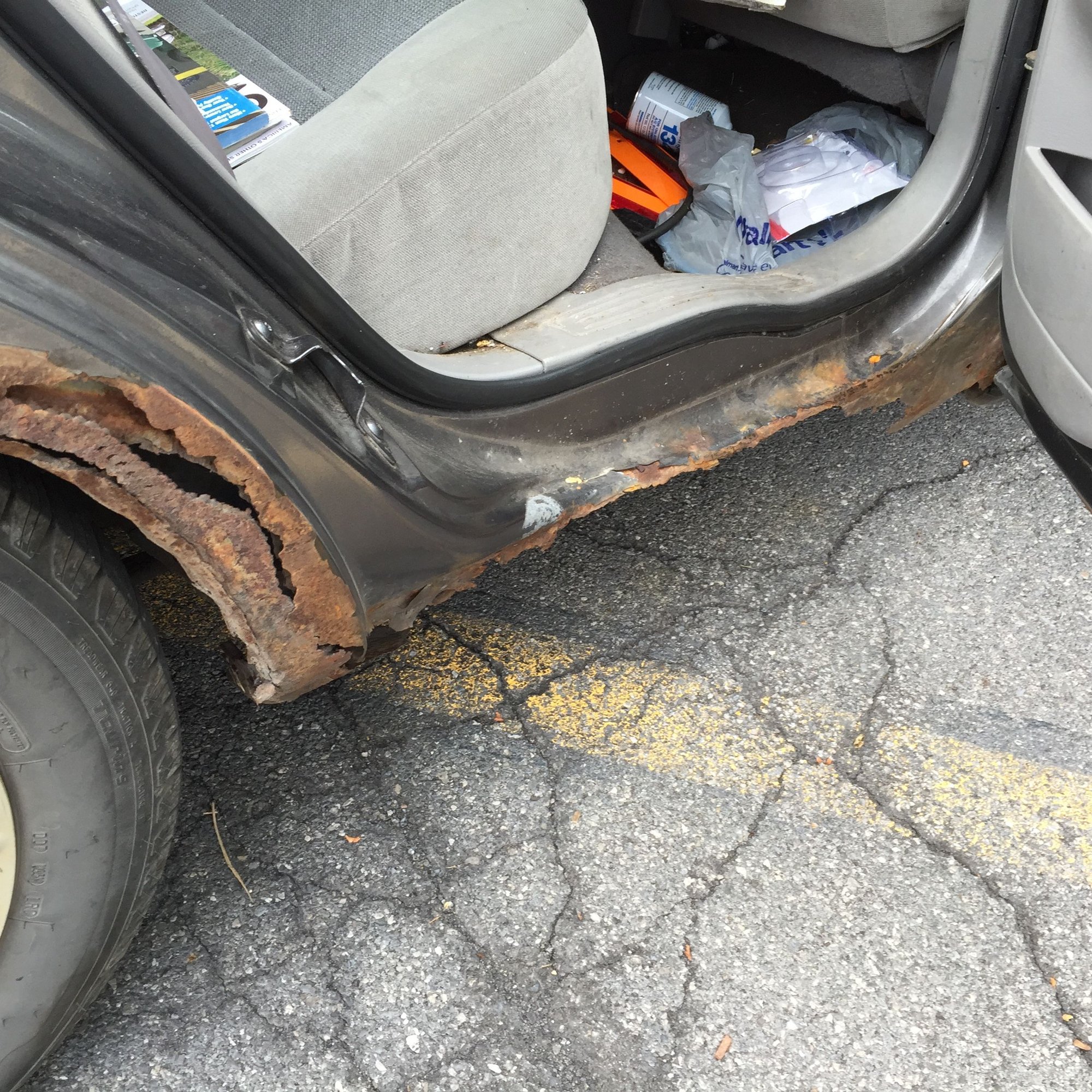

My friend's vehicle at about 10 years of daily use in this area. He say's he doesn't need no stinking rockers. On his Silverado even his rear end cover rusted through, I did think that was possible. Although my power steering reservoir and oil pan rusted through on my old Caprice at 10 years.
Regular washing can't seem to combat 3 times a day road salting. I've come to regard daily drivers as expensive disposables.

Here is my 11 F250 after a fresh saucing..that's 10 years fo driving in this schizt.. Note the added Ford plastic inner wheel wells. $130. Only the Platinums come with them standard??? You desert guys got it soo good!

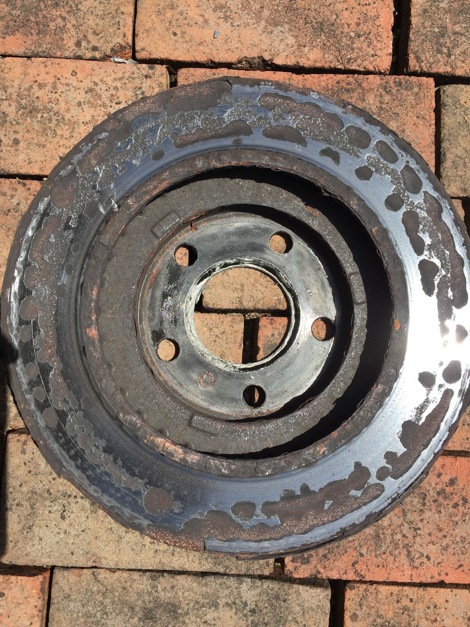

My prior daily driver was a 2003 Buick LeSabre. It was a very good car and with snow tires, unbelievably good in our hilly area. I rinsed out the wheel wells and the underside typically twice per week in Winter. The body stayed quite respectable but not the underside. I had to replace all the brake lines and the transmission cooler lines. Got into the routine of replacing brake rotors every summer. And it was Ziebarted!
These were supposedly NAPA premium rotors, 2 winters and about 12,000 miles. Chunks flaking off of the surface. I was wondering why I had a pulsating pedal. The struts were also 2 winters and maybe 18,000 miles. The strut collapsed (spring plate broke at the weld) driving home from work one day so that the tire was rubbing on it. It's so ridiculous my car friends here just laugh about--we all have similar stories. What else can you do? Walk or move.

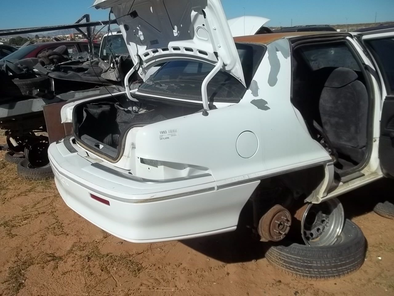

Used to wonder why guys in the rust belt would come here and buy cars we had written off as unrestorable. Then I went to Lansing for the Centennial and saw 3 year old cars with quarters and fenders rusted halfway up the panel and flapping in the wind.
It suddenly made sense. Our definition of rusty was a lot different than rust belt definition.
