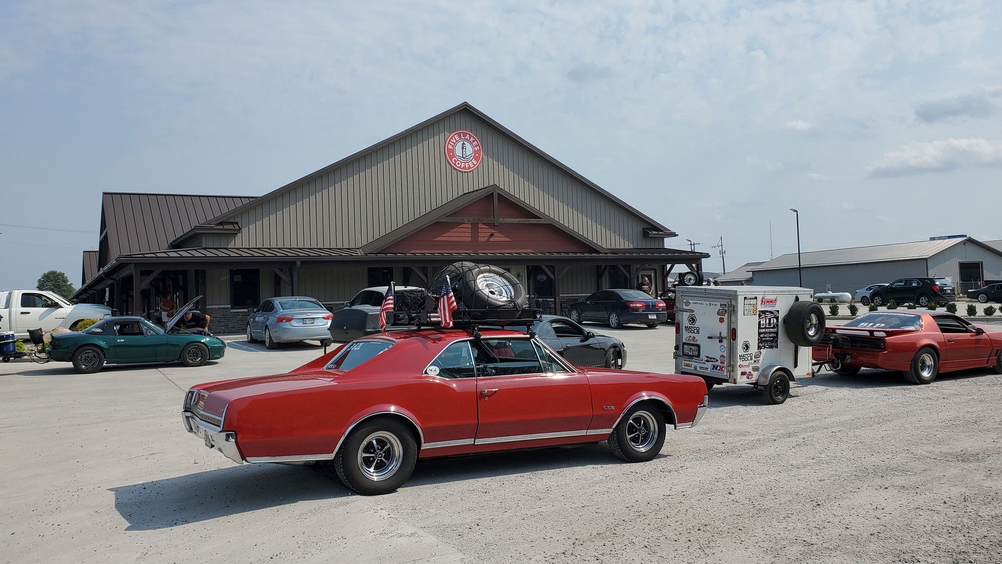

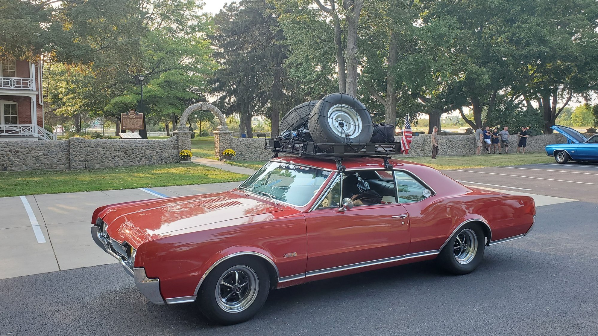

I don't know what you're talking about
Seriously, the "period correct" ones I've seen have been custom built. Maybe try to get ahold of Sick Fabrication (you're in MI, right?).

Looking for something a little less bulky lol. But how solid does that feel on the drip rails?

it's solid on the rails. The safari basket is aluminum, and the rails (aluminum)/stands (steel) are Amazon specials. I had a steel framed 10x10 canopy, the drag radials, 2 folding camp chairs, and a 6x2 folding table up there. The rear rail was pretty close to the roof, so I wrapped a terry cloth towel around it to keep from scratching the paint. It worked well. I didn't do a trailer because of manual trans, steering, and brakes. It's hard enough to park on its own.

That is QUITE badass Fleming.
Hardcore racer **** right there!

The safari basket had a channel for uni-strut nuts, so that's how i bolted it together. The towers are tension fit on the rails.
Thanks, Peter! I'm trying again this year.
Funny thing: you can tell by the squat whether the air bags were intact or not. The tailpipe was too close to the spring and kept burning a hole in the driver side.
