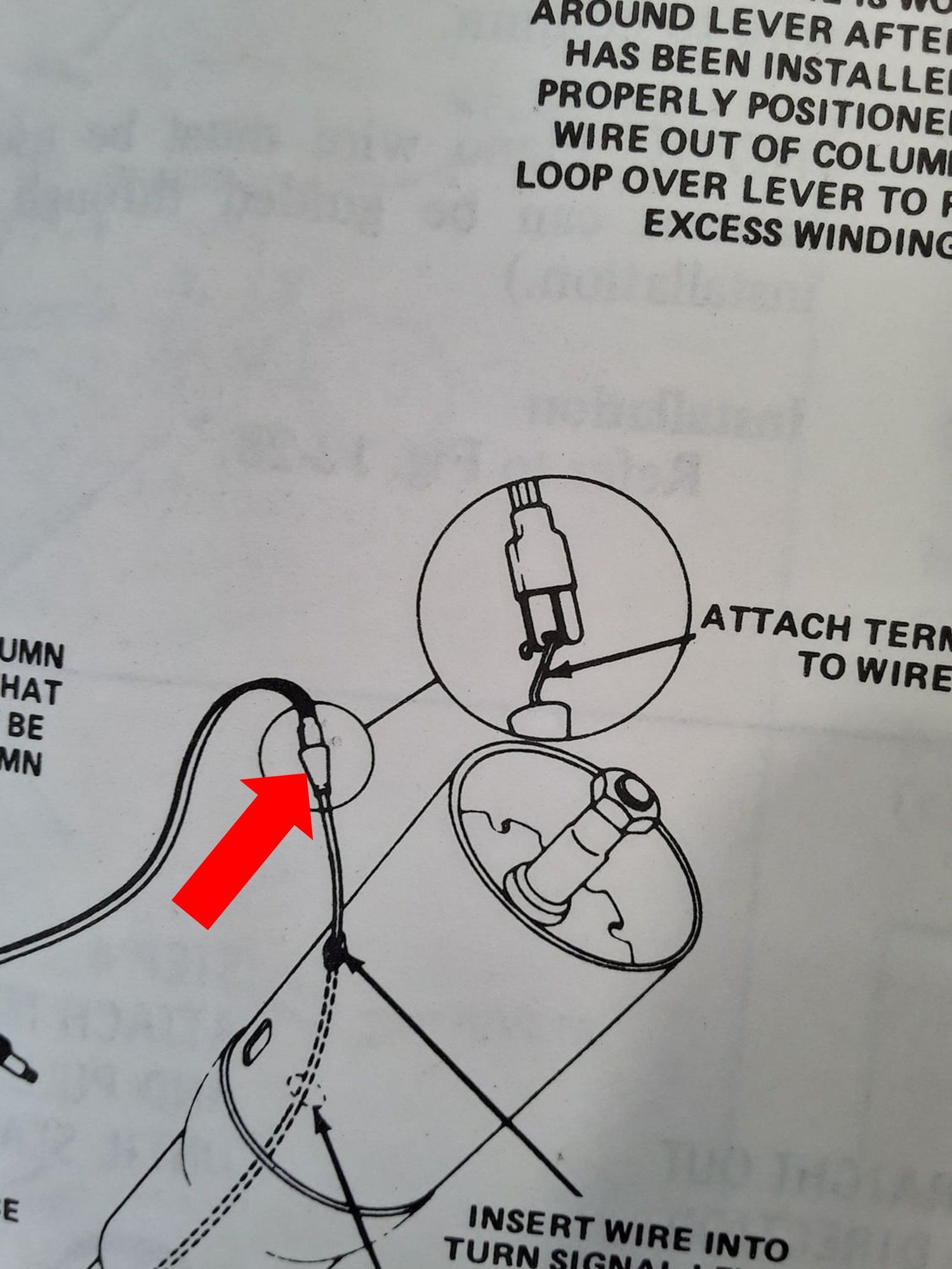

Does anyone know what the small cone tool circled in the picture is called?
It's used to help guide the cruise control wire down the column. CSM just calls it "tool" and doesn't show it in the tool page of either the steering column or accessories sections. Not sure if the fish wire is part of it or not.
We got the wire run back down the column using a wire but on a late 70s car with column mounted dimmer switch there's a lot of stuff to navigate around. Pull, hang up, back up, try again half a dozen times. But when you hit it just right it slides right thru the column.
There's reasons they made those special tools and even though I don't do much steering column work anymore I'd like to have it. I just don't know what to tell google to look for!

Appears same type (with blunt end) as identified in your image inclusive of fish wire with blunt end (identified by circles) used to snake through the gemish.
VIMEG20-Wire Puller-VIM TOOL

The rigid toll that Norm posted doesn't look like it will be able to negotiate the path in the column that requires a flexible fish tape. I do this by tying a line to the old wire before I pull it out.
Old Mar 23, 2024 | 07:49 AM
Posts: 26,052
Description of the tool states:
Flexible Spring Steel Body aide Wire Installation in Tight Areas
Don't own one - can't confirm.
