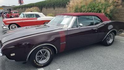

Beautiful car - I would change the top. Does this look like the correct burgundy paint ?
Old Oct 9, 2021 | 09:06 PM
Cosmic Charlie's Avatar
Joined: Sep 2018
Posts: 633
From: Newburyport MA Area
From here ... Post 5 (Joe P)
https://classicoldsmobile.com/forums...estion-138035/
The only available convertible top colors for 1969 were white, black, blue, and gold. "P" designated a gold convertible top. Not surprising for an Aztec Gold car. Again, this info is in the PIM, Section 0, page 183.
my 69 Cutlass S vert has 57 P PNT
