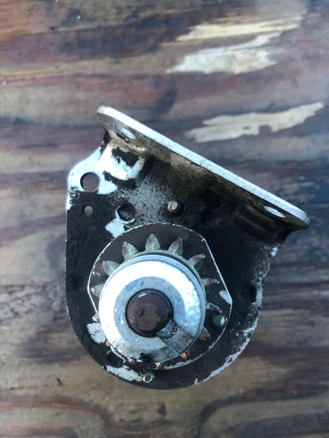

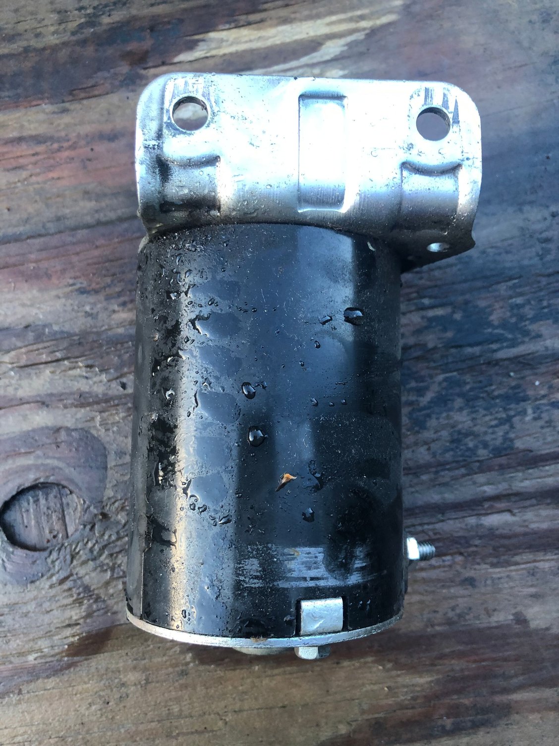

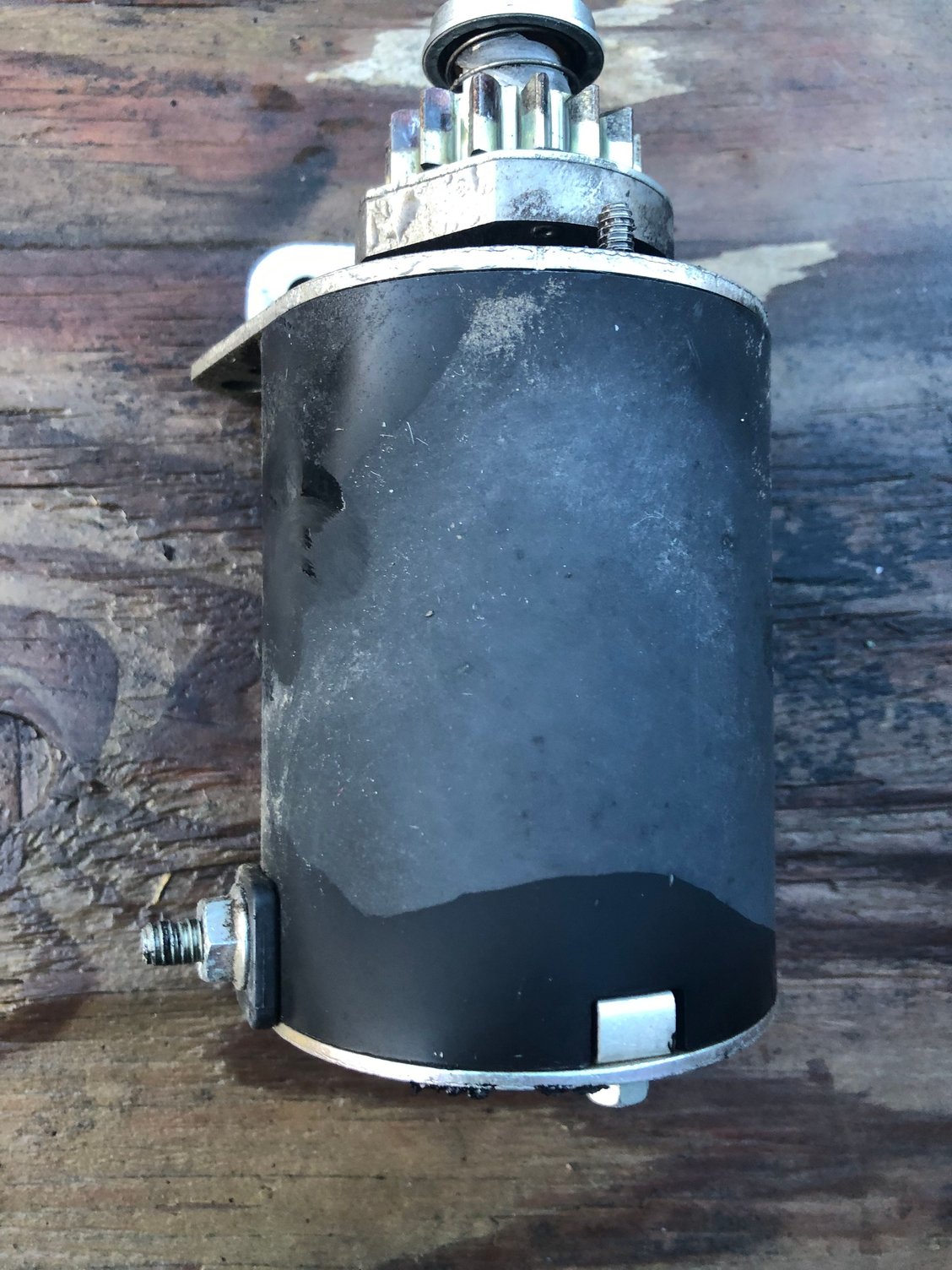

I’ll take a pic of the starter motor. It’s about the same size as a wiper motor on most cars made recently.

this is my spare starter. Not much bigger than a coke can.

I see from the pics it is a ccw rotation. How many teeth on the drive? 14? Can you measure the length of the field case? MM or inches. Do you have any room if there is an extension on the end of the drive instead of being flat? Is it used with a steel or aluminium flywheel?

I was really looking for the model, type and code off the engine. But the Sears number worked O.E starter 593934 from briggs. Don't buy the knock offs, junk.
Here is a link for a high torque unit, but as some said above measure your mounting area to the chassis to see if you have the clearance?
