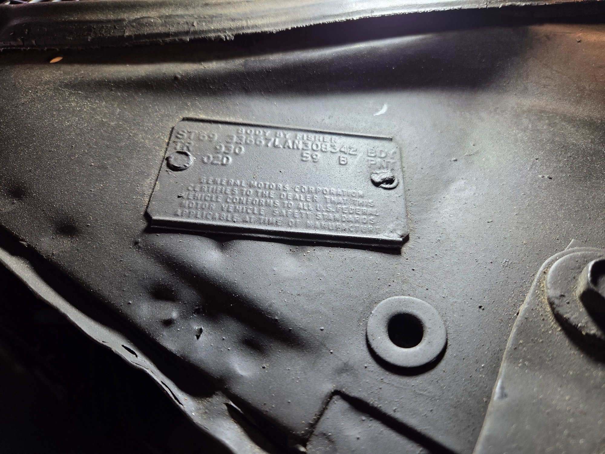

Do you have a picture of the body tag? The paint codes always seem to be fugged up a lot trying to figure them out.

Posting a photo of the cowl tag would be helpful.

VIN # 336679M226689
TRIM TAG
ST69 33667LAN226850
TR930 75 P
12 C

VIN indicates your car is a Cutlass S, as follows:
33667: First 3 = GM division = Oldsmobile; 36 = model series = Cutlass V8; 67 = body style = convertible
9 = model year = 1969
M = assembly plant = Lansing MI
226689 = assembly plant sequential number
Trim tag as follows:
ST 69 = style/model year = 1969
33667 - same as above
LAN = assembly plant = Lansing MI
226850 BDY = Fisher Body number (has no relationship to the VIN plant sequential number)
TR 930 = interior color AND front seat type = black interior with bucket seats
75 P PNT = lower body color (75) = aztec gold AND convertible top color (P) that doesn't match up to anything. It's possible what you see as a "P" is really a "B" which would be a black convertible top, or an "F" which would bea brown convertible top, or possibly even an "E" which would be a "parchment" color.
12C = time build code = December (12), third week of that month (C), 1968.
A VIN derivative is stamped into both the engine block and the transmission casing that you can check to see if both are original to your car.
Randy, we already answered this in post #5 above. The only available convertible top colors for 1969 were white (A), black (C), blue (C), and gold (P). "P" designated a gold convertible top. From the 1969 PIM:
please assist
