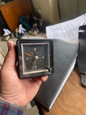

My clock ain't workin'. It's getting power. I've heard some folks say, "leave it out in the sun - it needs to get warmed up. the inner workings get gummed up...".... Which may be true, and this car sat for a few years before I recently bought it. But thinking I should open it up, clean, etc. to get it operational full time.
How do you open it up? It looks like the black metal/tin trim has 4 indentations at the corners.... Is that all I need to do to get the back cover off?
Thank you.
Jay

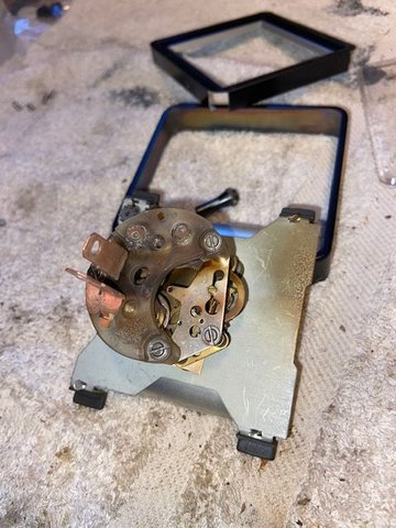

I got that black rectangular trim off ...but can't open the back of the clock to inspect/repair. Thoughts?

Great inputs. Thank you. I had an epiphany today and slid the back casing to the side and all four tabs of the clock released. Then I had to do a bit of gentle prying to get the other parts of the 4 corners released and ...voila. Now she's apart and I can start looking for culprits. Thanks again.

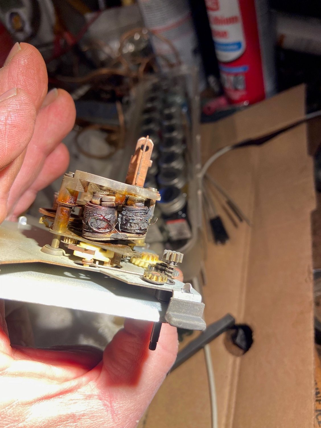

That damage looks like old, maybe slightly burnt varnish. Usually on motor windings the wires are varnished after the winding process, look at any motor or generator/alternator. I don't think that damage is significant enough to adversely affect the clock. If you want to clean it off however, the only thing we ever used in my 40 years of electronics was simple denatured alcohol. It is mild enough to not damage electronics circuit board substrate and coatings like new varnish but will be able to remove surface dirt and crud or old cracked/burnt varnish. On newer circuits that use silicone coatings it won't do as well but still won't damage. To apply the alcohol and agitate the surface we used what was called alcohol brushes which were small utility brushes with natural bristles attached to a metal tube (handle) and it was crimped on the end to hold the bristles in place. You can still buy them at art/hobby stores although they may be called something else. The bristles are quite long and flexibel but it you want them stiffer just trrim them off with some scissors to the desired stiffness. This may not help you solve your problem but it might possibly enable you toward that end, having everything cleaned and the debris out of the way at least makes it easier to see what you are dealing with.

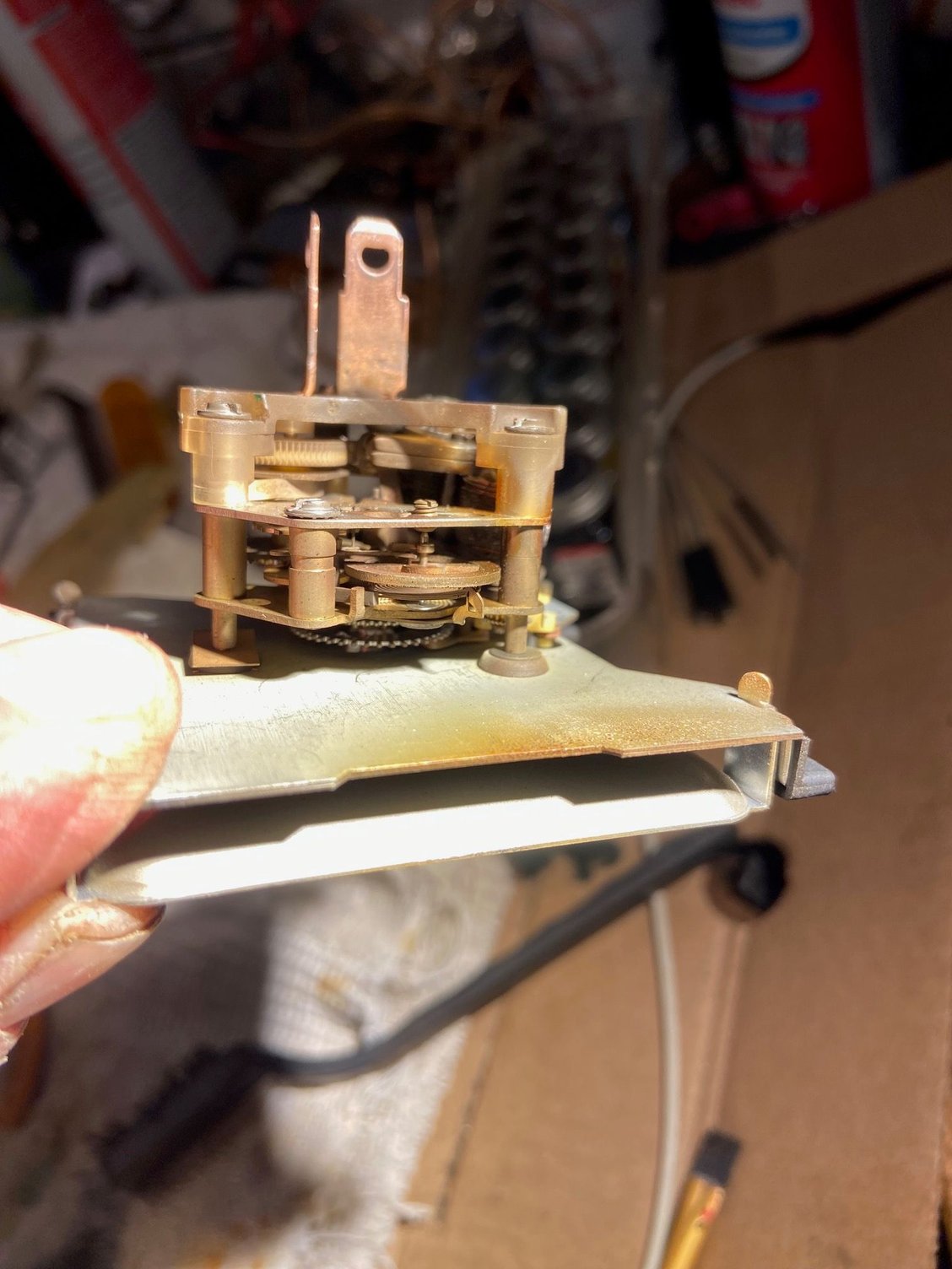

So. I think I made a little progress after brushing those nasty/dirty "windings" with the denatured alcohol. Noticed that one of the tiny brass/copper wires was not longer soldered to the post it should have been on - and so I did that. Let it all dry overnight, connected to a test battery this morning and ...ZAP. So, I'm thinking I took a little step forward, then a solid one back and maybe proving this clock has told it's last time. (see what I did there?).
