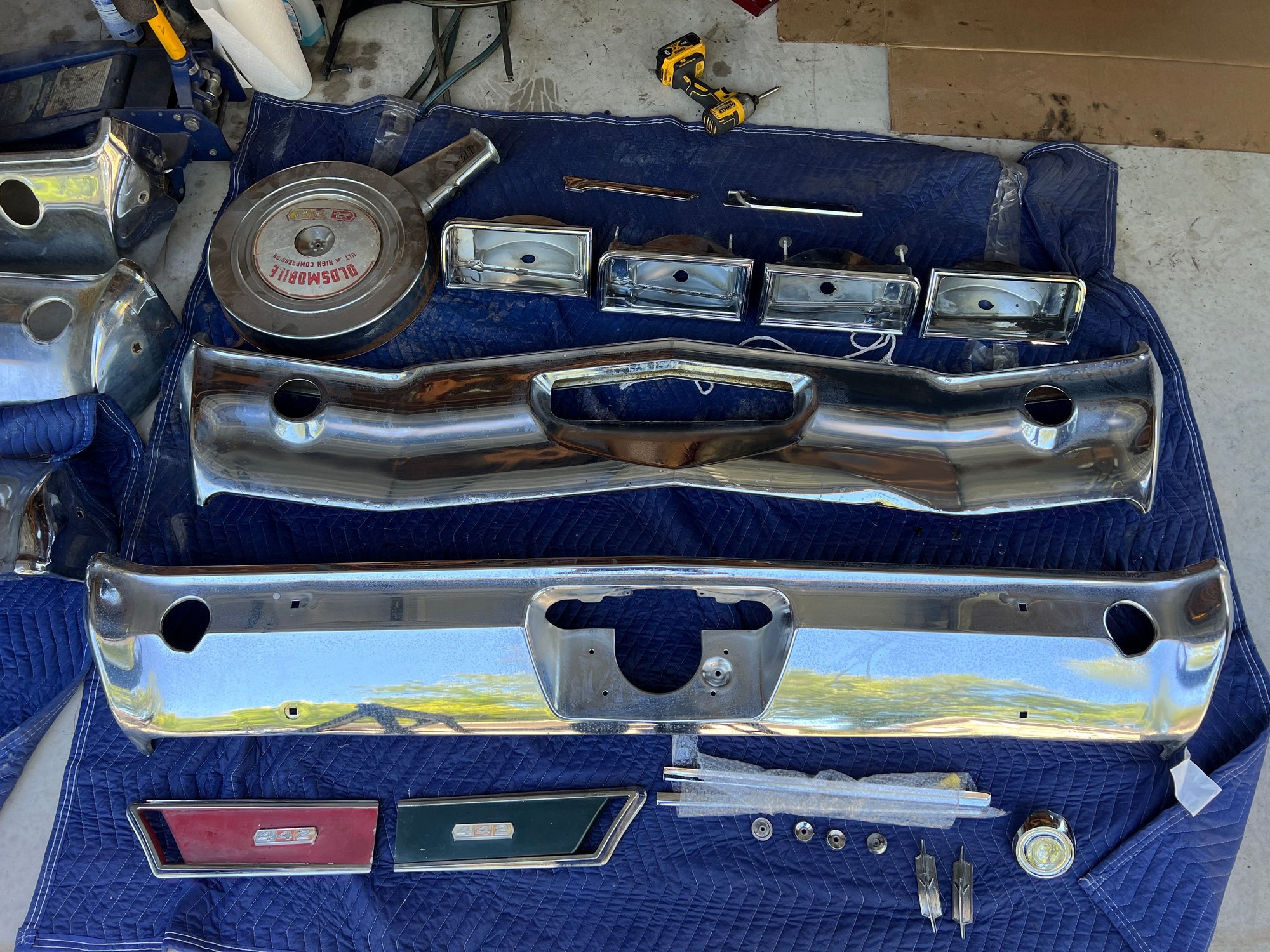

Just dropped off some 65 pieces at a shop that was highly recommended by a friend who has restored many nice cars.
Total was $3285
Deal or no deal?
How much have you guys been paying?
Front & Rear bumper. 1400
Hood trim 225
4 tail light buckets 900
2 real tail panel bars(club coupe) 220
2 tail light bars. 150
1 tail panel rocket emblem
4 headlight & Wiper ferrules 40
2 442 side scoops 320
1 reverse light delete plate 40
(I did not leave him the air cleaner in photo)

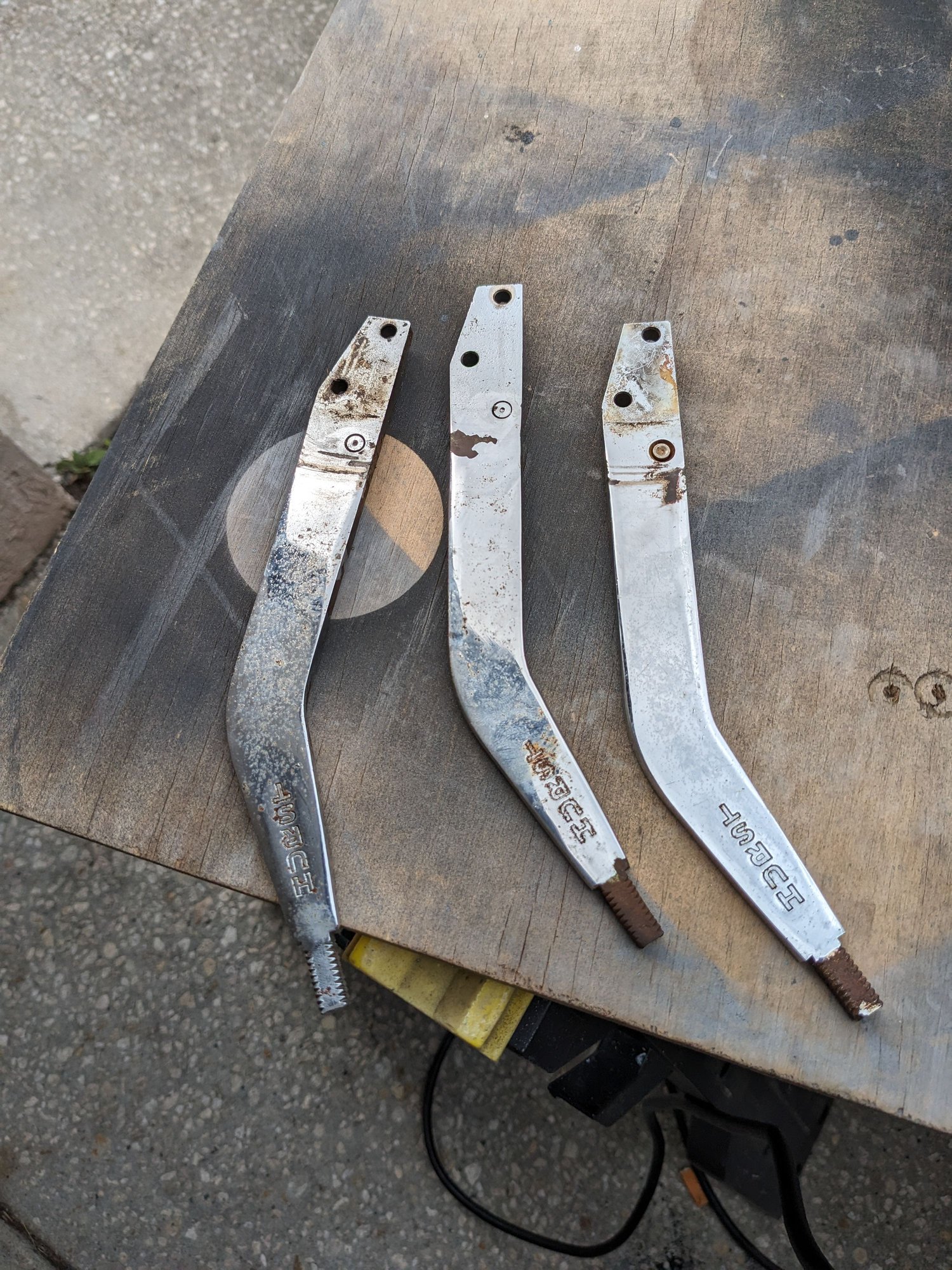

I just had Space Coast plating do 7 Dual Gate handles for me. 1 week turn around. $560 with shipping. They are about an hour drive from me.
They did an excellent job.
Before
After
