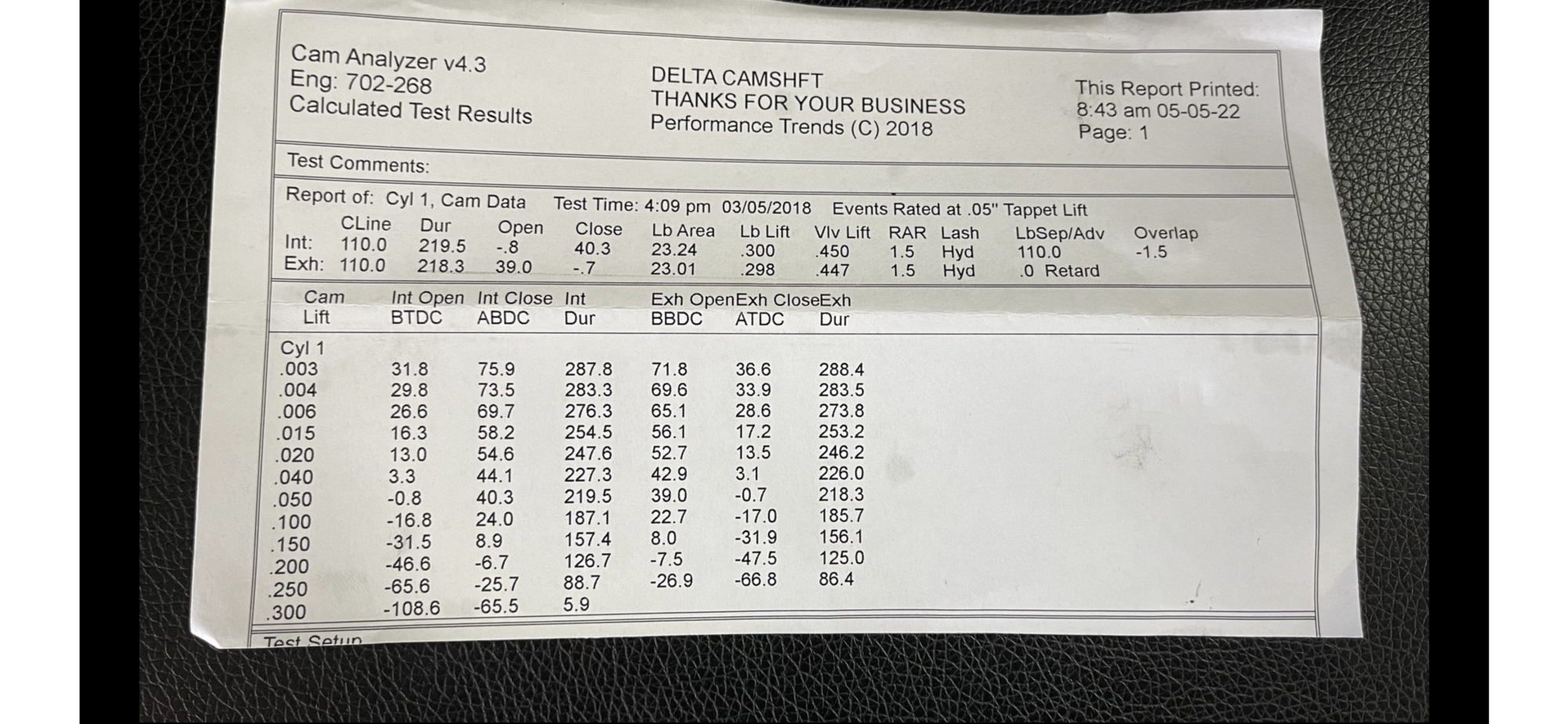

You haven’t provided any details on how you intend to use the car - street only? Strip? I think your intended use can play a significant role in our suggestions/recommendations.
No negative comments from me regarding a properly tuned Q-jet. Ran one on a big block for 30 years with few complaints. I’m currently running a Demon (Holley) 750 Street Demon on a mildly modified street 400. Great carb. Good starting, idling, economy and performance.
Old Jan 2, 2023 | 11:30 AM
65droptop's Avatar
Posts: 421
From: florence,ky
street use only. Doing a full frame off resto, I don’t plan on racing, but I want optimal performance when I do decide to get into it. Original 400 engine bored .030, mild cam a tad above stock, edelbrock performer intake, 4 speed, 3:36 gear, haven’t decided on stock ignition or electronic conversion to keep stock appearance.
Old Jan 2, 2023 | 11:36 AM
Posts: 16,712
Originally Posted by 65droptop
... mild cam a tad above stock ...
This can mean a lot of things. Got specs?
Old Jan 3, 2023 | 09:56 AM
acavagnaro's Avatar
Joined: Aug 2014
Posts: 840
From: Western North Carolina
My 400(G) has many of the same mods. The street demon sits on a Performer intake with no adaptor necessary. One of the nicest things about the street demon is the (optional) phenolic body which helps to reduce heat transfer to keep the fuel cooler. I've had mine for ~5years now and no complaints whatsoever.
Old Jan 3, 2023 | 11:47 AM
65droptop's Avatar
Posts: 421
From: florence,ky
Thought I added this yesterday but I guess not.
