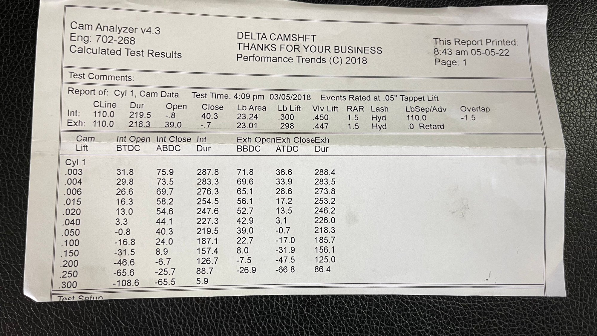

Here is the spec sheet for the cam

That looks like a pretty good cam for your build. Interesting that it's very close to (but not quite) a single pattern according to the net figures. A little more rump-rump, but calm enough to be compatible with your factory intake if you want.
