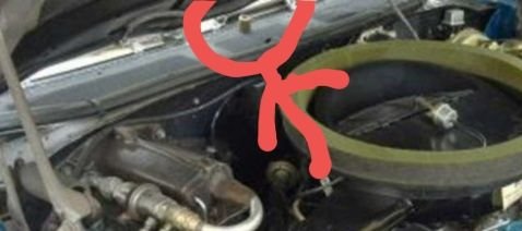

I can't find the clip/ bracket for the center cowl hood support.
Does anyone have a picture of one?
Or even the part I can just buy.
I'm sure I probably have it buy haven't seen it in a long time. Seeing what it looks like might help me find it faster.
Or if you have an extra I'll just buy it and not have to look anymore.
Picture is of the bumper but need the clip that holds this.
This is the bumper.

I thought that was attached with the screw thru the center
Why would you need a "bracket"??
yeah but it screws into a spring type clip I believe

My 1971 with OAI also has 3 hood adjusters across the top of the radiator support
center one goes into the hood latch
Cowl side
not the radiator support side.
this one

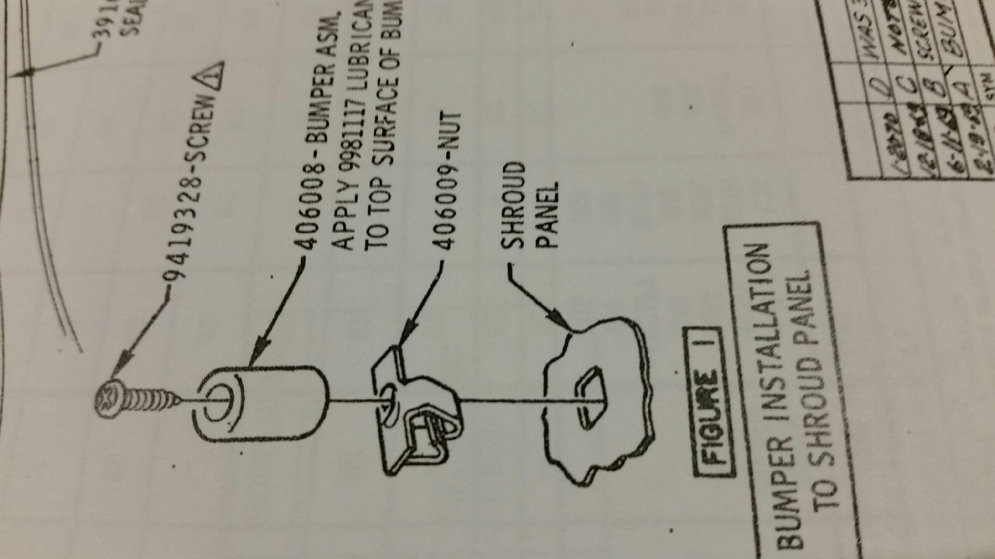

Are you looking for what the Assembly Manual calls the "Nut?"
YES! That's exactly what I'm looking for.

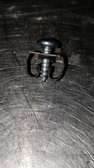

It's been pouring down rain here the past couple days so I'll get by the place when the rain stops. There are plenty of cars that have these and the only question is the condition of the clip. They are very thin metal and rust away somewhat easily but there's a car that came in about a month or two ago with some exceptionally clean parts on it so maybe it has a nice one. I had the rubber hood bumper in my hand the last time I was there since I bought the cowl screen off the car. I'll get there and soon as the guy is holding some other parts that I'm going to buy.
Old Jan 27, 2020 | 11:51 AM
70Post's Avatar
Joined: May 2008
Posts: 3,626
From: Austin, Texas
Found these - One is real nice and the other has part of one of the tabs missing - would still likely function but the design appears to possibly be where the screw contacts both of these tabs which MAY act to keep the screw in there tighter. The "flat" upper part of this clip is the threaded "nut" part of these.
PM if you are still looking.
Thanks yes I do.
Messaged you!.
thank you
