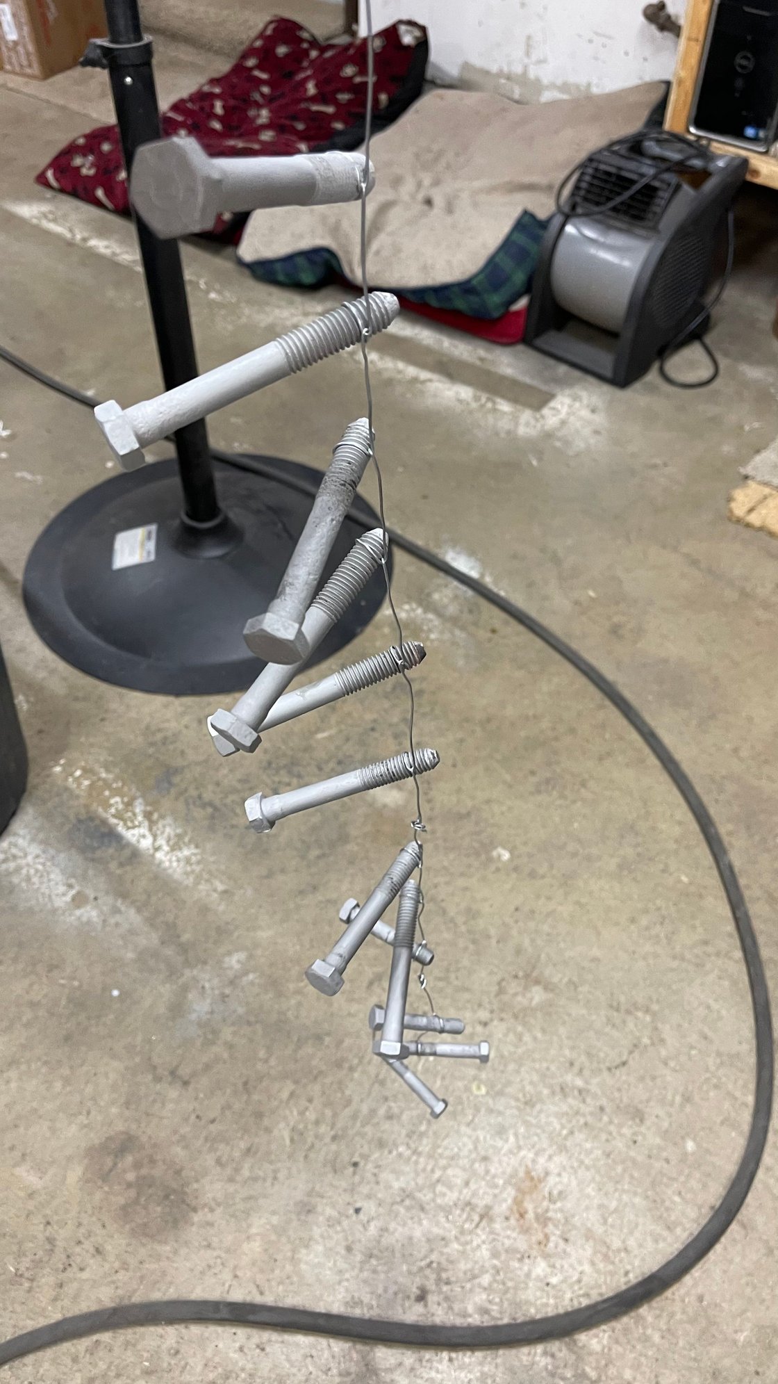

thanks guys. all of the bolts have been sand blasted and are bare, ready for recoating. i will just paint them, starting with an etching primer, followed by some cast iron paint. i like the baking idea, i will keep that in mind as i prep and prepare. i have been hanging the parts out in the hot sun for a couple of hours but the oven will be much better. i have some metal mesh that i was going to use, that way majority of the bolt will be exposed. thanks for the assist
Old Jun 21, 2022 | 02:41 PM
65droptop's Avatar
Posts: 421
From: florence,ky
Came up with decent idea for coating bolts, use some tie wire and wrap it around, easy to hang, and you can hit all areas with paint. Plus, I can hang the wire from the rack in the oven so they’re not touching anything. I’m going to do the same with my washers and nuts.

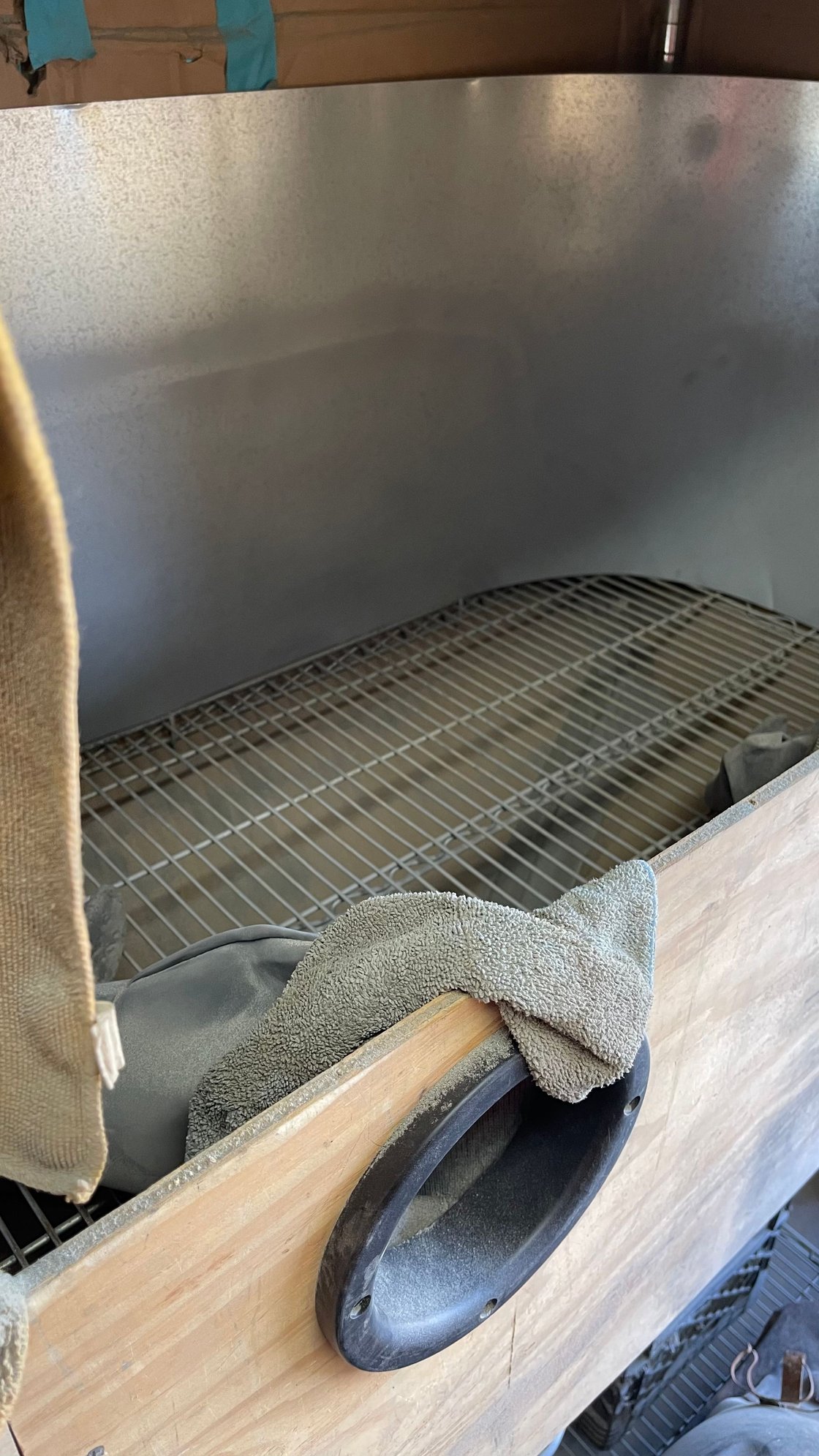

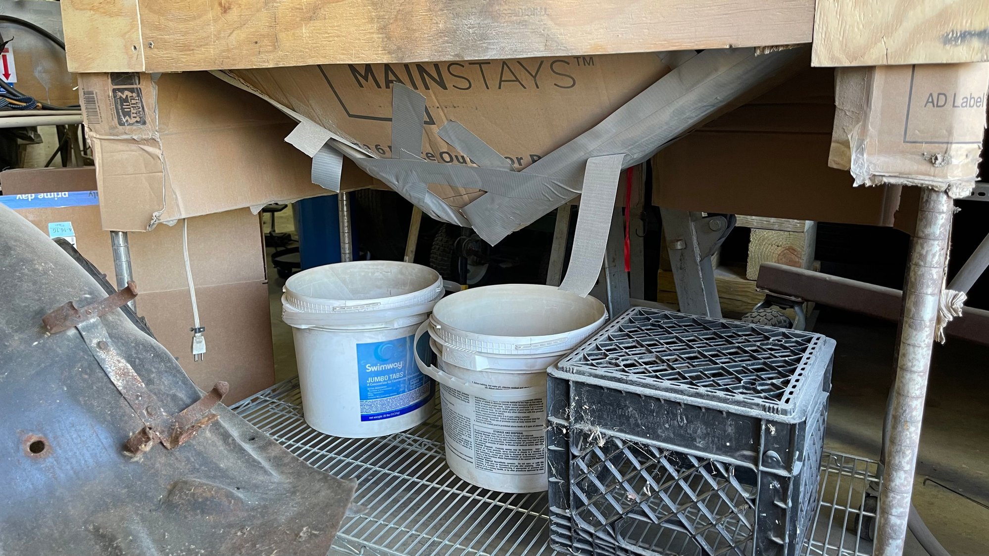

When you don’t have the space to really store a blasting cabinet, when you’re not using it, you make a temporary one out of stuff you have in the shed. Lol only expense was the replaceable plastic for the window, and the right gloves, the rest is card board, plexiglass and some scrap plywood. The wire shelves have been around for over 20 years and have been used for many things. Lol
Love the ingenuity!
