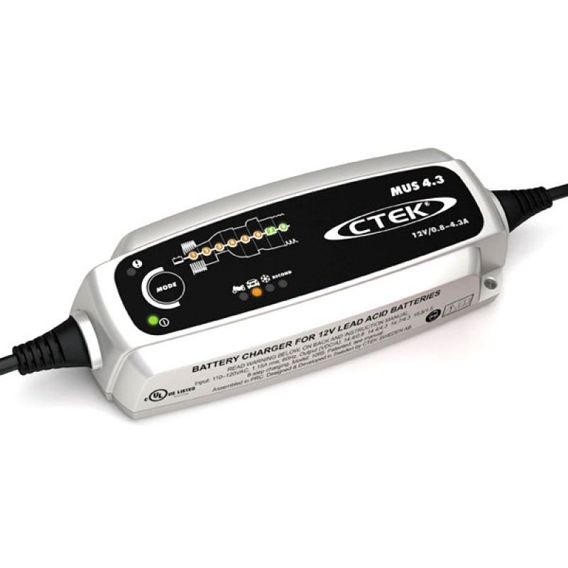

I' ve had good luck with Ctek

I'm now using 3 of the CTEK chargers on cars and equipment. Never heard of any problems with that brand. But they aren't $6.00 Harbor Freight junk.
