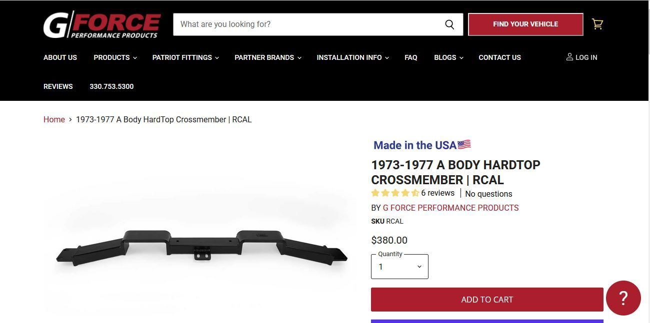

G-Force. Made in the USA! Check Summit/Jegs they may have it cheaper.
https://www.crossmembers.com/product...ember-hardtops

I asked, because a 400.00 new crossmember is out of the question, and I'd like to do the rework of the crossmember before I try to install the exhaust. I am working on jack stands and in driveway. It can't sit on the stands for days while I try to install the pipe off the manifold and then take the crossmember out and have it welded/cut.
I want to pull the crossmember, have it reworked. then install it back in place. So I can do the stock 1973-4 exhaust on a week end.
