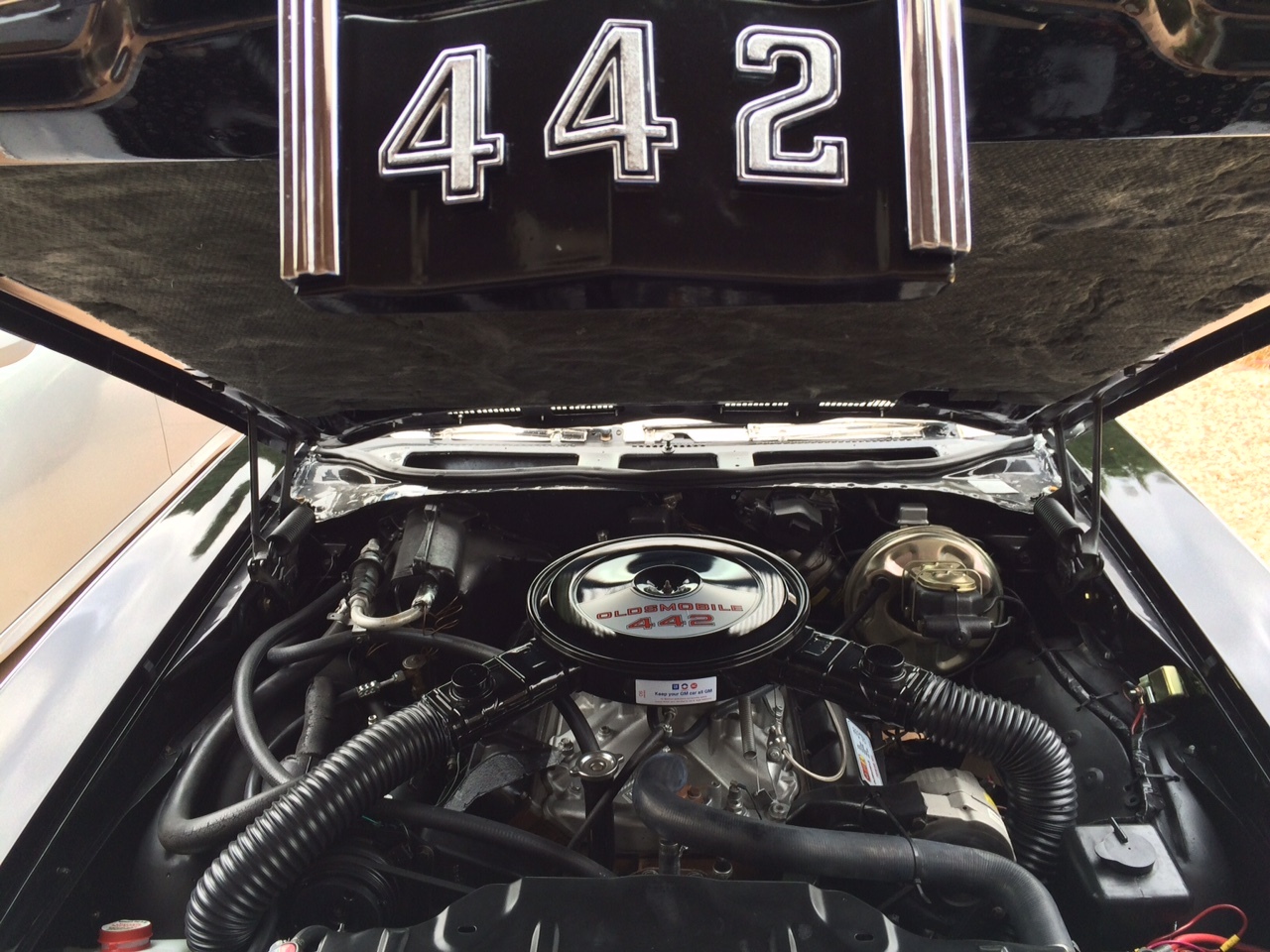

Yet another (or is it again?) 1969 "W-32" with A/C...
Note that the ad never actually calls this a W-32 car, only that it has "W-32 options". Of course, it has incorrect intake, stripes, hoses, wheels, electric fans, etc, etc. For that matter, note the voltage regulator on the firewall.
But wait - he has "documentation that can be looked up from the VIN". Oh, well then.
http://www.ebay.com/itm/Oldsmobile-4...m=141819467449

Few weeks back, I mentioned to a Chevrolet bud that muscle-era Chevy-world was full of unscrupulous people. Looks like it's filtering over into Olds/Buick now.

This is about to make my head explode.....WHY can't people drill the holes for the 4 4 2 with the CORRECT spacing?!?!?!? ANYWHERE on the car?!?!?

Where do you start with this fright pig?

No kidding. I missed the washer tank location also. The O.A.I. hose routing is about as convoluted as can be. The car allegedly has a 34467 VIN but there are too many issues to take that at face value. Of course, it's had a total body-off, so who knows what they started with.
Especially considering that the hood tooth has the bosses for the holes on the backside...
Actually, I think the first "4" is a fender emblem, not a hood emblem.

I really like the rare 69 W- 27 rear end cover

Its not just the 442 spacing that is appalling, the routing of heater hoses is nothing sort of an abomination. I think one of the first things these "restorers/creators" is to throw away the special bracket at the A/C compressor that routes the hose to the water pump. Why do they have to route the hoses all over the engine compartment and then call it a beautiful restoration?

Dig those crazy trunk stripes! Also, if it's supposed to be a W-32, why do the call-outs say W-30?

Side question, and I think Joe and I talked about it once before, but I've got a question on non-hood vented OAI and A/C, like on this car. Most of the bumper scoop OAI cars could not have A/C, so no problem by default, but the 68 H/O and apparently the 69 W-32 could. The right side OAI hose on this car looks like a AC 68 HO I saw a year ago, and the hose just goes over the back of the compressor and kind of squishes.
I'm eventually hanging a stock OAI setup on my 67 and wondering how to run the OAI hose in regards to the compressor.

OAI snouts are from ????
EGR intake?
rubber fuel line, single clamped, typically w/o even a retention bulge.
Hex nut holding air cleaner lid on
Taiwan oil indicator
battery + cable run along frame; battery - bolted to motor mt hole
too much hassle to hook up the windshield washer pump?
weird spacers at wp LH side, on ps bracket?
kickdown cable hooked to carb?
no cowl screen
heater hose hooked to front of intake, really?
weird steering wheel
1968 lighter ****?
442, "W-30" emblems, should not? have "Oldsmobile" on hood?
Shifter and PRNDL is a mess.
carb pcv fitting used for power brakes?
no hot air to air cleaner; Thermacs not even attached.
filter on INLET low pressure side of fuel pump- iggernut injuneering
This is a good from 1000' car. Needs a lot of details fixed just to be semi-rectal.

Did nobody notice the zip ties?
Old Nov 10, 2015 | 06:40 AM
The whole point of the title of this thread is that a 1969 W-32 with A/C is a "one of none" car. A/C was not offered on any O.A.I. A-body for the 1969 model year (except the 69 H/O, which did not use the bumper scoops and hoses, obviously). The 1968 H/O was the only O.A.I. car with bumper scoops and hosed to be offered with A/C, and the passenger side hose routing around the compressor is very tight on those cars. Here's a 68 H/O with factory A/C.
