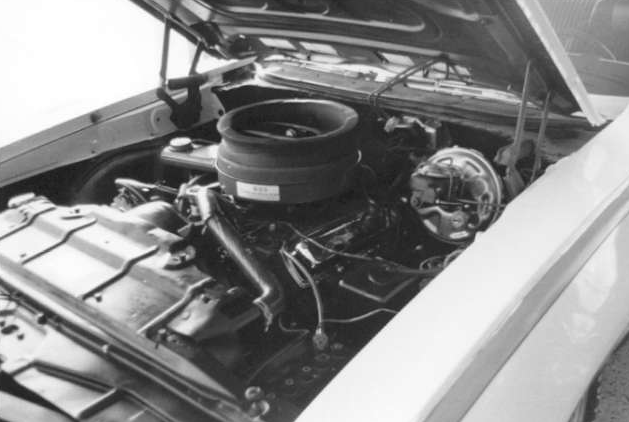

Not exactly the same as a typical 442 air cleaner, but I can't see them doing it much differently with single snorkel air cleaners regardless of the car. 69 H/O in the showroom. This one is about 5 o'clock-ish.

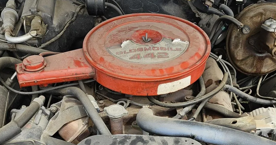

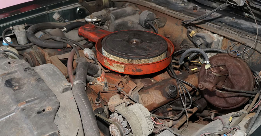

Never say never, but I'd say this old barn find is highly likely to be factory-applied at the 5 o'clock-ish position as well. Even has the open-faced alternator.

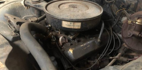

This one appears to be an original air cleaner. Not sure about anything else. But it looks like another 5 o'clock somewhere deal.
And...just to add to it, an original-appearing 69 Cutlass 350 with its label still seemingly intact about 4:30-ish.

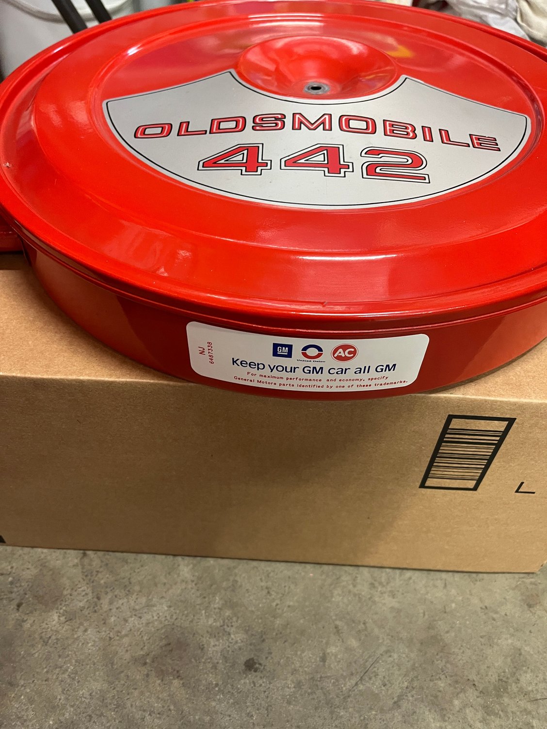

Your current decal is the "generic" repop that a lot of sellers use for air cleaners with the wrong part number and NJ code. Yours should be "OS" code with part number 6484804.

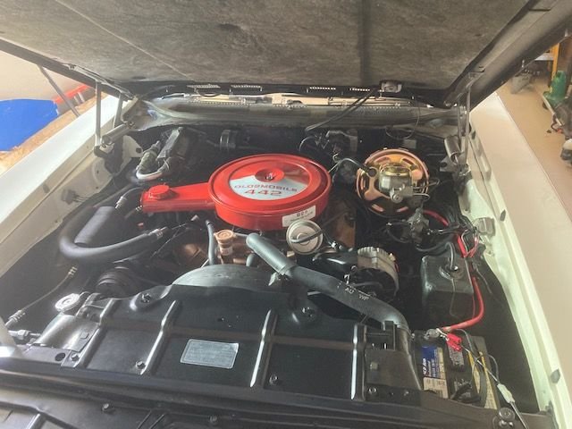

When I restored the air cleaner assembly on my '69 4-4-2 (Fremont car) I measured and determined that the left edge of the original "OS" sticker was 10 3/4" counterclockwise from the nearest edge of the snout, so that's how I placed my new sticker.

My orignal car has a?C and cruise also. Your placement looks very close to where mine is (was, very worn).
