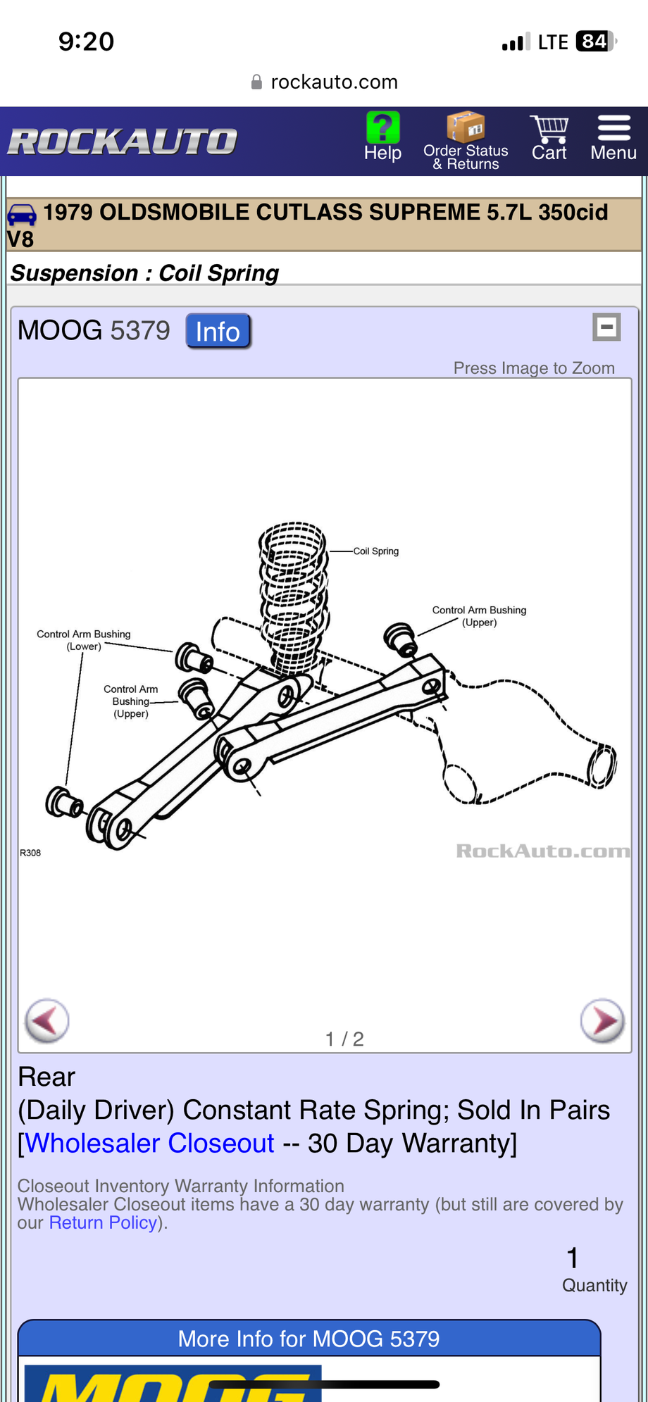

I put these in the rear

I went for the variable rate springs Moog CC627

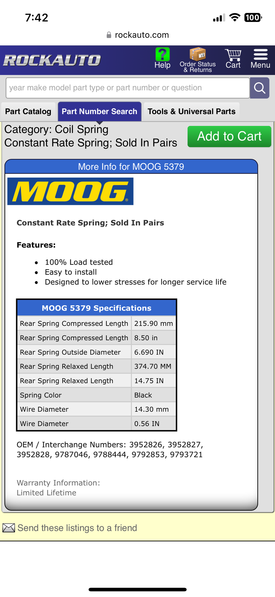

Looks like the moog cc627 would give me extra almost 2 inch
from the ones I have 5379
but the 627 is a bit smaller length relaxed
maybe I’ll try that instead
