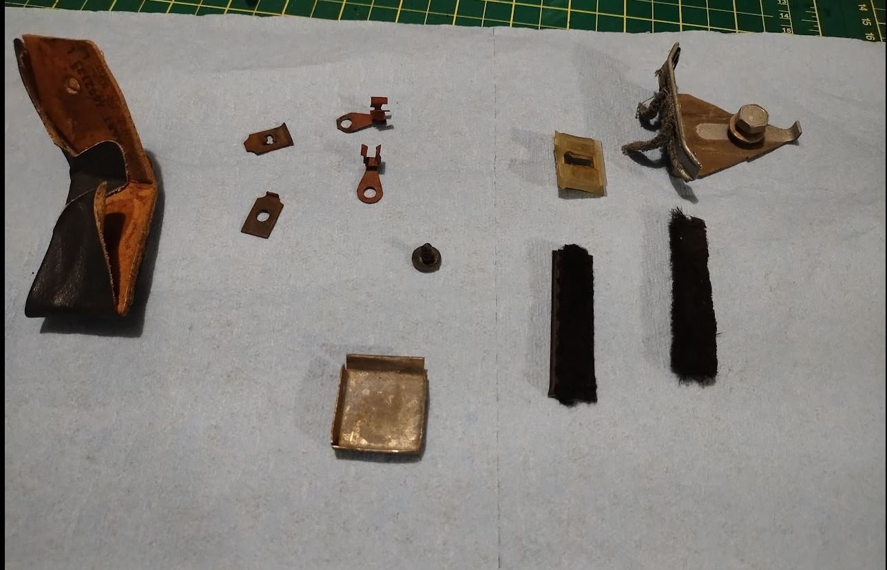

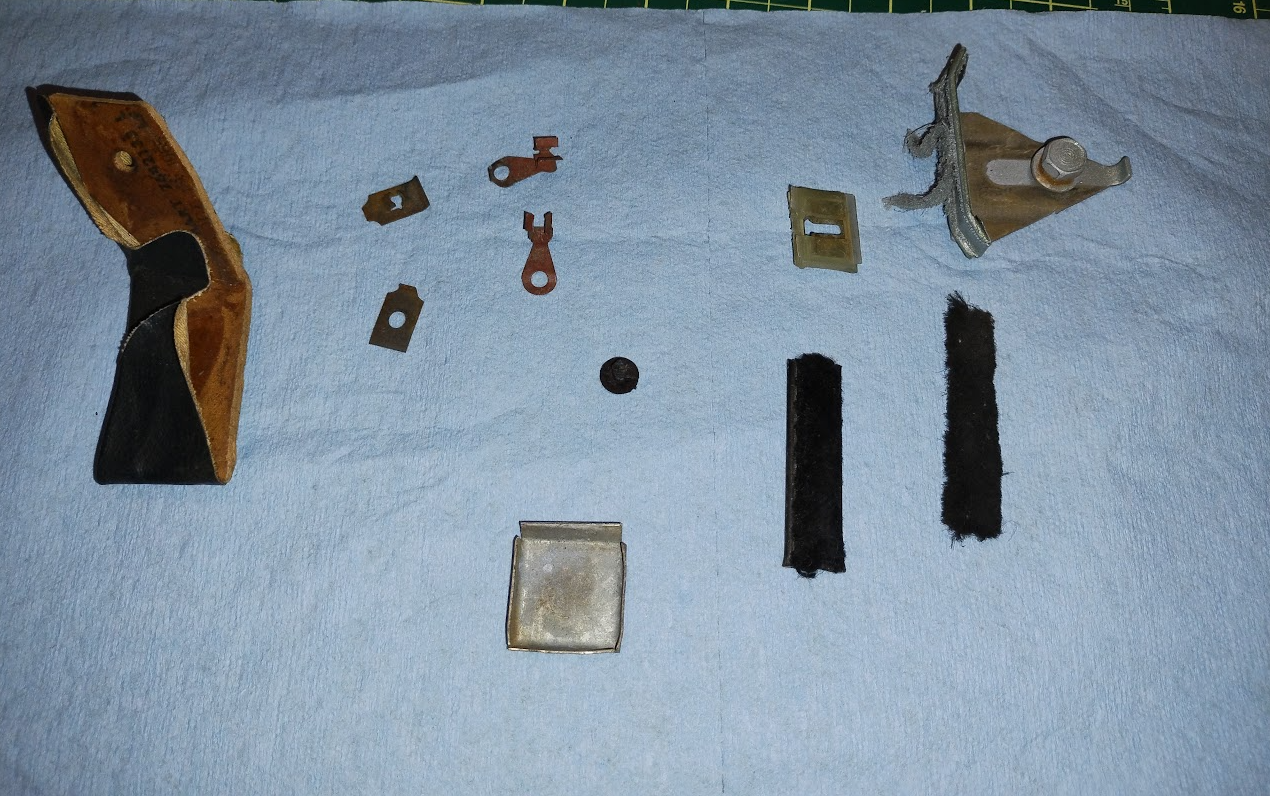

Wrestling with worn and dirty parts makes adjusting harder. I ran the adjustment screws & nuts through a 1/4-20 tap & die to clean up the threads. I ran the screws down just far enough to clean up the previous-setting ranges. I left some surface rust on the parts since I wanted a reminder of where they were previously set for in/out positioning. Check out and replace any plastic riveted rollers that look bad, or grease up your good ones. If you put in new rollers, take care to place them in the right direction. I wasted a few rivets by drilling out the old ones and getting the direction wrong. You may want to replace the front window fuzzy. The vent window needs to come out to get the front fuzzy placed correctly. You may want to completely remove the rear channel and replace the mohair channel fuzzy fabric. I redid mine with 2” wide fuzzy velcro glued in place. I think I have another post on that using 3m Adhesive Remover. Grease all the tracks with Silicone Grease per Joe P’s advice. If you pull the regulator and motor to replace some rollers don’t be surprise to find some play in the regulator after 50 years.If you get this deep in, vacuum or blow out the bottom of the door and grease up your door lock parts too.
Glass Bolt Sandwich & Channel adjustment screws
The top short bolt sandwiches the glass between some insulating plastic and the rubber washer see here. Don’t tighten beyond 5 ft-lbs. You can center the bolts in their holds outside the car as a starting point, slip the window in place (without the front and rear limiters) and snug them up where you like as part of the process.
Typical GM Mid-60's window hardware

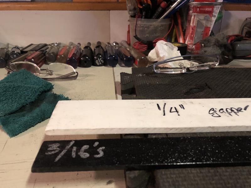

I used a 3/16's thick piece of plastic to nudge the seal channel outwards while I snugged down the screws that hold it in place. The gapper looks like this and I sorted of shoved the 3/16's edge up between the channel and the windshield to push outward:
To create a consistent gap, use a consistent thickness edge. Black is a 3/16" gap stick, white is 1/4".
The tricky part of the vent windows is to get them tight enough to be quiet, but loose enough so they don't impede door closing. On top of that you're looking for what I call a consistent "seal crush" or "seal pressure" all along the seam between the vent frame and rubber seal.

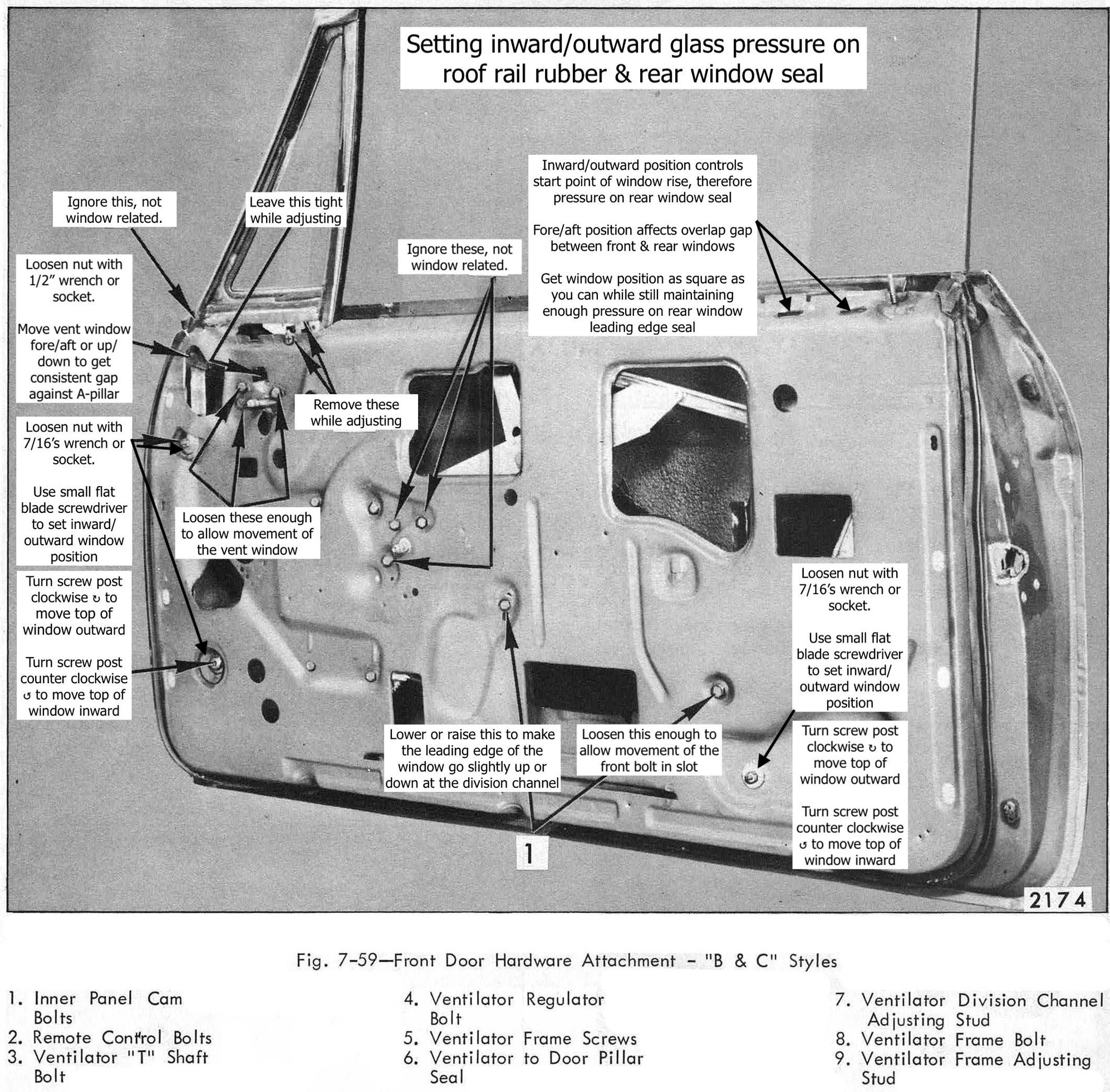

Here's a GM photo annotated with the names of the big car (88, 98, Starfire) major door parts, I've added a few labels GM put in other photos just to have it all in 1 place:
Typical GM B and C body 2 door front door hardware. Applies to 65-70 hardtops and convertibles alike.
This time I started with the Ventilator Frame Bolt. It's just about the only hardware on the door that doesn't need a 7/16's. It needs a 1/2" socket. The bolt screws into diecast chrome, so my driver's side was stripped out. Lucky there is room behind for a nut & washer.
Philosophically I've arrived at the idea that if you've pulled a bunch of parts out of the door and defaults are out the window, a good place to start is with most hardware set in the middle of it's travel. Generally I worked from each fastener's middle setting in the direction I wanted to influence trying to avoid extremes. My thinking is that if extremes are needed it's probably a mistake in somewhere else.
To move the vent window around, you may need to remove the Ventilator Frame Screws. Mine weren't all there, so it wasn't a problem for me, but it's part of the design and it's kind of hidden, so they're tricky. The one on the outside of the vent window is well hidden. It also holds the stainless steel outer trim tight to the top of the door. Once those screws are out, you can work with the Ventilator Frame Bolt, Ventilator Frame Adjusting Stud and Division Channel Adjusting stud.
I got the bolt located forward enough to snug up against the new seal and a little more than finger tight. Then I started playing around with front ventilator adjusting stud looking for a consistent crush or consistent parallel line between the vent window and windshield. I finished up with division channel stud. The division channel is tricky since it controls in/out pressure of the top of the vent window as well as the fore/aft channel for the driver door glass to travel in. Too far forward and the glass can drop out of the channel.
The in/out adjustment of the vent window studs isn't bad since the vent window top sets a baseline for how much seal pressure the door window will have against the roof rail. This is a good time to say their motion is inverse -- tightening the screw pulls the bottom of the vent in; hence it pulls the top of the vent out from the seals. I.e. to make the seal tigher up top, you want to loosen the adjustment screw. I hope that makes sense. The same principle applies later to the Run Channel adjusting stud and to the rear quarter lower studs too, so it's a good one to get straight.
I redid a couple of window roller rivets along the way, so I had to pull the window motor. Just a quick aside to say there's not much to get wrong with pulling the motor. 3 out of 4 bolts have no adjustment at all so just snug it up and you're ready to go. That and the Remote Control (aka door paddle) Bolts are probably the easiest things in the doors.
Once I got a consistent crush and gap on the vent window frame, I moved on the the rear quarter windows with intent to return to the driver and passenger door glass as the final step since they have a lot of range of adjustment. See the next post for rear quarter windows.

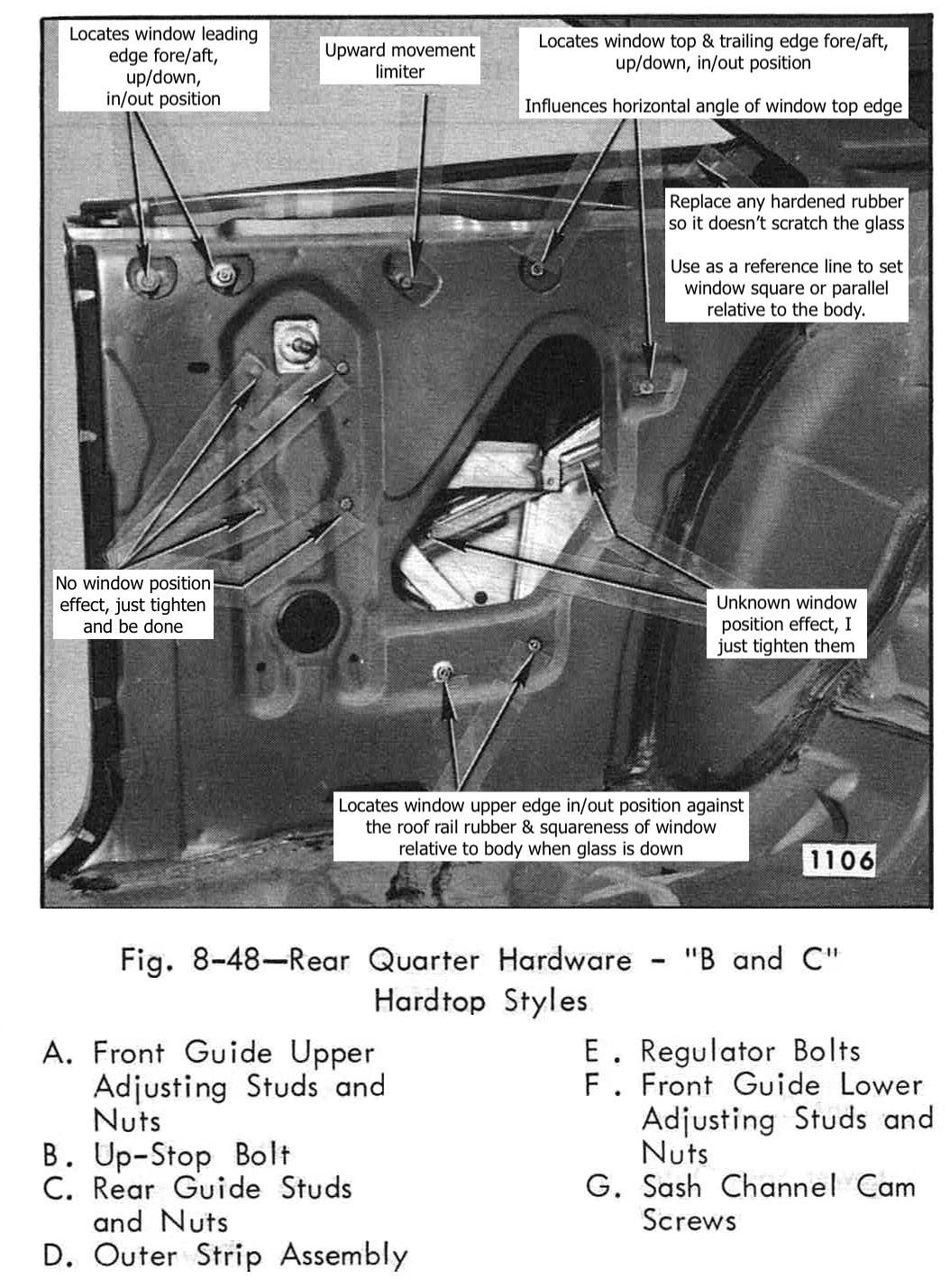

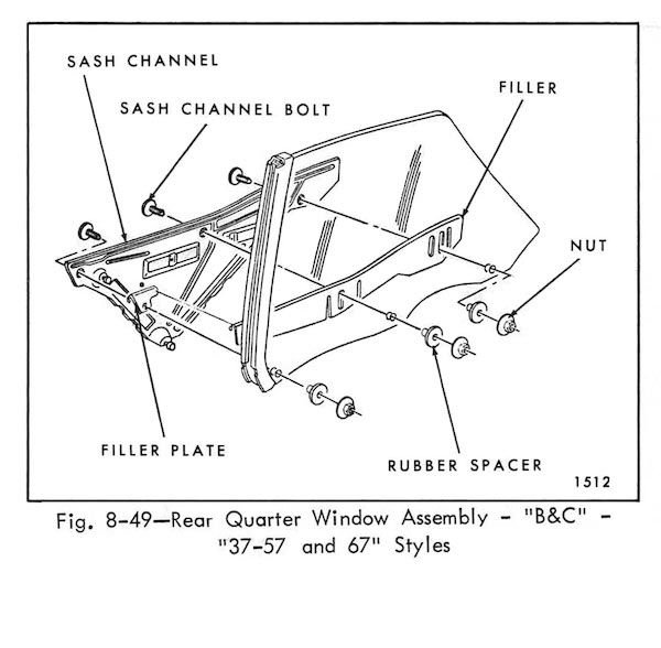

Once the convertible top had been readjusted, that more or less required the rear quarter windows to be readjusted to fit snugly. Since the quarters can't move, but the top can, it seemed smart to adjust the top before the quarter windows, since the windows needed to fit tightly into a top that was placed correctly.
I have a little tweak on mine courtesy of a 2016 mistake I made overtorquing window bolts. My '66 Olds 98 has a '66 Buick Electra 225 left rear quarter window whose lower contour is not quite right. The upper edge of the Buick body panels was different, so my window's lower edge is a bit off. Lesson being, if you do remove glass, don't overtorque those bolts on reinstallation. My wife calls me the "overtorquer"
Look out for these three nuts on each window:
Mid 60's GM Big Car windows are usually secured by 3 7/16" nuts. Don't overtorque them.

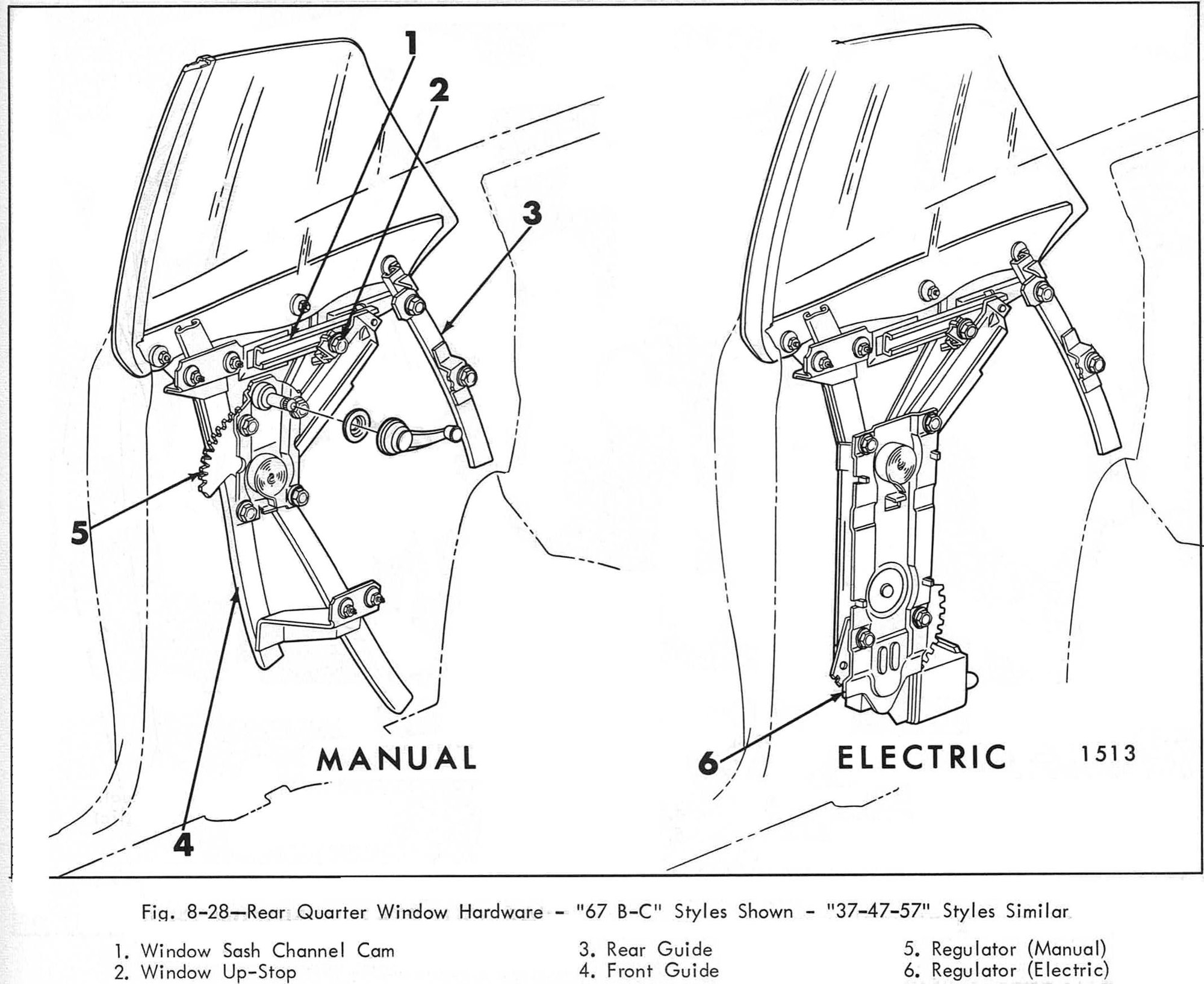

Here are a photo showing the control hardware and a diagram showing the '66 big car rear window mechanisms. What's here should apply to mid-60's 88's, 98s and Starfire 2 door cars as well as many other GM B & C bodies of the era.
GM big car rear window hardware, common to most B & C body convertibles and hardtops from '65-70.
Regulator Diagram:
Typical GM 65-70 B &C (Big Car) Rear Quarter window regulator hardware.
The (A) Front Guide Upper Adjusting Studs & Nuts place the window's position in/out (laterally) and fore/aft in the up position. This is critical since it's the interface to the front door window. You'll see that you can move them forward, back and a little up & down. Neither of my cars have any of these studs below the top vertical slot. Regarding fore/aft movement: there needs to be enough of seal overlap between the front window and the rear window to keep out wind & water, but not have it so tight that they interfere with one another. On top of that the angle of the rear window needs to be inward enough at the top so that the leading edge seal stays on the inside of the door window. Tall order.
Long run, you'll be thinking about the rear window will fit against the front. Raise the front window all the way up to keep an eye on how the two windows look against each other - both fore/aft and in/out. This should reduce the time you spend trying settings -- it will look wrong if it is wrong. Front/rear window interface problems include interference, no window gap, too big of a gap, rear window outboard of front, front window not sealing to rear and inconsistent (not parallel) window gap front/rear.
Here again I started at the "A" position to get the leading upper corner right first. I left the F Front Guide Lower Adjusting Studs & Nuts finger tight during this process again setting them at more or less the middle of their slot and, but snugged a bit inboard of middle to create a good in/out seal against the front door windows.
I set the "C" Rear Guide Studs & Nuts last and more or less left them loose and judged their position by how smoothly the window went up. The other thing I paid attention to here was the in/out settings on the screws to try and get the window to move smoothly and have it be more or less straight front to rear like the rubber it was rolling up into. I don't think I really understand the rear guide well, but it's not really in my way either.
Like the front windows, don't worry about pulling the window motors. Going back in, they bolt right up in no time at all thanks to item E above, Regulator Bolts. Pulling the motor allows you to redo your loose or broken window roller rivets. If your window roller rivets are loose, see my post on redoing them. It's not hard. Once you're this deep in, you might as well replace any rivets that rattle or don't roll smoothly.
Returning to the F Front Guide Lower Adjusting Studs, these have a heavy influence on how the top of the rear window crushes into the roof rail rubber. Loosening these screws creates more inward motion of the top of the window, tightening the screws pulls the top of the window out away from the seal. The hard thing here is you want the top of the rear window lightly compressing the roof line seal, but not so far in that the front window can't seal against the leading edge. And not so far out that the rear rolls up proud (outside) of the front window. Getting to that took time for me.
I decided to place the top, and roof rail rubber before the windows, to set a goal for the windows and their seal crush. You could do it the other way since both parts are slotted i.e. adjustable.
Where I see slots in GM products, I see adjustability. Be ready for tons of trial & error & time here. Walk away if you need to. It's frustrating - each movement affects the others somehow and it's not documented as far as I can find.
After the A & F parts are close and the C parts aren't restraining anything, you'll start to look at the trailing edge of the rear window. The game here is kind of like the vent windows, get a consistent gap and crush against the rear roof rail rubber. But you've just spent hours locking on the positions of all those studs and bolts! Don't worry, you can loosen the glass against the sash channel as shown in the first diagram to adjust the rear angle just right. I may have this out of order, but moving the actually glass forward, back, up, down or angled against the sash is one of my final moves. There ain't much adjustment, maybe 1/8" but it can get you to good gaps & crush.
Where I wound up was good seal crush, fairly parallel gap between front and rear windows, tight rear window seal against the top and smooth window up/down movement. I failed on in/out the rears are a bit too far out at the top. So I have to put the rears up first, then the fronts up after them, or the rears roll up outside the fronts. Small price to pay because the up side is both windows pressing inward for a tight wind & water seal .

I was adjusting my ‘66 Starfire hardtop windows and wanted to note something useful. Knowledge would apply to all Mid-60’s GM’s until they took away the vent windows. I’ve scratched a bunch of main windows getting them in & out, so I was trying to put in a new front fuzzy channel without removing the main window. Turns out this is possible.
If it’s just the vent window you need to adjust, or replace the vent window rubber, or replace the front fuzzy channel, you can remove the Ventipane assembly _without_ removing the main drivers or passenger window by removing 7 bolts.
For several years my passenger side front windows have made more noise than I’d like. I knew the roof rail rubber was incorrectly squished since the vent window was slightly out of place. Task of the day was putting in new rubber and adjusting the window to squish into it as designed rather than bend the rubber out of shape and make wind noise. Along the way I found a stripped 5/16”’s 18 bolt at the front right corner, roller rivets just about to break, and a not-quite-broken window switch pigtail. It turned out a new fuzzy channel was in order too since the old one was worn out. Nice to get a bunch of stuff done when you get in there.
I removed and replaced my vent window with the passenger window most of the way up so that the window was spring loaded and mostly secured by the rollers and rear fuzzy channel. It’s a bit tricky getting the vent window assembly back in. I routed the vacuum power door lock hoses and power window wires in front of the vent and then slid the new-fuzzy over the passenger main window and down. I had to move the window up and down a bit to slip vent assembly in, but it worked.
A minor victory, but this may have occurred to some of you as our window fuzzies and vent window rubber wears out, but you don’t want to deal with completely disassembling the door.
Oh — taking it apart is about 15 minutes starting with the door panel. Getting it back together was probably 5-6 hours with detours along the way for the wiring, replacement bolt, new fuzzy channel, and adjustments. Windows take _forever_ to get even close to right.

This thread is excellent and it reminded me of something, maybe you could help me out CFair? A few years ago our '66 Toronado had an accident where someone backed into the drivers side door. The whole door was replaced with a donor from an old '66 and was done by a local shop. Anyway, they didn't do a great job on the replacement. It looks good but unfortunately the window doesn't quite operate correctly (it doesn't go all the way up and has difficulty getting started to bring it back down). I've been debating trying to repair it myself but I'm not too confident especially considering the next part of the story.
The reapir shop, after the job was completed,handed my Dad (who owned the car at the time) a little box of leftover parts from the door swap I have no idea what these parts are for. I have some pictures below, if anyone can identify what they are it would be much appriciated. Honestly, Dad should not have accepted the work in this state but there's nothing I can do about that now. The car is long removed from that location.
Leftover door swap parts

First up, my experience is with B&C body cars which are different from Toronados. I’ve never worked on Toros and the lack of vent windows make ‘em different from the big cars, but the principles above probably apply.
The upper left part looks like a trim piece. It’s unfamiliar to me. If it’s not bent, look around for what’s missing. Since it seems to be covered in vinyl, I’d guess it’s an upper door cover of some kind, designed to be seen. Maybe it’s a bolt cover or something. GM put trim like that in sometimes strange places. The wrapped vinyl means it was meant to be seen. It can be resecured/reglued with 3M interior spray glue.
The 2 little parts next to it were once a U shaped speed nut to retain trim. I’ll be they fit together, but are broken, yet easily replaced. Look around at your local hardware store for “J” speed nuts or “U” speed nuts. The fact that they’re not in the car just means something might rattle a little. Usually the U shaped nuts wrapped around a piece of door/body steel to make a pre drilled hole in just a little smaller to allow screws that hold door panels in nice & tight.
The two spring steel clips in the middle are designed to hold the door paddle rod fast to the door paddle and on the other end to the door lock mechanism. They keep the door lock rod from rattling and secure the rod where it’s supposed to be. The way the door lock rods are shaped, they won’t fall out (great design), but without these clips the rod(s) might rattle a bit when there is no spring tension on the rod from an opening process. If you hear a rattle when closing the door or when opening from inside, these missing clips will stop that. Not having them on the car isn’t a mechanical problem, it’s really more convenience so the car doesn’t rattle when it’s not supposed to.
To put ‘em back in, if they’re missing slip the round end loose around each end of the rod, then put the rod into the door lock and the door paddle, then use the opposite end to clip onto the rod on the other side of the door lock and door paddle. When it’s right the rod should be snug on its connections, but rotate freely. You’d do well to set this up on the bench to clean the lock and see how it all goes together, then slip the assembly back into the door as a unit. I usually do the door lock first, with the 3 screws, letting the door paddle hang a bit free until I’m ready to put the paddle back in with it’s 3 bolts.
The round piece below the door clips is unfamiliar to me.
The square steel piece is a broken off bolt protector which used to cover one of the bolts which hold the window motor to the window regulator. Not needed at all. I never knew why Olds bothered with this, except maybe as evidence that someone has messed with the windows or replaced a window motor.
The fuzzy parts go on the top of the door, either on the inside or outside to keep the glass from rubbing on the steel. I don’t know which side (exterior vs. interior), but the first place I’d look would be the outer door skin. I can’t comment on how to secure these fuzzies to the car - might be a screw, or might be a bolt from the back. If it’s a screw from the fuzzy side, make sure you use a countersunk screw so that the glass doesn’t get scratched by the very thing that’s supposed to keep it from being scratched. These parts may be redundant if your replacement door still had ‘em, which is likely, but not certain.
The clear plastic thing above is what’s left of an exterior molding retaining clip. If your exterior door trim is held on correctly and not loose, this is probably unecessary. Anyway it’s broken from what I can see. It’s reasonably likely that the replacement door had a bunch of these on it, so why reuse a busted one?
The last piece on the upper right is some kind of glass limiter stop. The part goes behind the inner door skin in a vertical slot with the “J” end pointing inwards toward the cabin. The threaded bolt goes through the inner door skin to hold the stop somewhere in its travel as determined by the person working on the door.
To adjust the stop, you begin with the limiter at the top of its travel bolted in loosely. then roll the window all the way up. If the window overruns the roof underside, put the stop a little lower until you have the roofrail gasket crush tight enough for your liking and the window going all the way up.
If you go after improving the window operation, do it on a sunny day when you’re not stressed for time and it’s pleasant in the garage. Get the radio going and start with coffee. The adjustment process is a giant time suck and you need to be in the right frame of mind. There are so many adjustments you can drive yourself crazy, but the guide above should help.
If I had the problems you’re describing, I’d begin with the rear channel - if it’s too tight the window motor and spring will have hard time like you describe. If it’s too loose, the window just falls out of the track. When working on this, play with the angle of the rear channel and the in/out turns of the adjusting screws. The angle I’m referring to here is whether the two bolts on top of the door are directly in a line parallel to the top ridge of the door, or maybe it works better if the front or rear bolt is inward/outward of the other one.
Looking at these leftovers, the shop did what they were supposed to do. They didn’t go the extra mile to adjust the window properly, but that’s a massive time suck for which they would have had to charge by the hour as their person learned what to do, unless he already knew. It’s tough to ask a customer to pay for your learning. The hours it takes to get glass right is thankless and would probably p*ss off most customers who don’t know that it’s hard. The fact that they gave your Dad this bag of parts means that they cared more than a little.
Hope this helps - gotta go peel & chop vegetables!
Chris

Chris I can't begin to thank you enough, once again. This is so helpful, I can't even begin to express my grattitude. I was just telling the wife that I'm actually calling this an early Christmas gift! Where else does one get such helpful information? Nowhere! I owe several members on here, especially yourself, a beverage or two!
My Dad will be happy to hear this as well as he has been hard on himself about that door repair.
