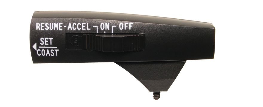

Back in the day they made aftermarket cruise controls. I know you said you don't want one, but hear me out. A very popular one was made by Dana Corporation. It worked by gluing magnets to the drive shaft and mounting a sensor near the magnets. Speed was sensed by the rotation speed of the magnets. You still had to put a servo under the hood, but there was no fiddling with speedometer cables, and there was no putting a switch in the dash or changing out the turn signal stalk. Rather, the controller for the cruise control mounted on top of the turn signal stalk, and you ran the wiring as inconspicuously as possible down the underside of the steering column. I installed two of these back in the day, one in a 1975 Chevy Nova and the other in a '77 Chevy Caprice. Both worked very well and actually gave more features than the factory cruise system because the aftermarket system had "resume" and "accelerate" controls on the controller, something that factory cruise controls, at least GM, wouldn't offer until a number of years later.
The controller that mounted on the turn signal stalk looked like this.
My point is that putting one of these on your car, if you could find one, would be about as period-correct as having a factory system. It would have been very correct for that era to see one of these installed on a car, and you'd save yourself lots of headaches in the installation process.
