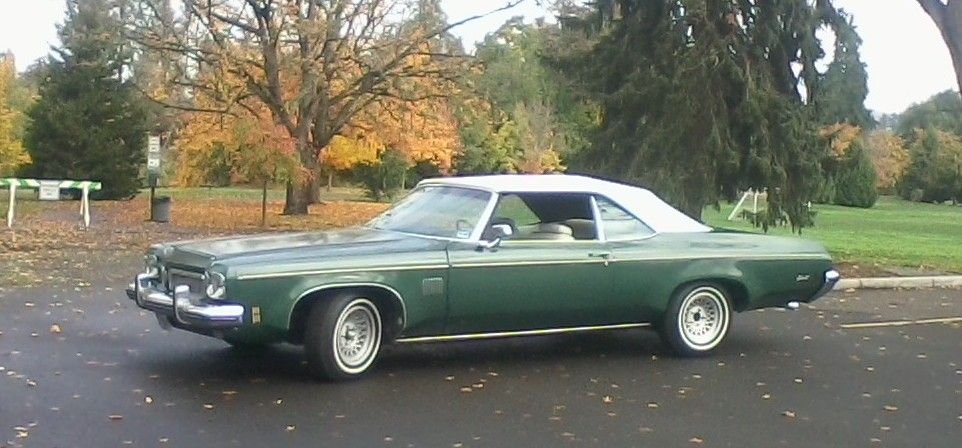

New top. Got it installed just in time for our rains. Had to leave it up for 30 days so it could stretch and shake into place. Supposed to do that in the sun, fat chance this time of year so I put it in a friends' paint booth and warmed it a few times.
