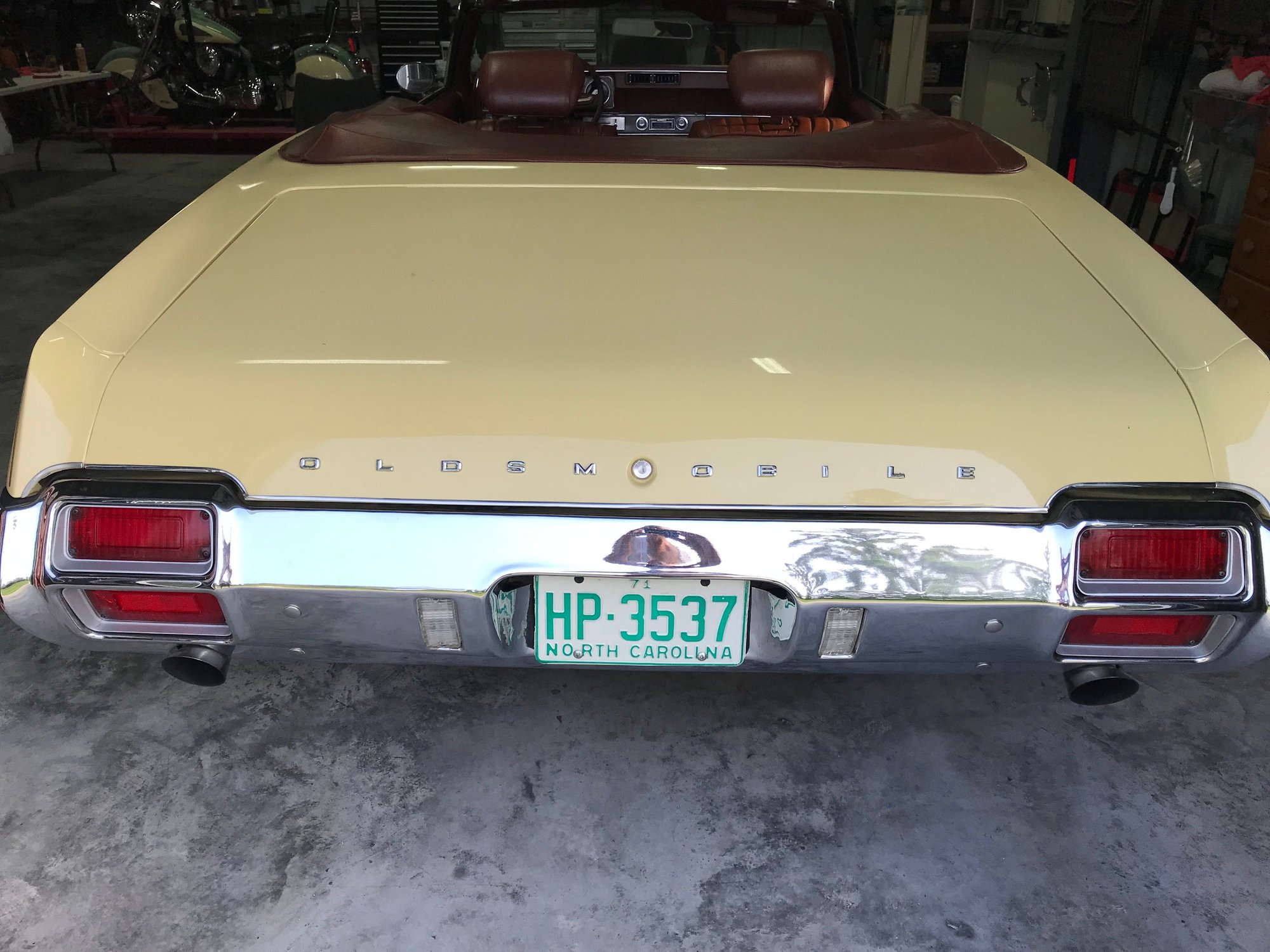

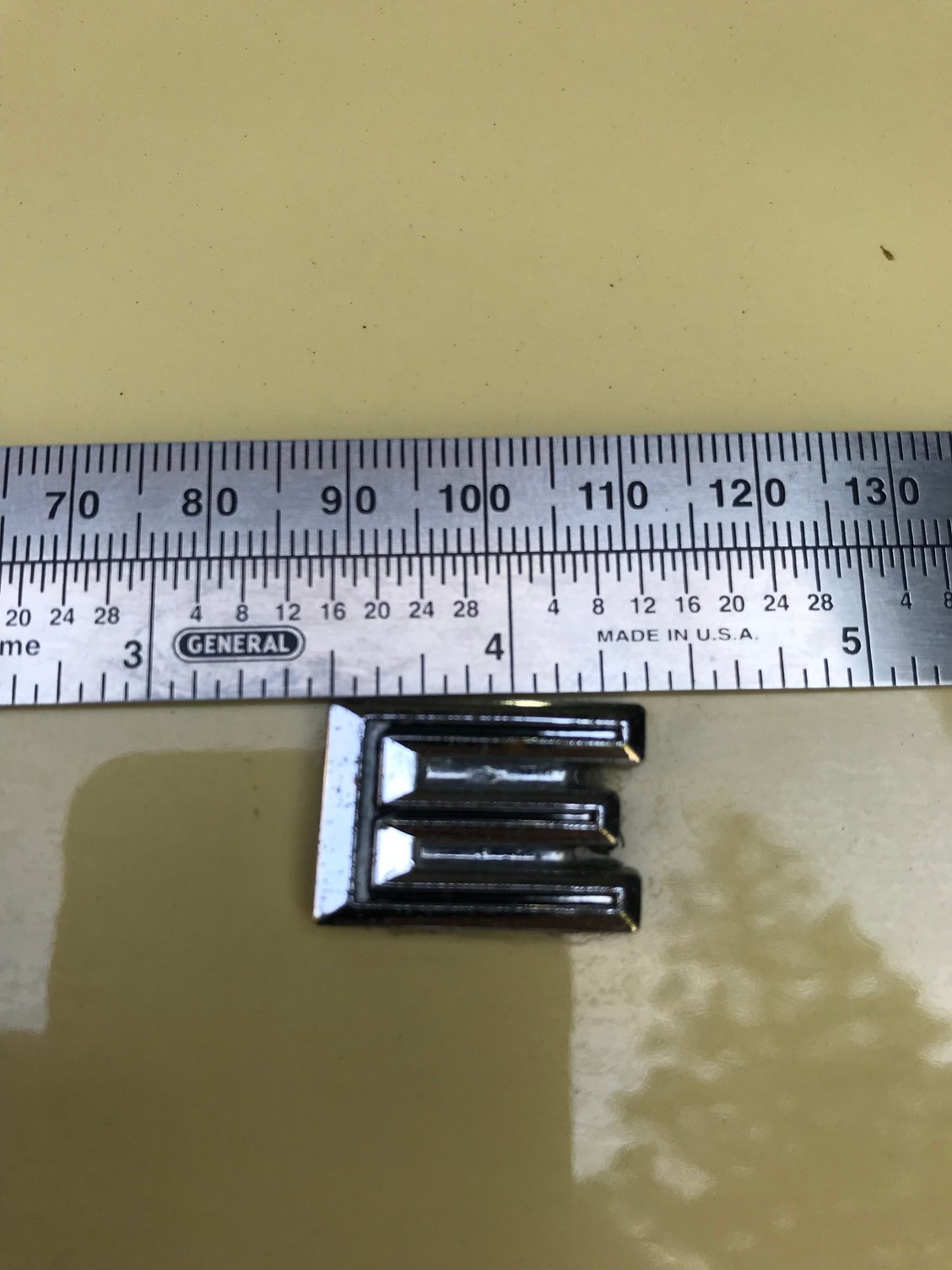

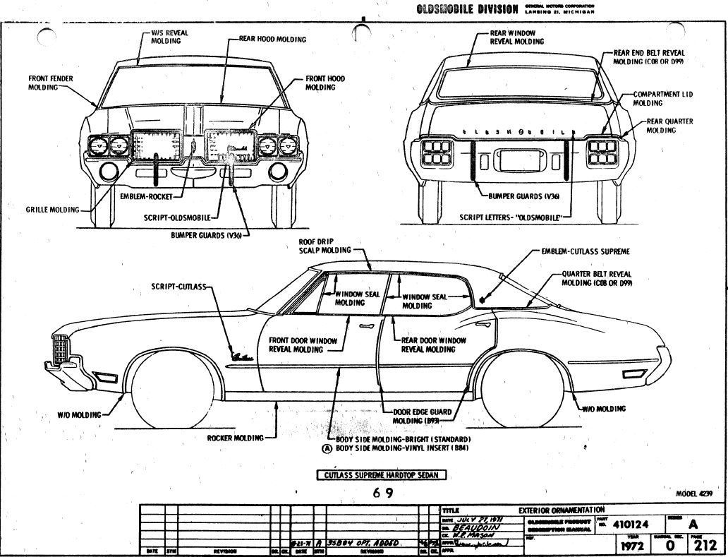

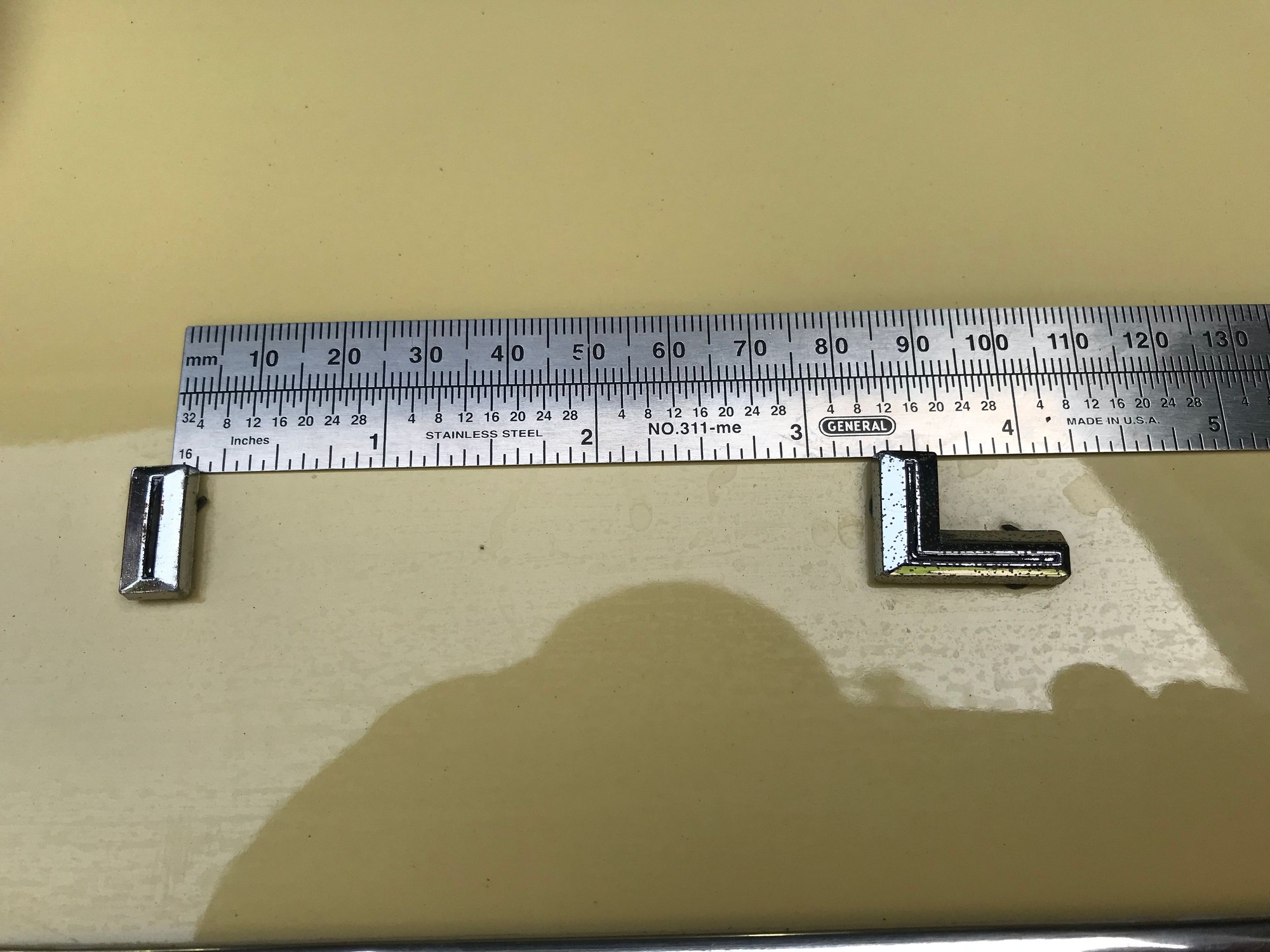

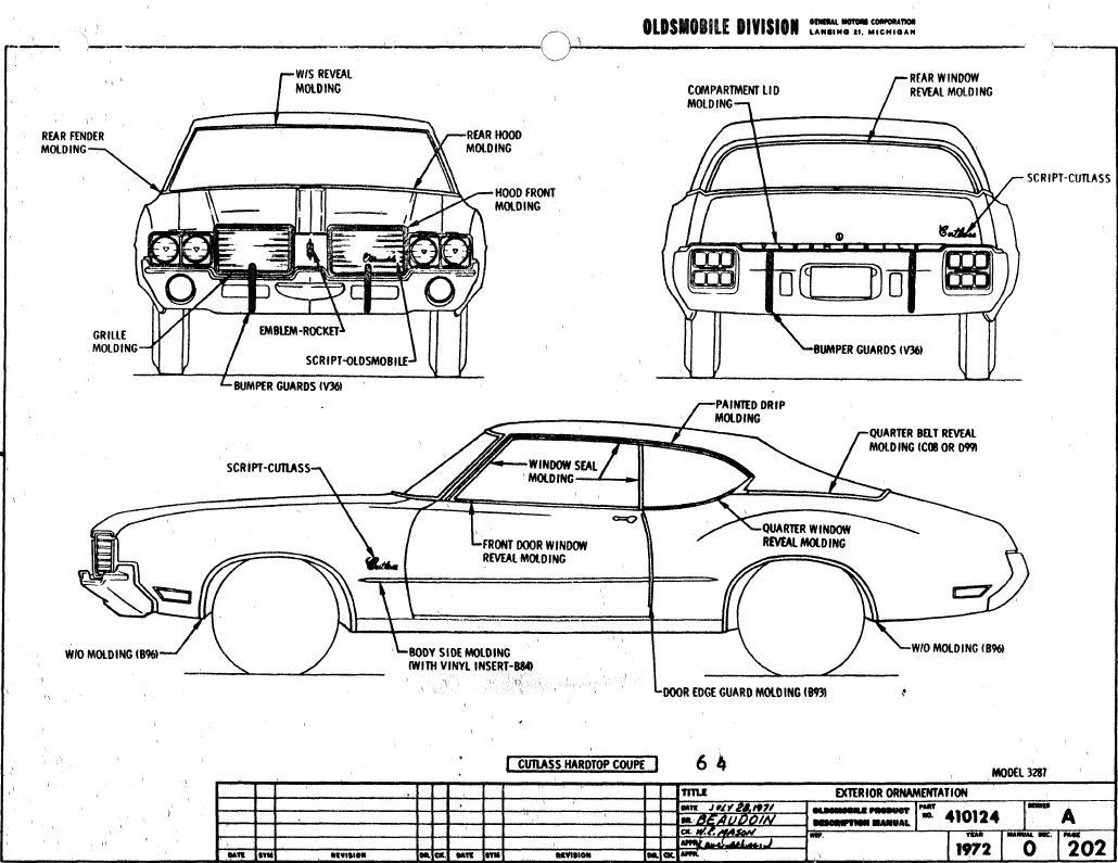

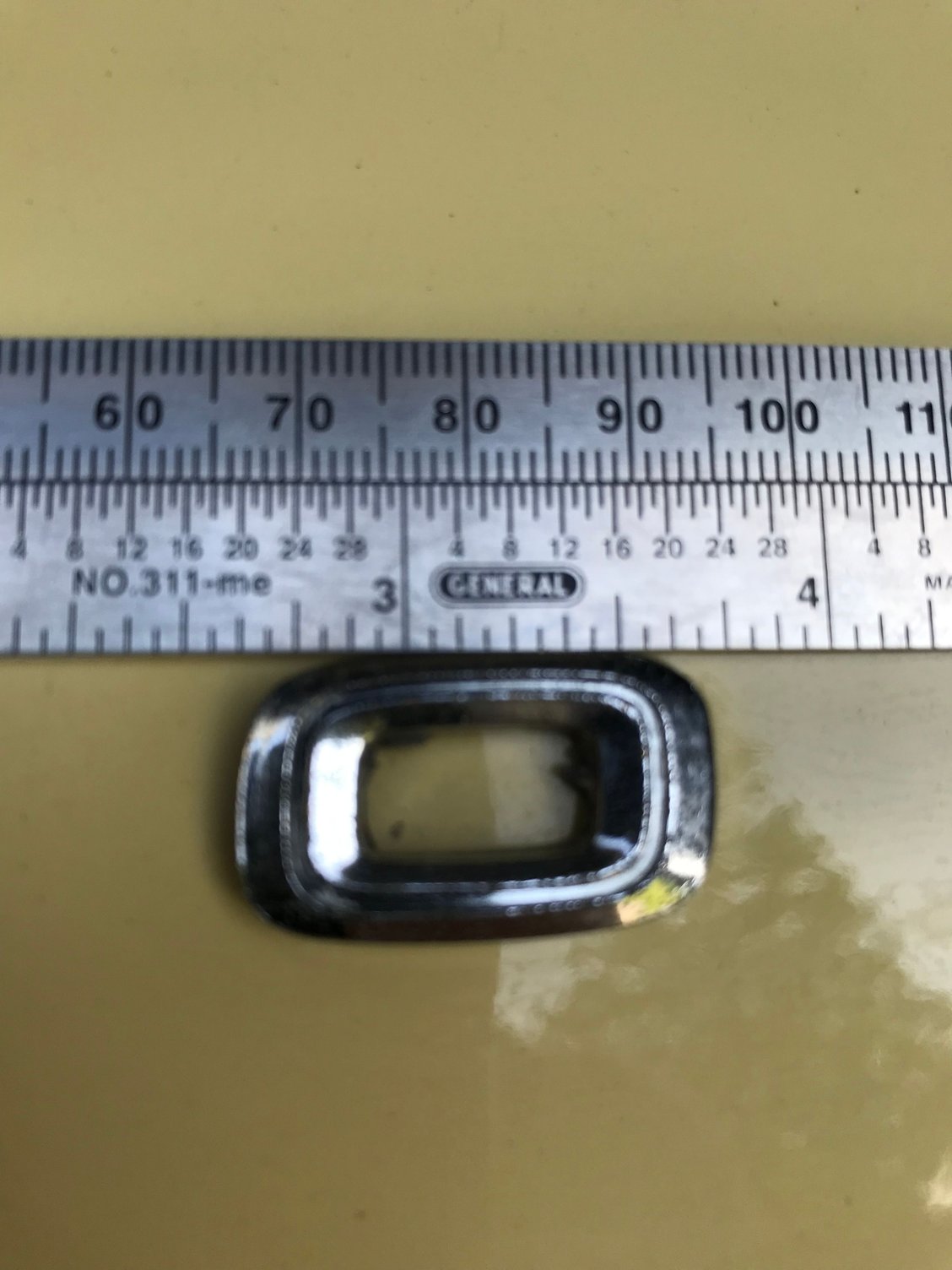

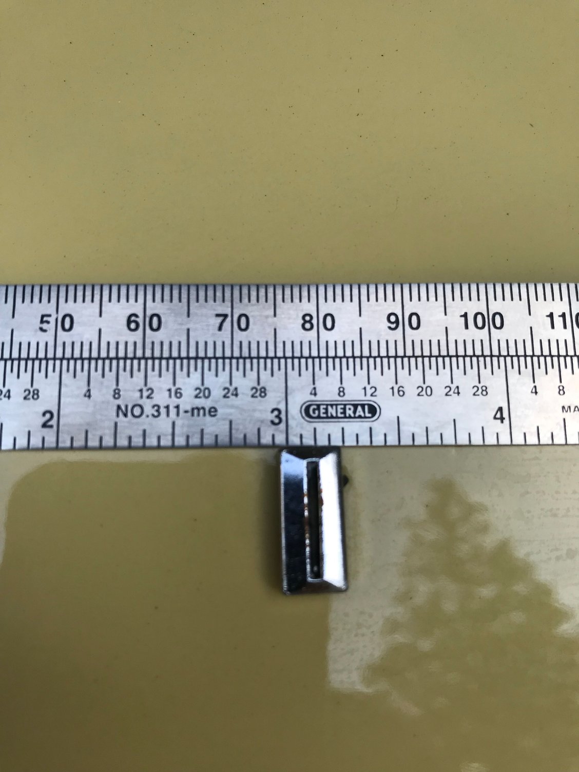

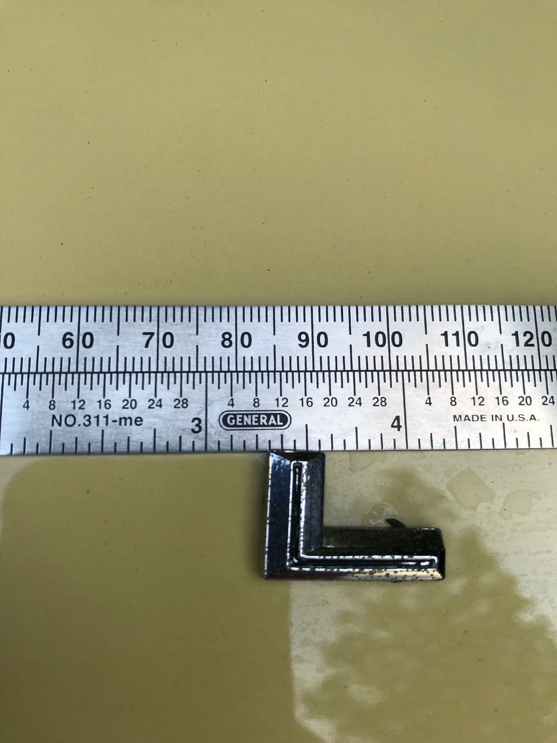

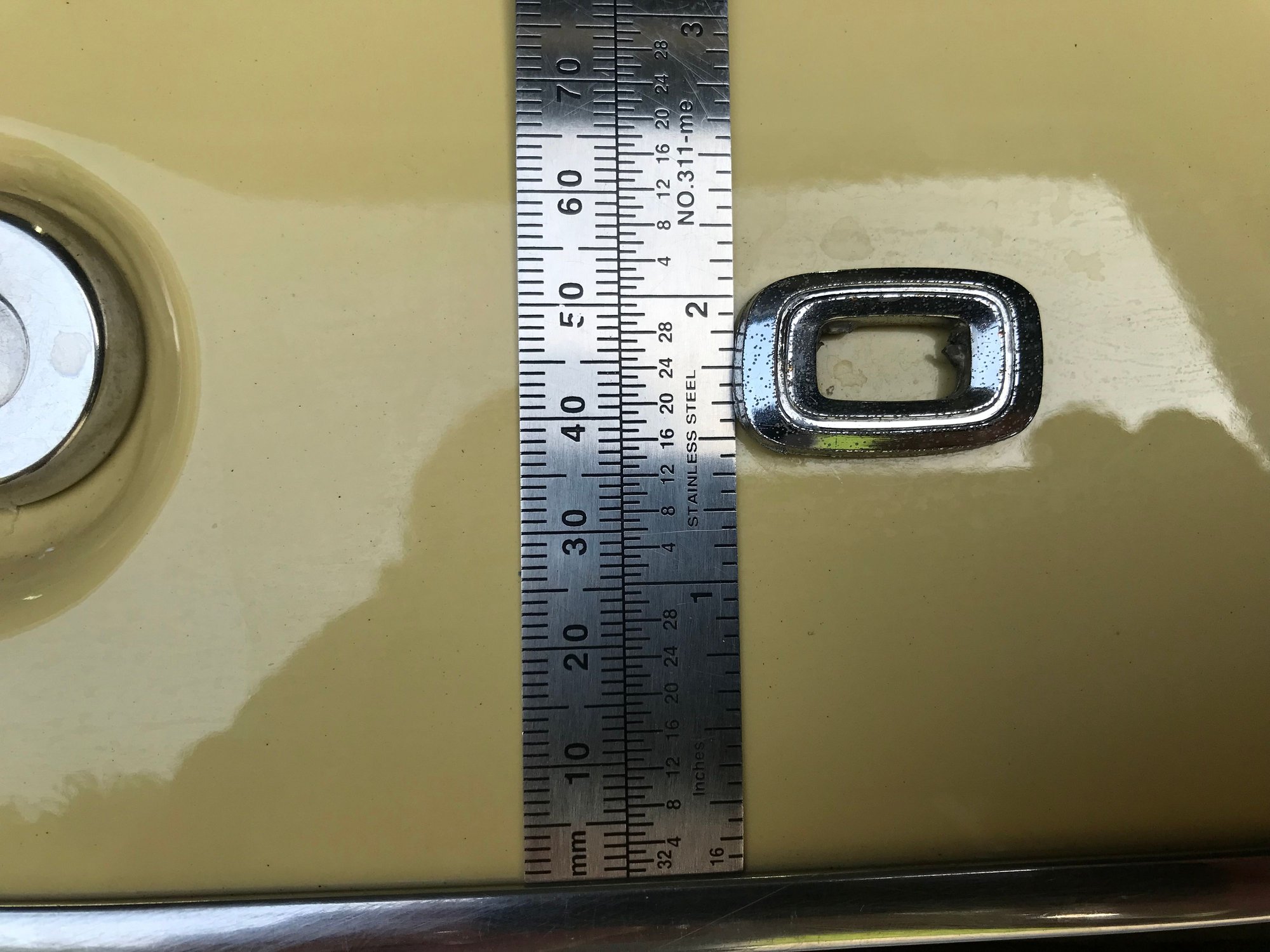

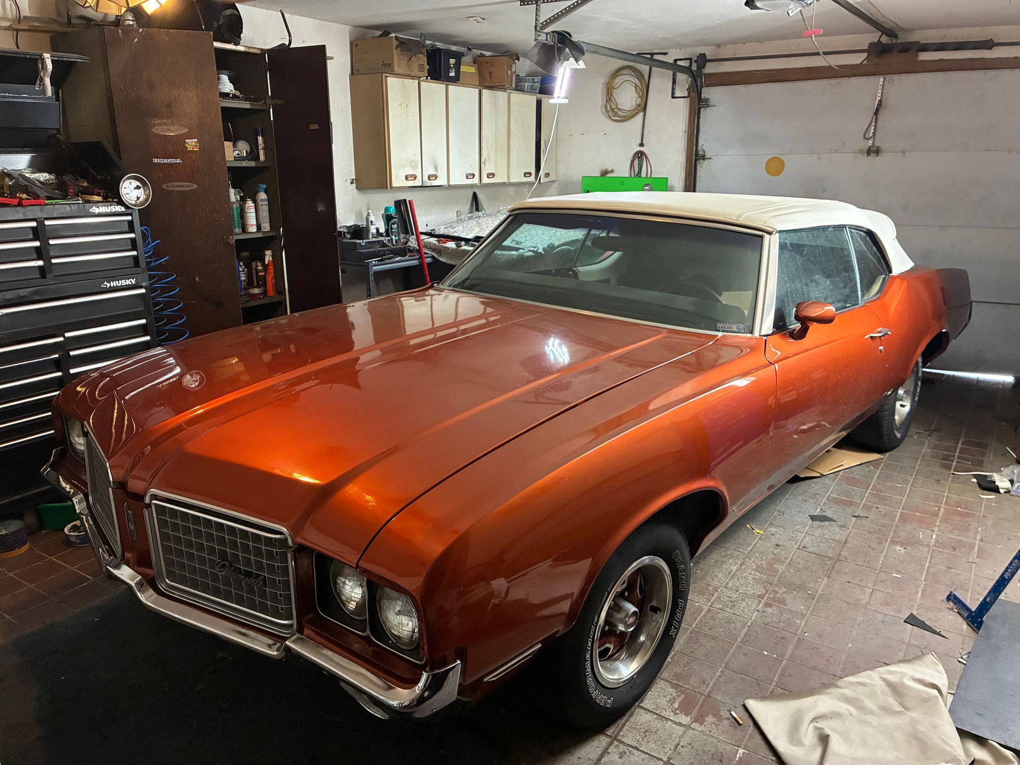

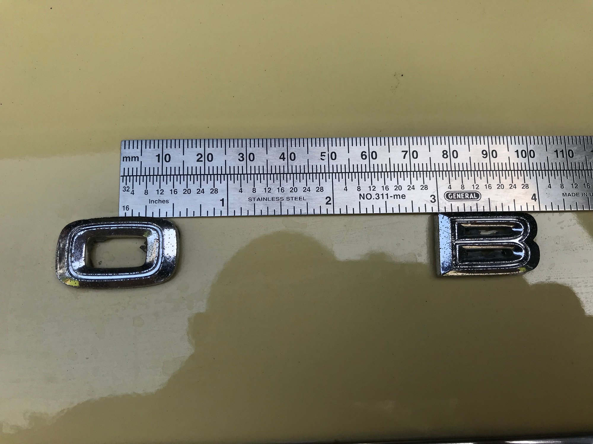

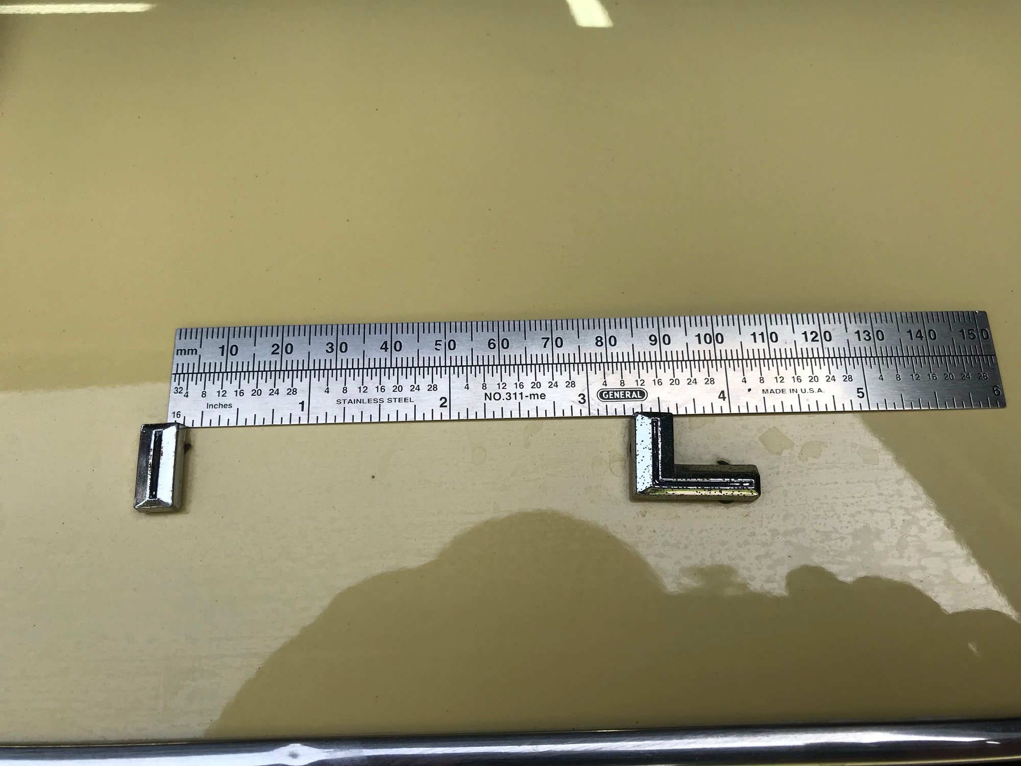

Just getting the 72 Cutlass back together.
Paint went well and I can't find a template for the emblems.
I'm mostly concerned with O-L-D-S-M-O-B-I-L-E letters on the trunk.
Help,advice or criticism is appreciated.

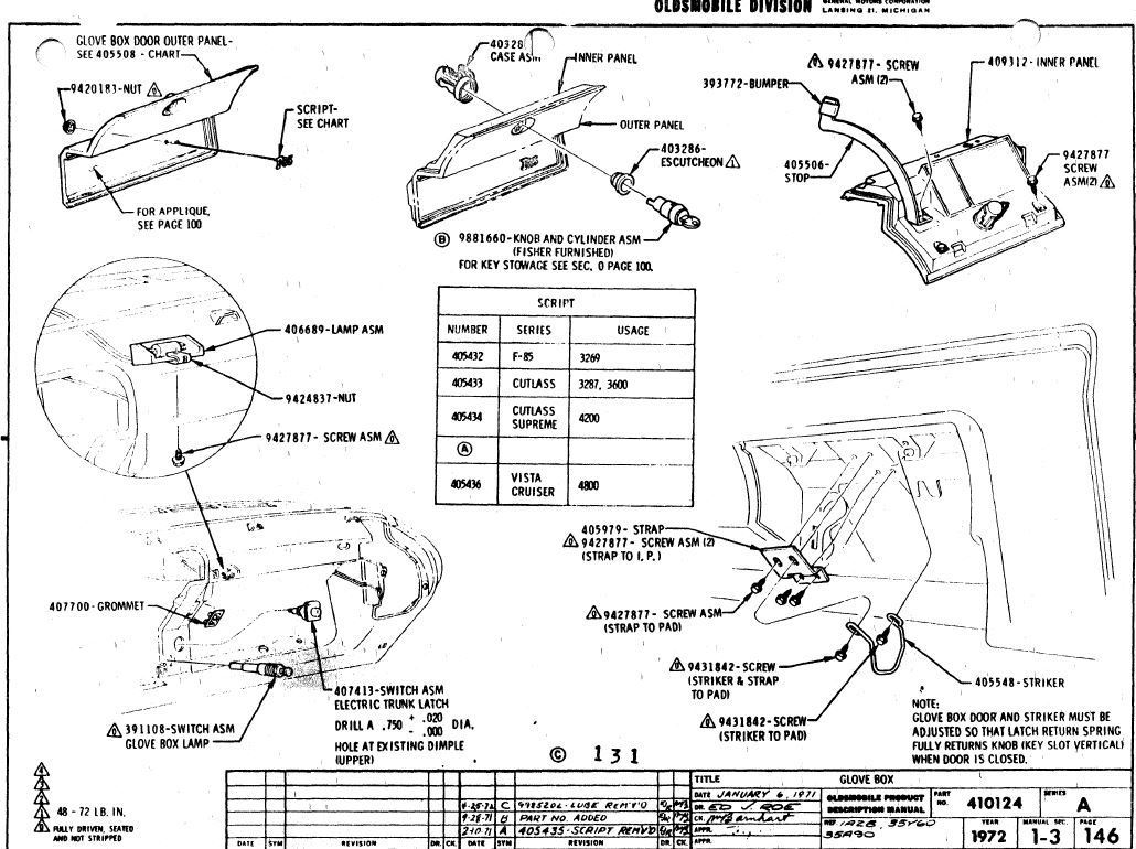

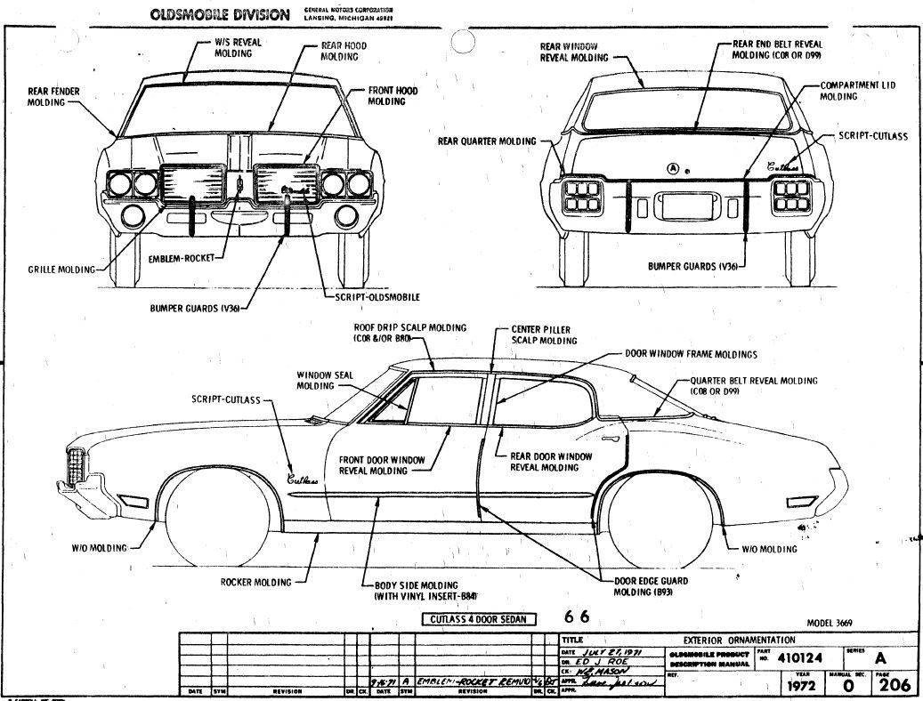

Do you own the 1972 CSM? Locations, emblems, scripts & decals are listed in the CSM.
Old Yesterday | 08:08 PM
Posts: 26,014
Ooops I may have lied. I think they're in the PIM. I'll look.
Old Yesterday | 08:12 PM
Posts: 26,014
Yeah, they're in the PIM. I think I posted some numbers on a thread several years ago. I'll see if I can dig them up.
Old Yesterday | 08:14 PM
Posts: 26,014

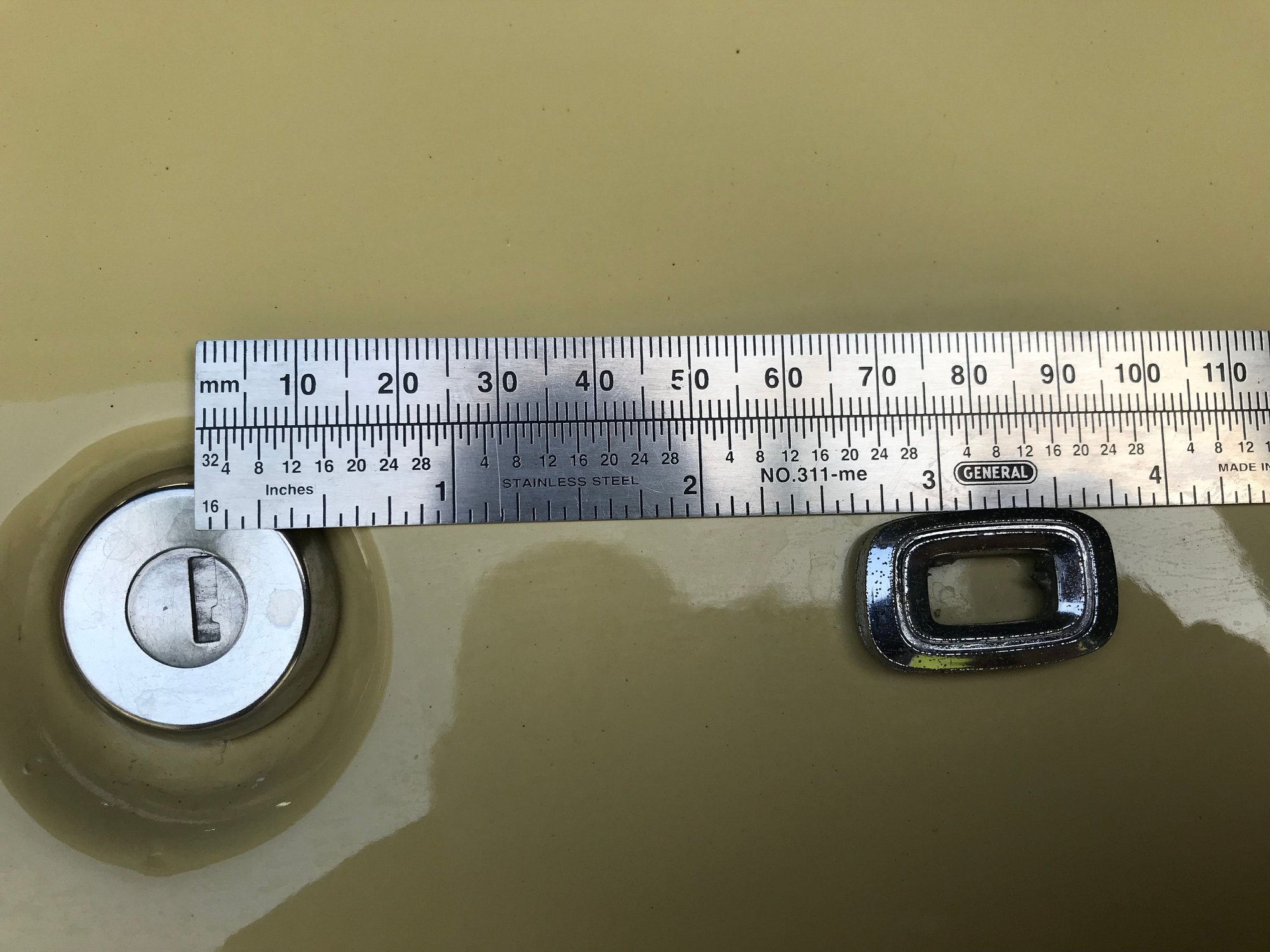

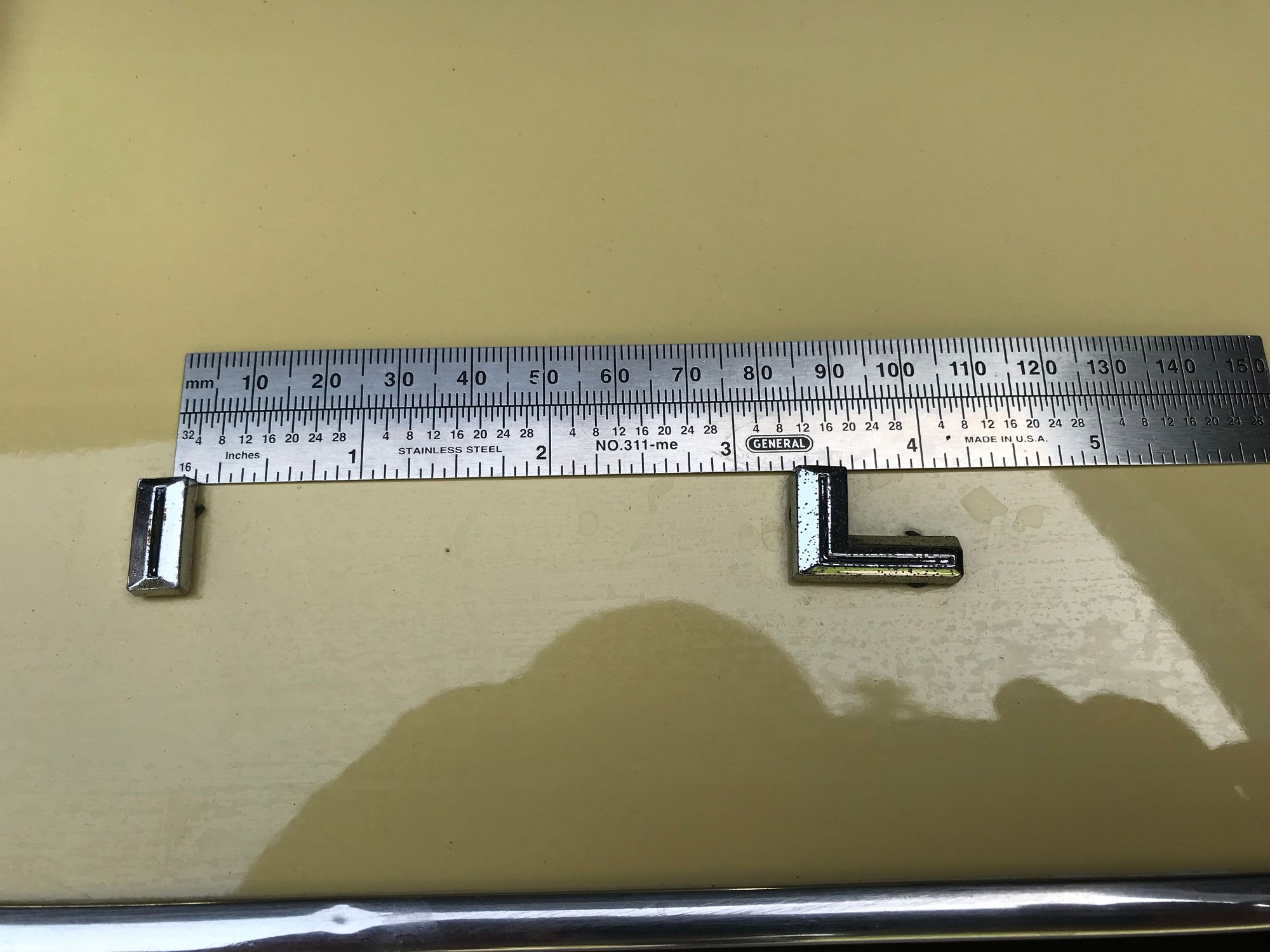

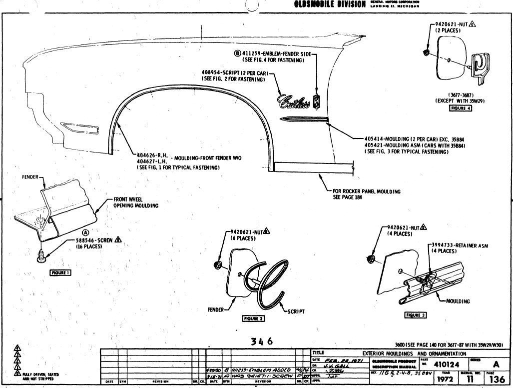

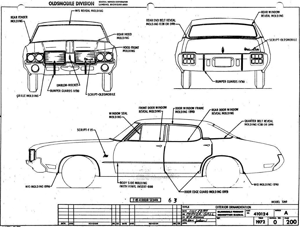

OK, I have a sachet of images I created.....INCOMING!!

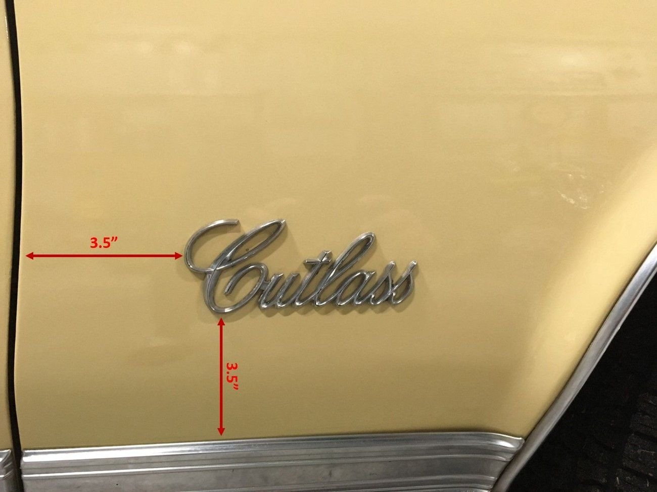

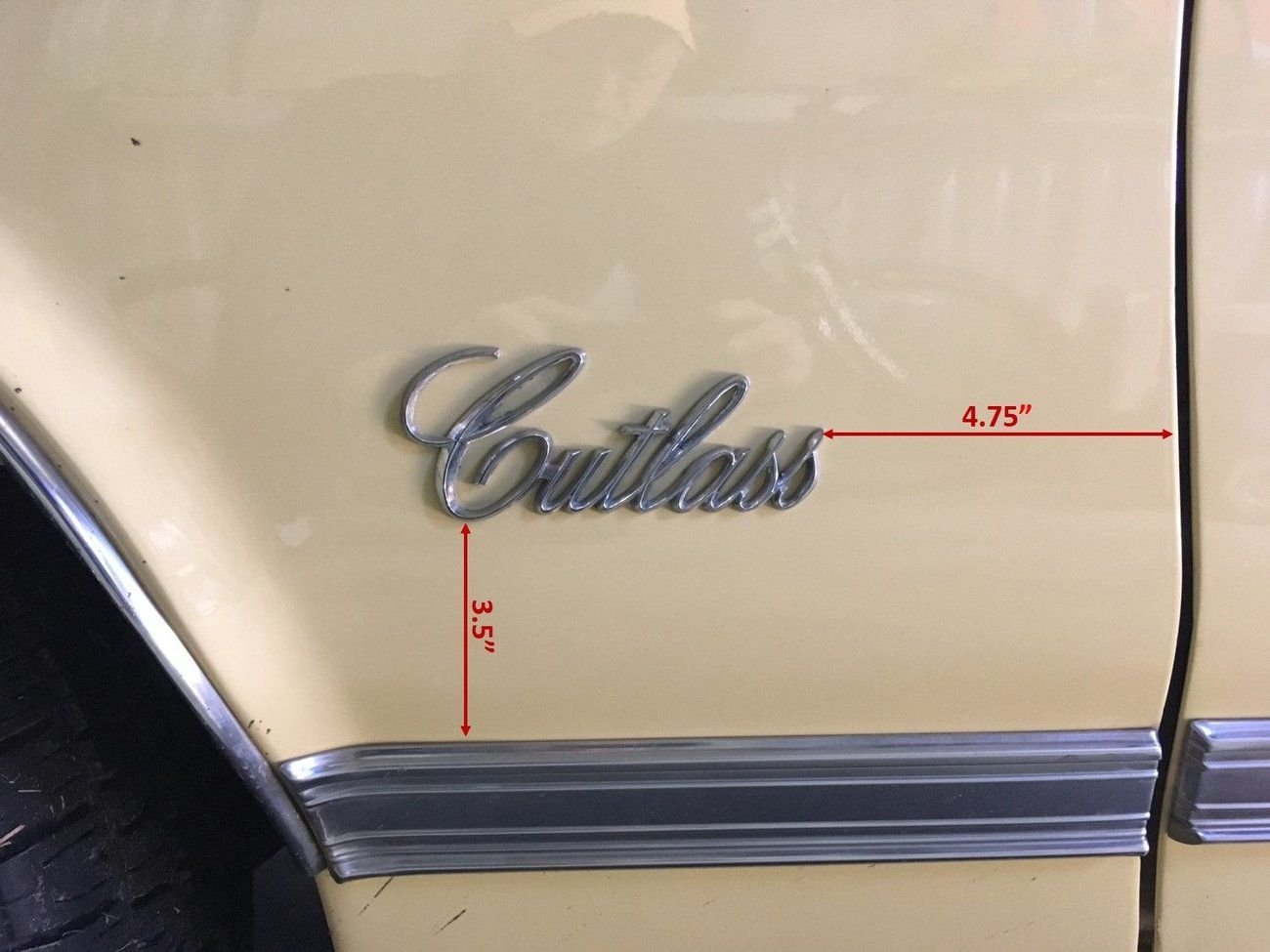

Forgot I had these...
RH Side
RH Side
LH Side
LH Side

Thank you Chief,
I had your pictures of the Cutlass fender emblems, but never found the others.
I am super grateful, Exactly what I needed.

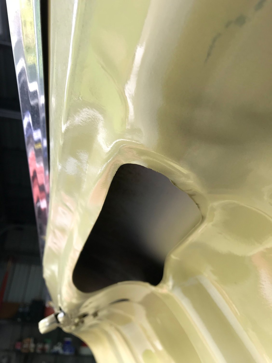

It makes sense that panel piercings are not available. Those were stamping department die designs. Each panel goes from a coil, to a blank, to a panel. The blank goes through the press, and, at a minimum, gets hit twice. The draw die does most of the work, and the second die, I think it is trim, trims the "handles" the first die used. Some stop there, but there are also piercing dies for holes, and flange dies to do weird sideways things. Nowadays, all emblems and text are glued on with 3M double sided wonder tape. They load the emblem in a jig and it datums to the nearest edge and on it goes.

John - This is a really good bit of history. Thanks for sharing.

Old Today | 08:01 AM
Posts: 26,014

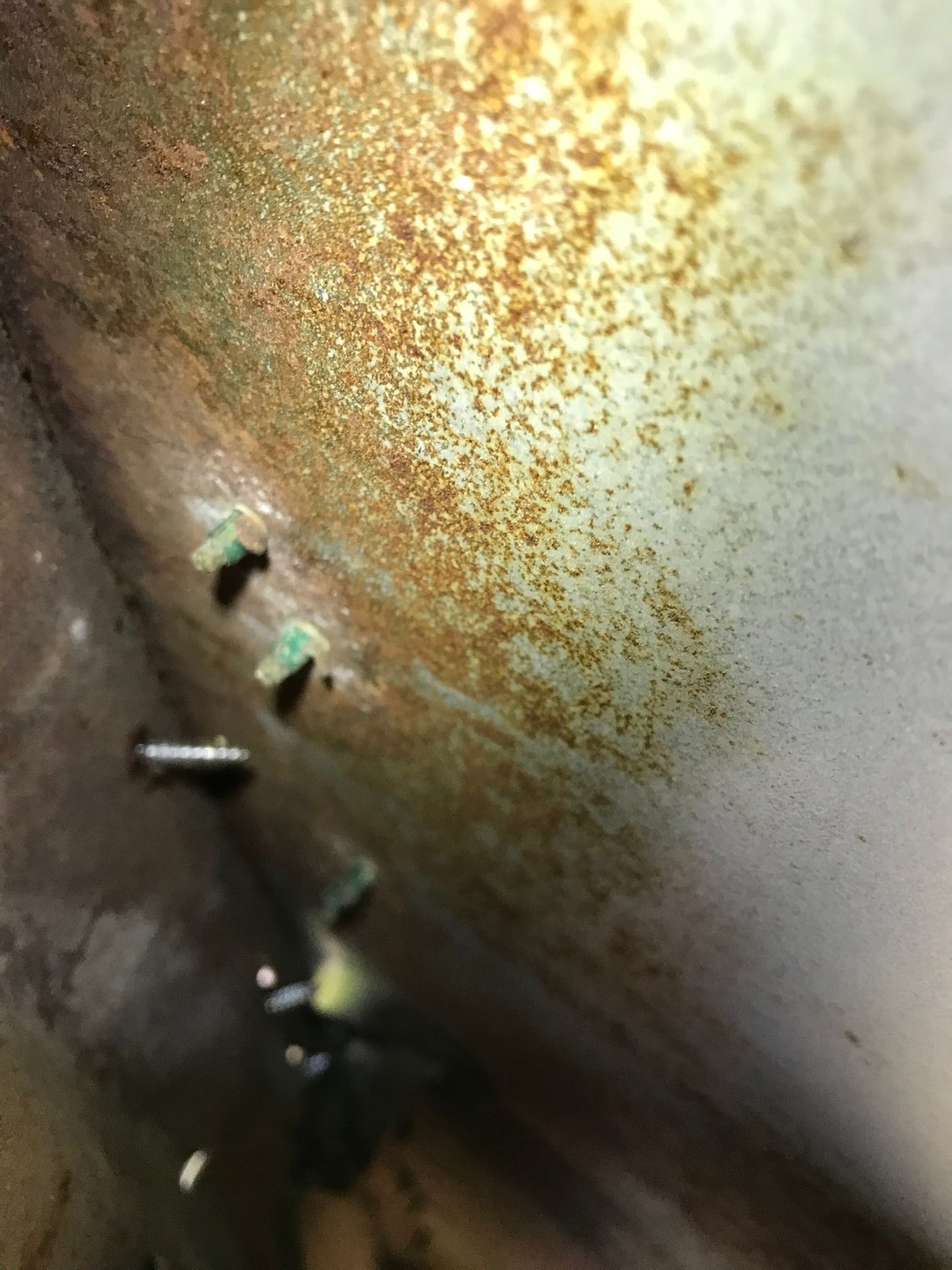

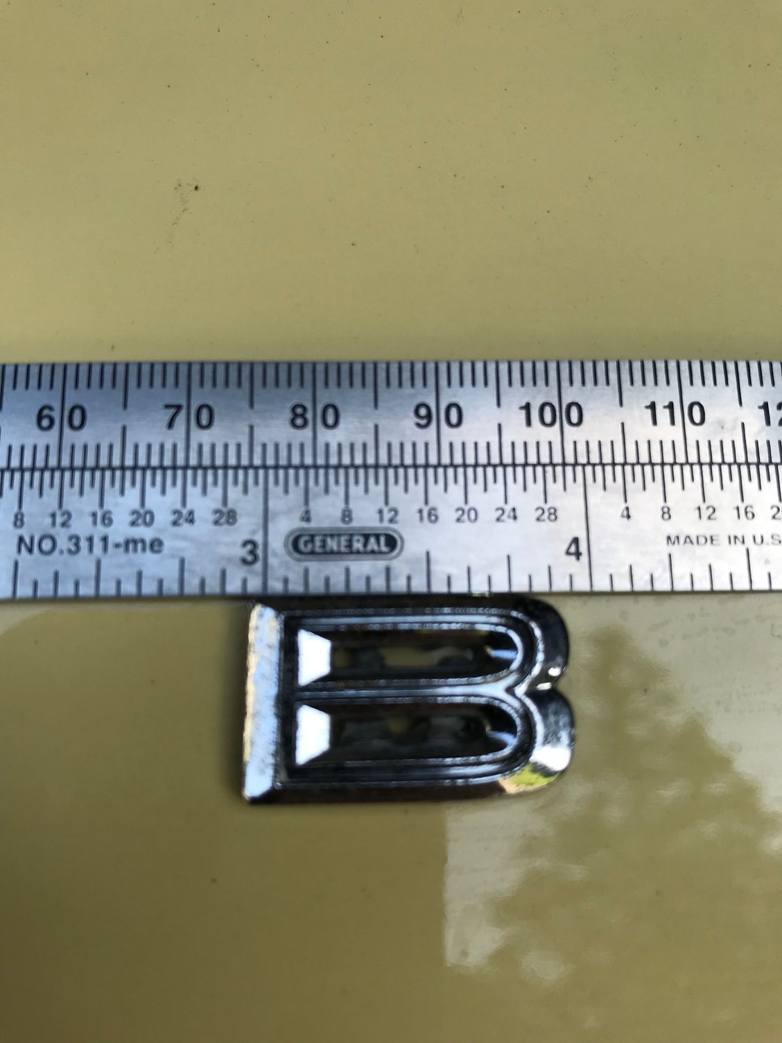

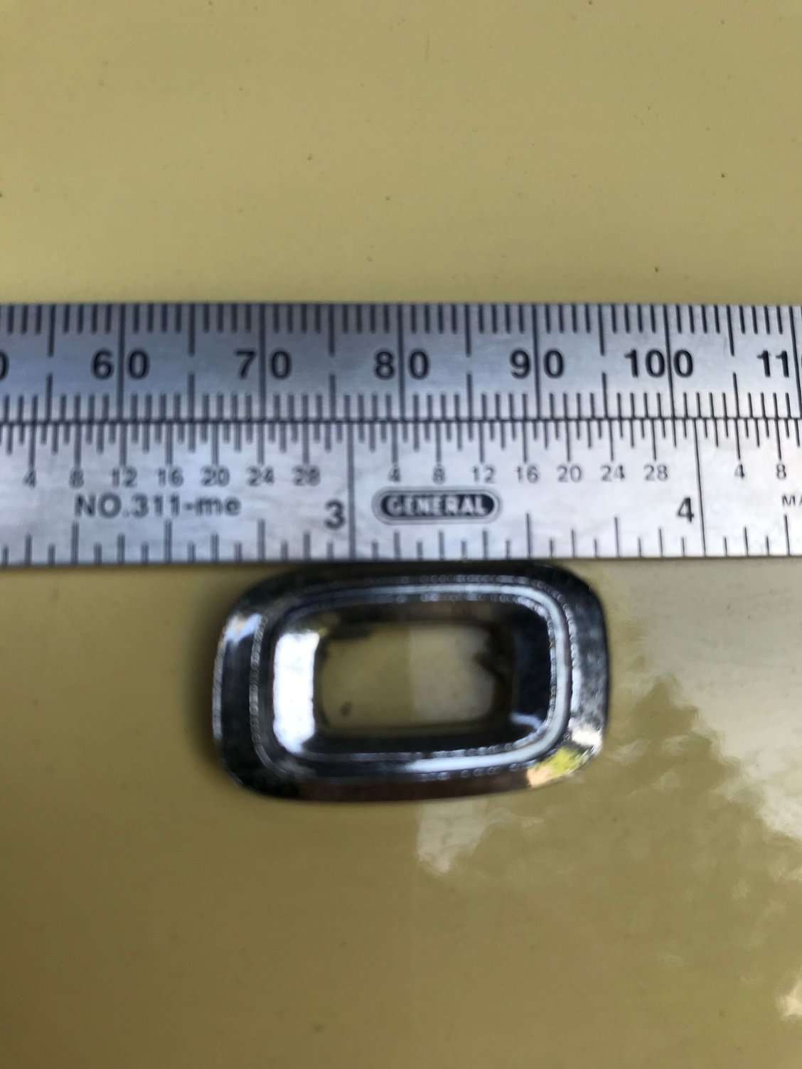

Not even 100% I published those detailed images of my O L D S M O B I L E trunk (compartment) lid to this site. Well, they're up there now.
