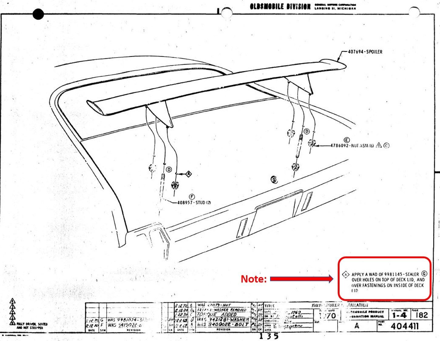

The prior owner had installed the rear wing/spoiler and them removed it before I bought the car so the mounting holes are already on the trunk lid. I was getting ready to reinstall the wing but am wondering tf there is a gasket that goes between the bottom of the wing post and the trunk lid or is it just metal/fiberglass to metal? From what I have seen online it apprears there is no gasket.
Also, looking online I see mention of 3 mounting studs. The spoiler I have only has 2 studs and there are only 2 holes in the truck lid.

There is no gasket, and while factory wings used three fasteners per side, most repro wings only use two.

I have the same question about the rear corner metal pieces that are just outside of the trunk lid on both sides...is there a gasket or just metal to metal fit?

Part # 9981145 is a synthetic resin plastic thumbgrade sealer. I cannot validate what constitutes a "wad".

the aftermarket wings (at least from parts place) came w a gasket
A "wad" is smaller than a "glob" , but bigger than a "dab"

I bought my rear spoiler from Fusick. It's just like the pic in the assembly manual, 3 studs on each side with the middle long one going all the way through the pedestals to the wing. They also supply a full size template for drilling the holes.
