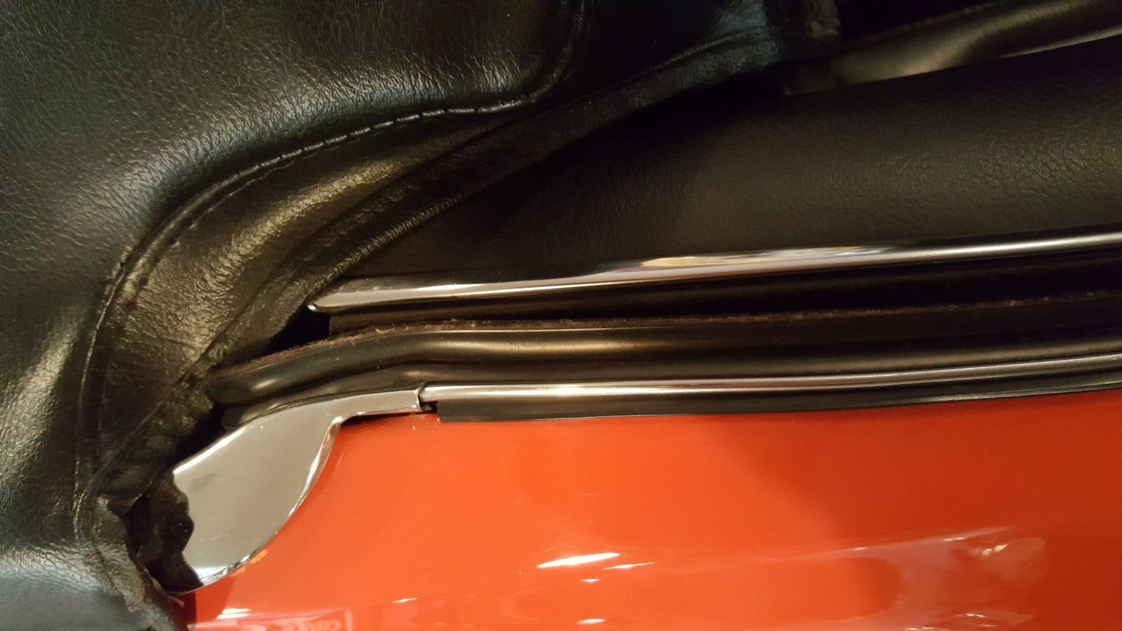

Having cleaned up the window regulators and replaced the rollers things now work nicely. To top off I finally received the weather stripping set that was back ordered. I have had this apart for a while and as I try to fit the weather stripping in I can't tell which piece goes on top of the other. The pinch molding or the new weather stripping. They both seem about the same size and who knows over the years if the pinch molding has been adjusted. I have looked through the manuals for a detail but have had no luck. Can someone send a pic showing "who's on top" ?
thanks.

Your window sweep is not the same as the original style. PUI makes one close although it takes some effort to make it fit correctly.

These actually are from PUI, but they just don't seem to sit right. Either the pinch molding needs to be opened up a bit or the seal closed? The pic answers my question and looks very nice. thank you.

Yeah, the side window beaded trim slides into the female slot of the top molding.
