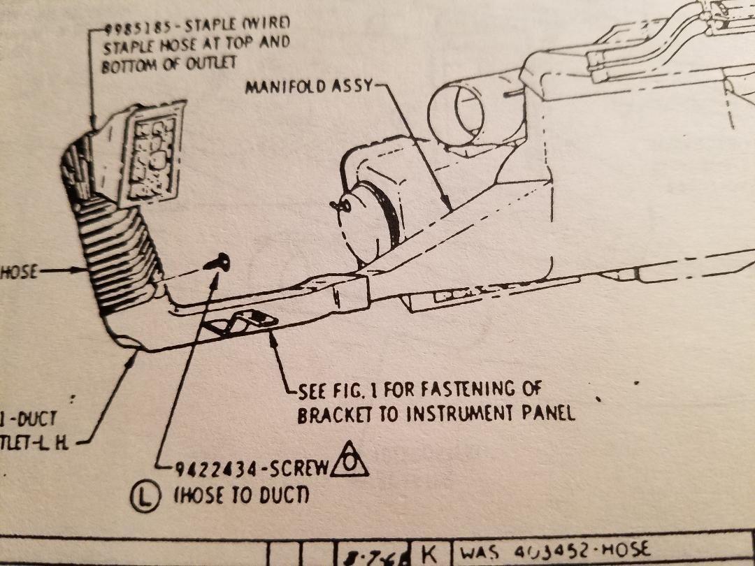

Here is a snip from section 1-1 p 214 of the 68 Cutlass/F85/442 assembly manual.
The flat oval duct is what you need or something similar to adapt to the aftermarket system manifold.
A quick search of the net shows plenty of Camaro and other flat profile ducts similar to Olds.
The 68 duct isn't easy to find. A couple of guys here in the classified section may be able to help. Place a want ad and look at the for sale page.
The 68 PN is 399411
Also, look at the industrial commercial supply places(McMaster Carr, Grainger) to source something similar that's pliable enough to allow adaptation. I'm surprised the after-market vendor does not have anything? Did you inquire?

Thanks for posting that picture for the '68. It is definitely different than '69.

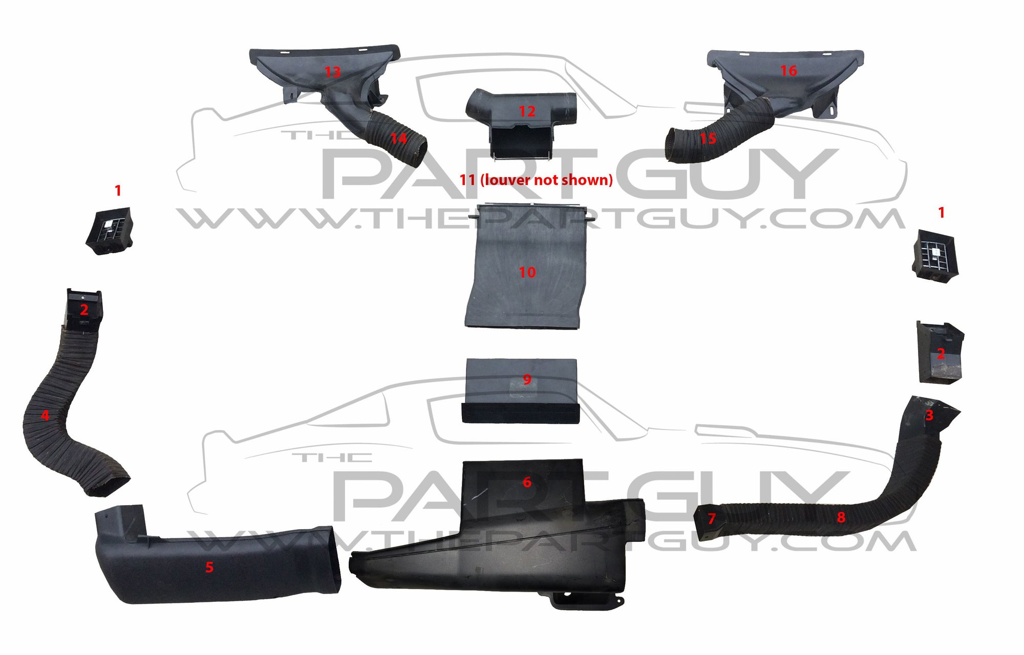

Actually the duct running under the column is the same for 68 and 69. The center and the right hand ducting are a little different, but the driver side uses the same part# 399411 duct (#5 in the photos below) under the column both years to deliver air to the driver side A/C vent.
Here is a pic of the duct work for a 69:
Here is a pic of the ductwork for a 68. Notice the right side on the 68 uses some round connections (6,7, & 8) vs. the rectangular connections and flex hose (6,7, & 8) on the 69:

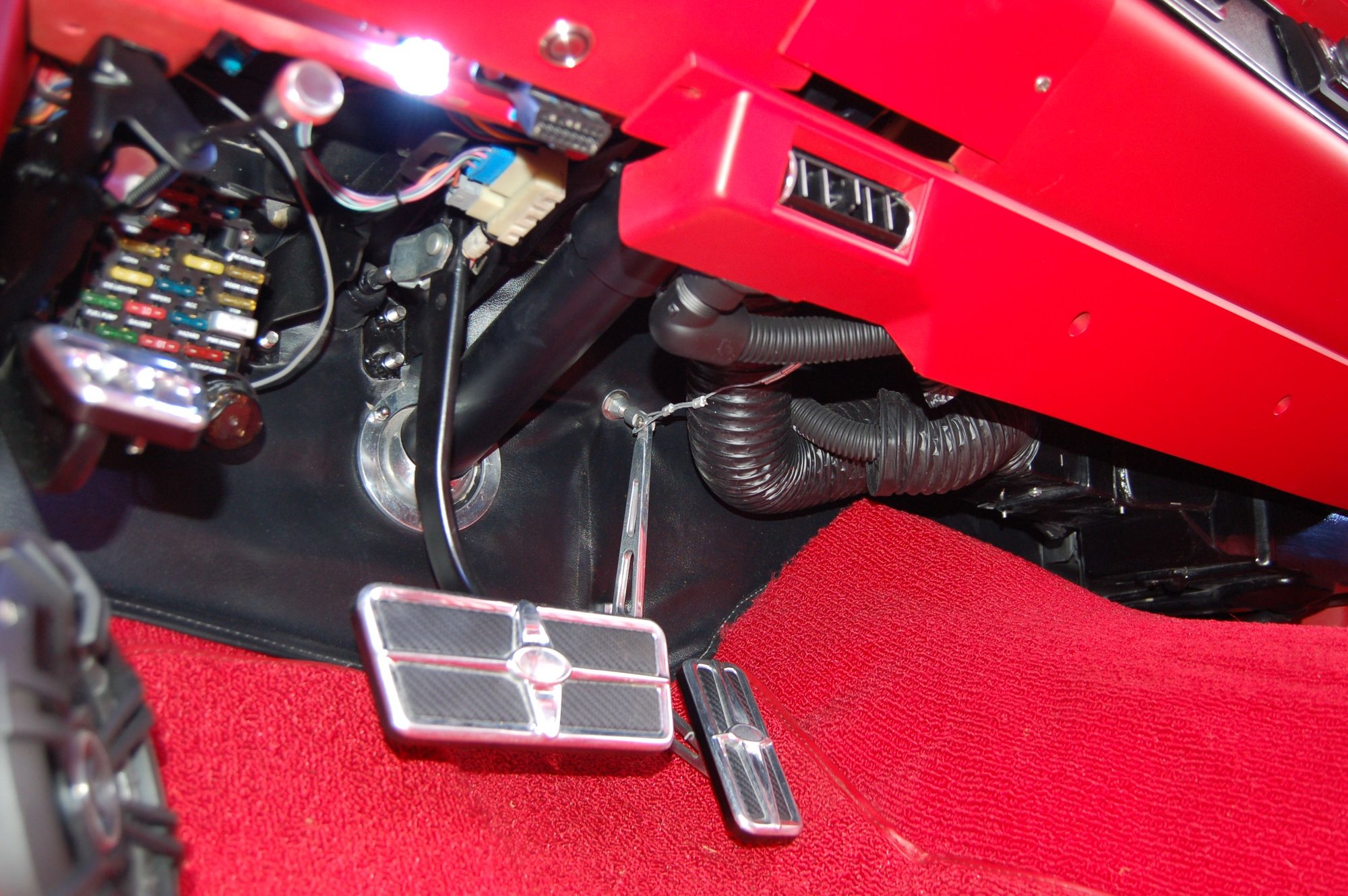

To the OP, there is room to run the flexible hose in your vintage air kit above the column but you need to go the whole way up in the area behind the gauges. The pic below is of the A/C setup in my car. I know this does not really show the routing, but you can see it is not under the column.
Holy 💩! That looks incredible! Do you even drive it?
I do, and I have to say the Gen IV vintage air set up is no joke. Keeps the inside of the car nice and cool. With the gate glass down, you can feel the cold air blowing the whole way at the back of the car which is saying something for the interior of a vista cruiser.
