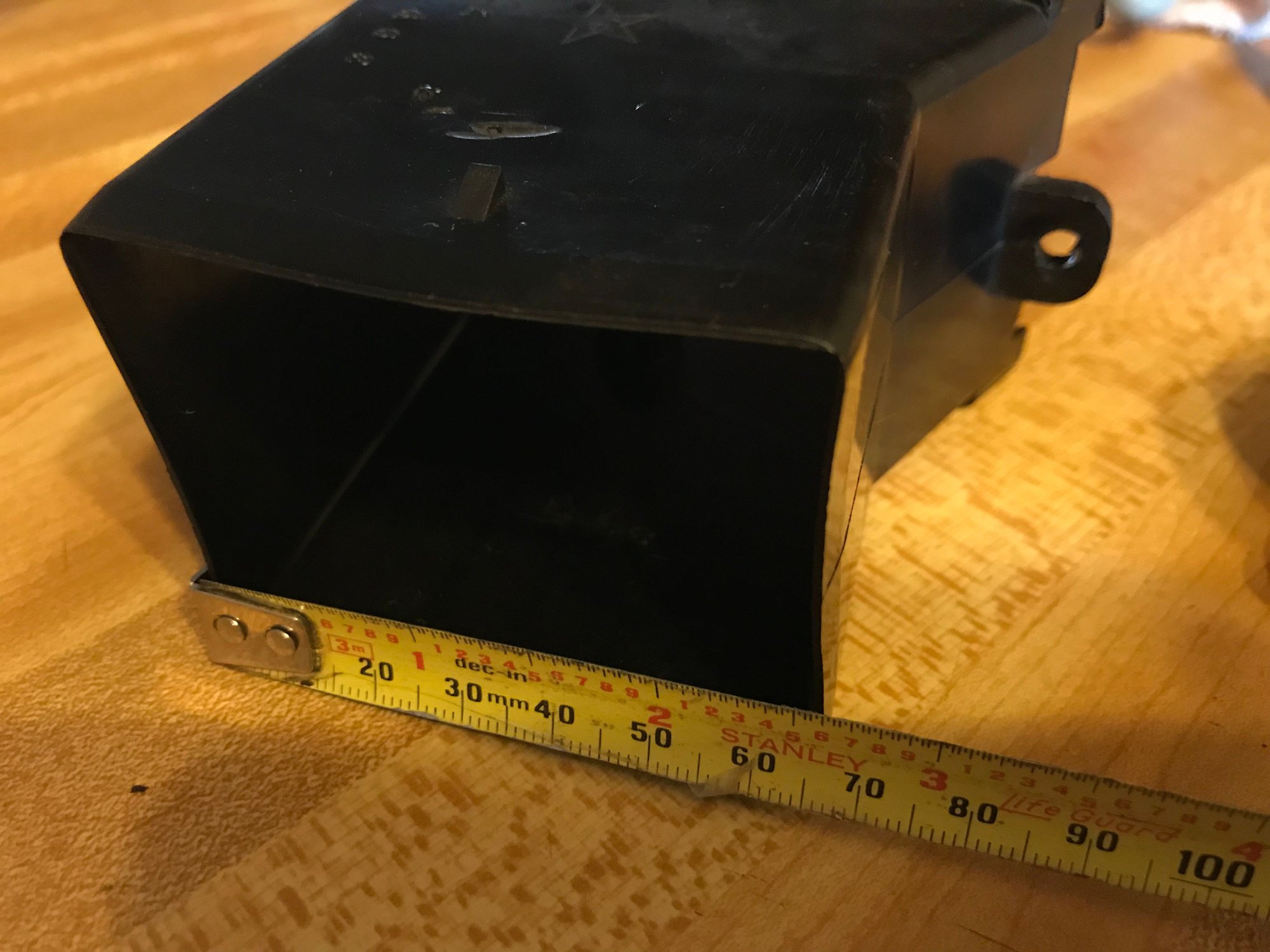

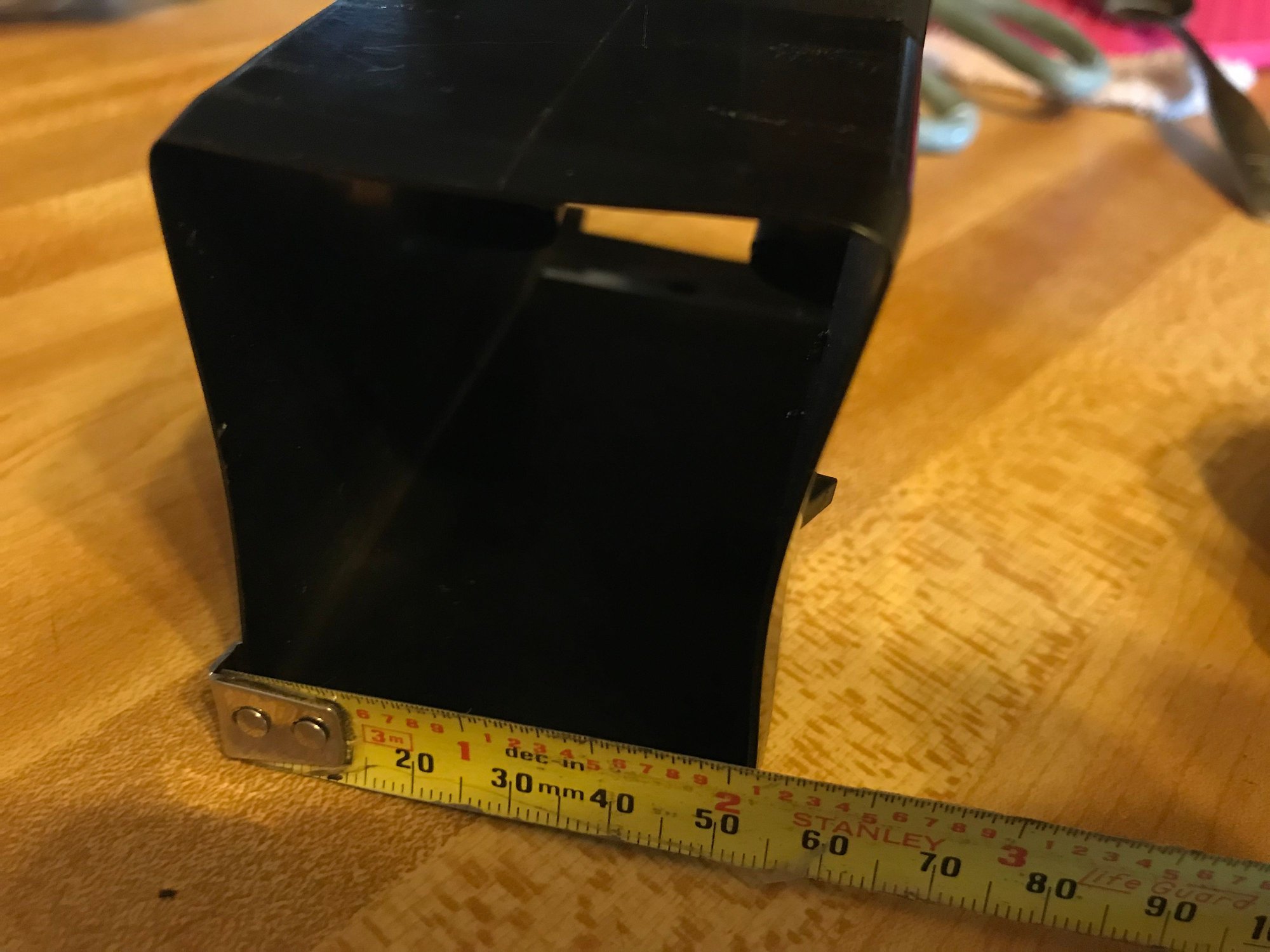

Vintage air makes adapters to fit the 2.13 x 2.63 rectangle found on the plenum and outer louvers. It is p/n 496083 and you should request (2) "S" clips per adapter. For the obround driver side of the plenum, there is no good solution other than getting creative.

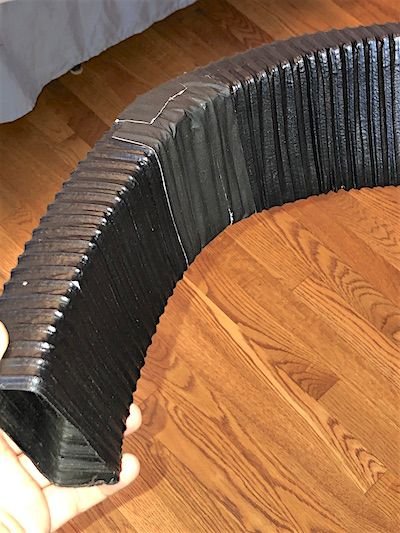

Phoenix:
The driver side duct is 2-1/2"x 3" square which equates to a standard size 3-1/2" round duct. The passenger side duct is 1-3/4"x 4" which equates to 3.66" round duct (not a standard size). If your ducts only have a few tears in them, they can be fixed with gaffers tape as was previously suggested. My passenger side duct was torn in the middle section. I masked off the damaged area and sprayed with 3M trim adhesive, then wrapped the tear with black gaffers tape. I then sprayed the whole duct with FlexSeal (the stuff you see on TV) which sealed up the pin holes as well as the gaffers tape and the duct is still flexible. Here's a pic:

Nice restoration on the duct. I have looked at Vintageair.com and the # doesn't come up. I don't doubt they have it but any chance you have a direct link?

By the way, I recommend sealing the adapters to the original components using HVAC foil tape: https://www.lowes.com/pl/HVAC-foil-t...pes/3381603586.
