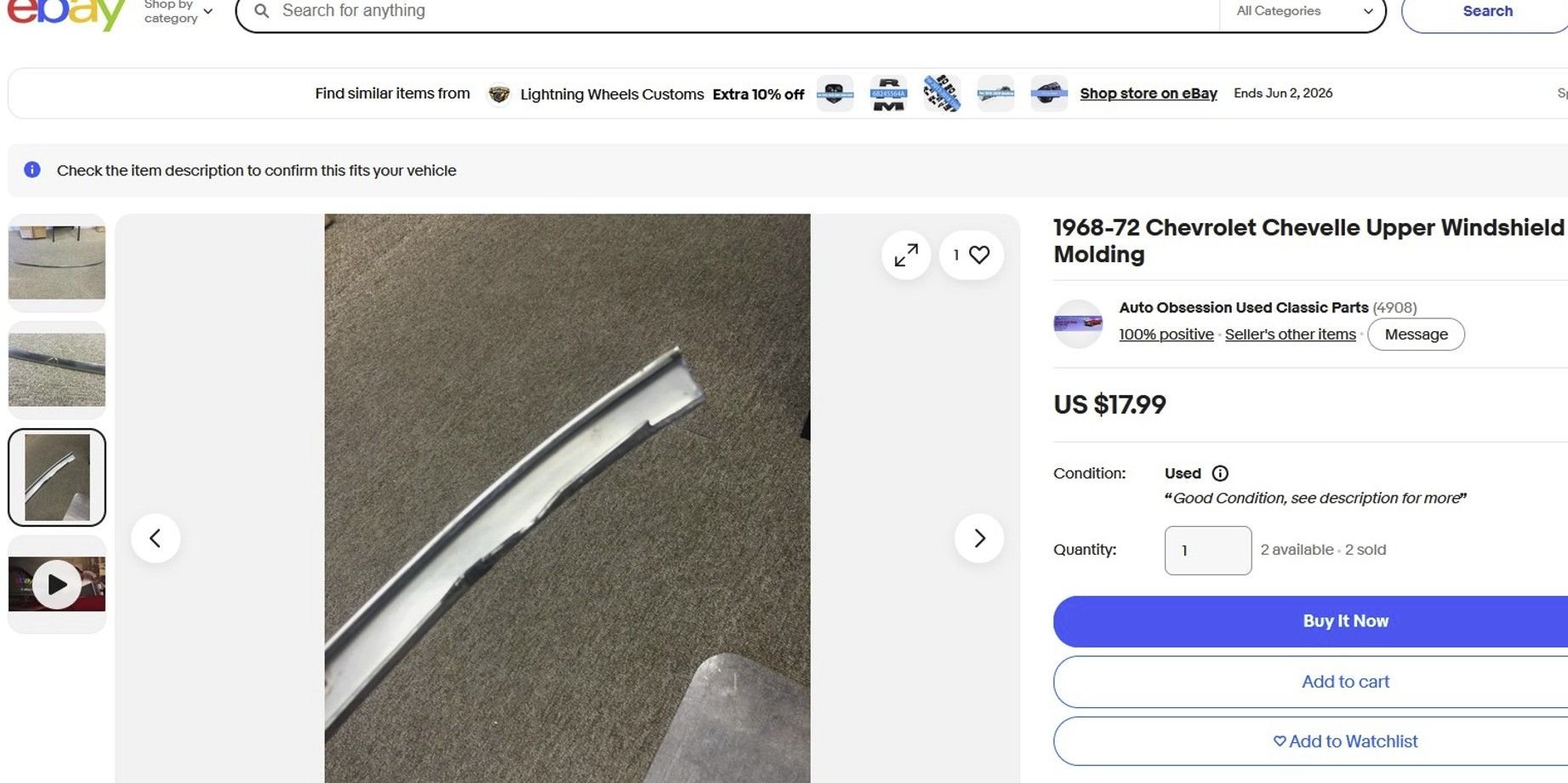

Just for fun, I searched on eBay and found a hardtop with a notch. Maybe its a Chevelle thing for weight reduction
