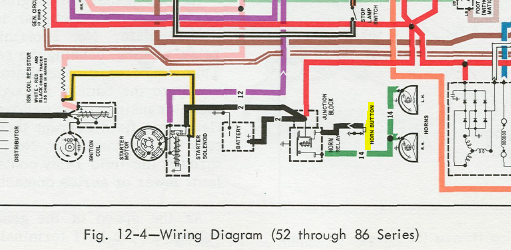

The horn buttons on the wheel...........don't they just provide the ground to the horn relay? Where is that ground connection made? I've looked through the manuals and it's really not clear how the switches make that ground. Maybe start there and see where it's loosing the connection

The short version for now is that the power in comes up to a spring loaded horn pin whose spring can lose strength over the years. And the soft brass pin can wear as the brass horn ring underside presses against it — there’s always interference among these 2 brass parts - when the car is stopped, when running, when going straight and when turning.

OldCutlass,
Many thanks. My rag joint is missing the ground wire.
After 2 days looking at the upper column for worn parts, your post made me look at the rag joint. As my (super smart) wife says, “when you hear hooves, think horses, not zebras”. I spent 2 days trouble shooting the upper column to no avail. But I learned a bunch of stuff which I’ll post elsewhere.
This evening I mocked up a column ground with an alligator clip & the horn worked in “going-straight position”. I didn’t test exhaustively, but initial results are promising.
Tomorrow I’m heading for my Napa parts store to get a rag joint ground strap connecting the column to ground. I’m hoping that when I get it in connecting the column to a proper ground, I’ll get full 360° horn function back once again.
As an aside, and not an accusation, I let my professional mechanics handle brakes, suspension and steering. A while back I asked them to remove & replace my steering box. It looks like the replacement rag joint just didn’t include the ground wire we expected from the old days. I’m thankful my pro’s were focused on steering safety & not horn function. If I have to choose, I’ll go with safety over lights & horns every time.
I’m hopeful that’s the fix for my ‘66 tilt & tele error. I’ll let you know once I get the ground strap in & can test.
Once again, many thanks to OldCutlass. Great call! Hope I can return the favor one day.

Just to close this out here for anyone following along: the problem was in fact a modern day rag joint.
I added a ground strap made of braided wire between the spline bolt and the front of one of the 5/16's-24 bolts and it solved the problem.
