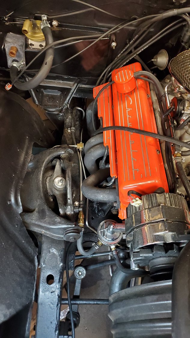

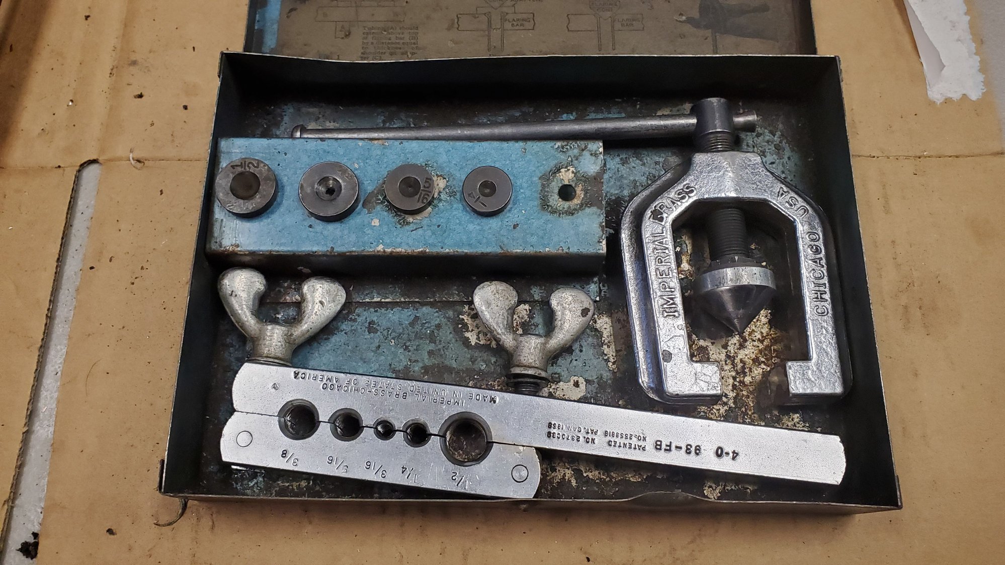

Going through this, now. Get a GOOD double flare set to do stainless. I just scored this from my brother's estate, and it's night and day compared to the Ding How crap.
I am doing 3/8" stainless (measures O.D., btw) on this 62 Impala. Use inverted flare fittings (like brake lines); the brass cone nut style don't work so good. There's too much friction in the fitting, and you lose about half of the sealing surface inverted flare offers.
He had a rubber fire hazard
thanks for the info. I have my grandpas old flaring kit. Should work well. Looks just like the one you have pictured.

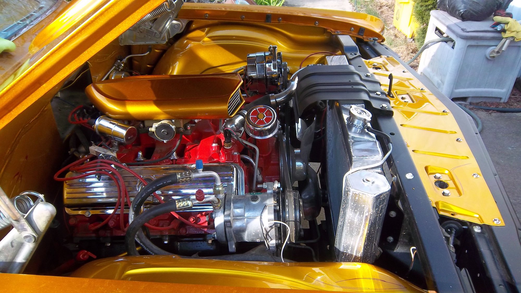

A nice bent steel line is both safe, and take up less room than rubber, or SS braided lines. Much cleaner! I installed the glass filter on this 61, just above the fuel pump, as it didn't have the vacuum booster there.
very helpful! Thank you for the pics as well. This has been very helpful you guys!

It usually does, but if you look closely at my picture, you can see a bracket I made, going up along the back of the filter, and bolted to the top of it.
Is that all 3/8 tubing there? I’m having trouble going from the 3/8 inverted flare nuts that slides along the tubing, to the filter. The filter is 1/8”. I need to go 1/8” into either end of filter, and have the female end accept the 3/8 inverted flare. HELP! Any suggestions on fittings so I’m not reducing like crazy and having way more fittings going than I need be!!!
