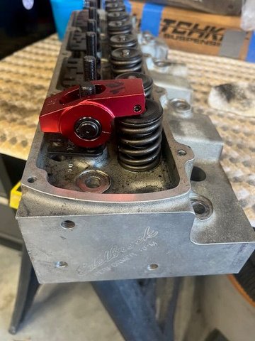

I'm building a 455 BB motor to replace the 350 in my 1969 Cutlass. The build includes Edelbrock Performer aluminum intake manifold, Gen 1 Performer heads, Bullet roller cam and lifters and roller rockers . I understand I'll need to address the valve covers and limited space under the A/C and master cylinder positions. I've identified chrome, dished valve covers through OPGI, part #C240691, but I'm not certain their tall enough to fit the roller rockers. Raising them with a thicker manifold gasket or a spacer risks clearance interference with the A/C and master cylinder. I'm looking for feedback from members who may have addressed this issue in the past.

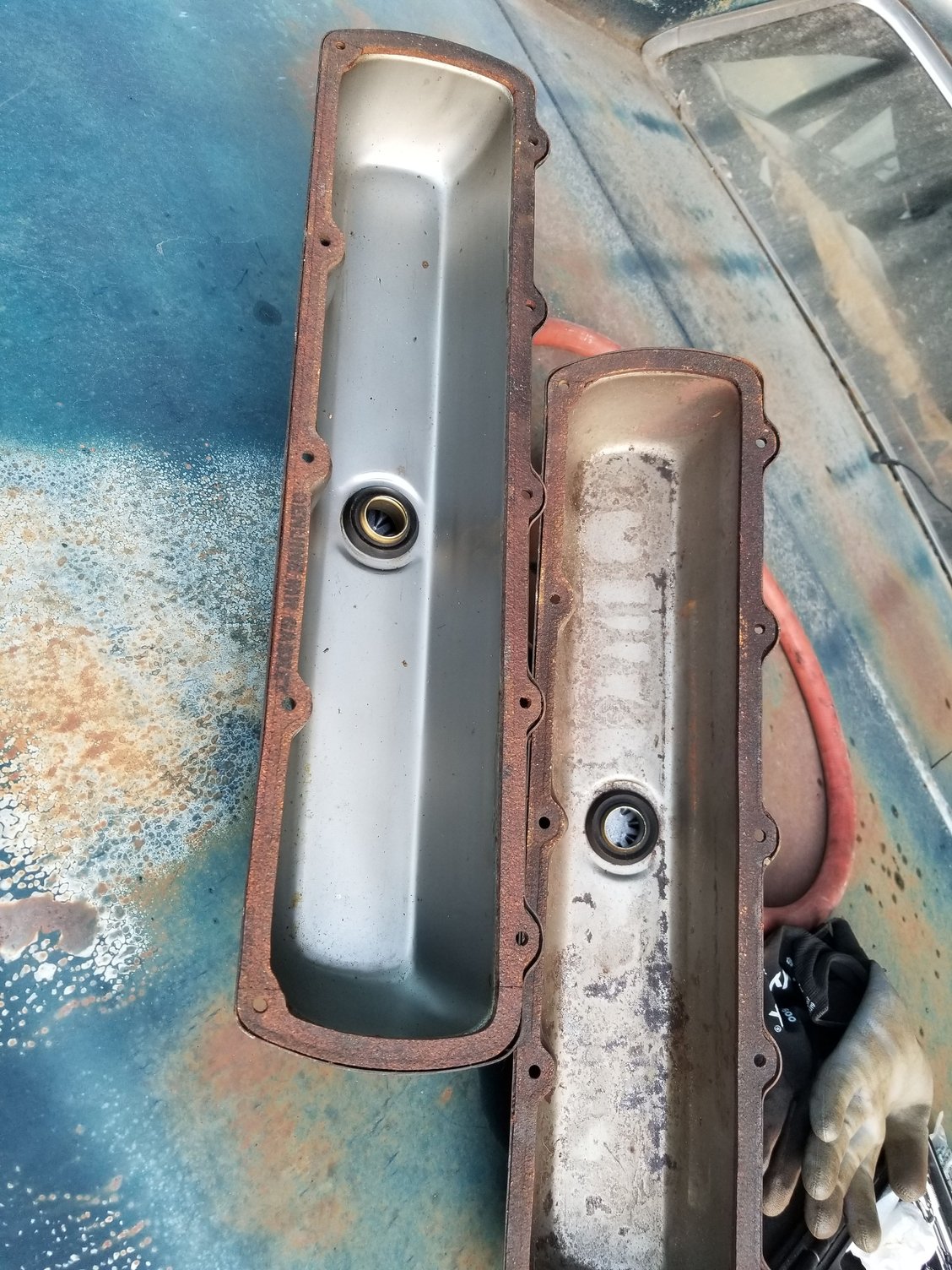

What roller rocker setup are you using? Give us as much info as you can on this. Some of our readers have had success with removing part of the internal baffle from the stock valve covers to get clearance for stud mounted roller rockers and short poly locks are available to help. I used 2 of the non baffled '64 or '65 valve covers and cut holes to use Mopar baffled breathers. My rocker set up was Harland Sharp stud mounts.
top view with Mopar baffle
inside of non baffled valve cover

Comp Cams CNC milled aluminum stud mount 1.6 roller rockers.

I am running stock covers with the scorpion rollers. I simply cut out the baffles except under the vent port and spot welded that piece back in, lots of room and the breathers still work as they should.
