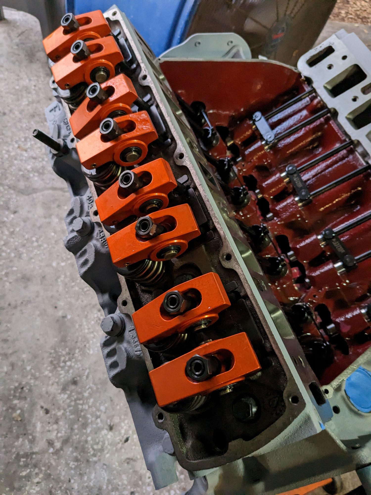

What options do I have for valve covers, 455, harland sharp roller rockers.
Stock notched valve cover with baffles in place won't work.
I don't think I want to use the spacers available unless thats my only option.

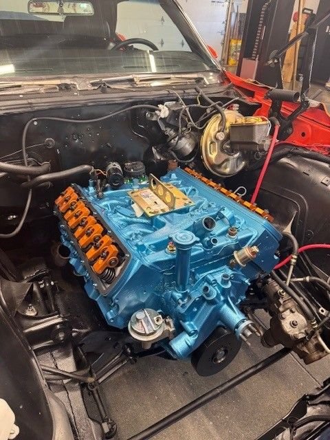

If you want to use stock valve covers just cut your baffle like shown in the picks and use the Edelbrock 7598 gasket.
No spacers, no leaks, OEM valve cover bolts and works like a charm.

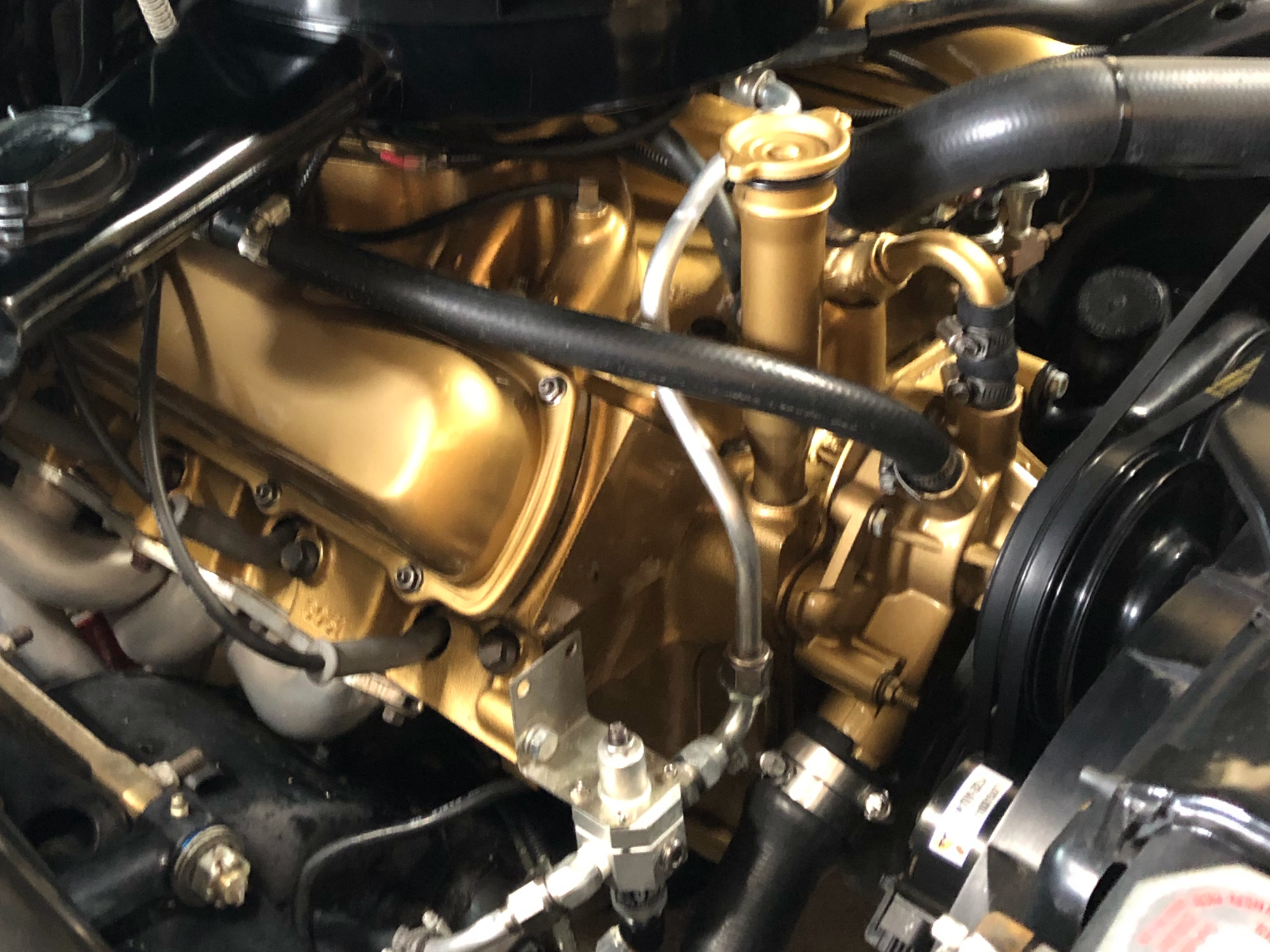

Originally Posted by bccan
From my perspective, the only downside of spacers is choosing longer hardware & 2 pairs of gaskets needed. I’ve been using the same 2 prs of Perma Dry Plus (now Cometic offerings) for 25+ years, on 3 different engines, they’ve never needed replacement. Hurt once (pricey), but never have to buy them again.
Then again, with short locknuts, many get away without spacers, but I still would use the Cometic rigid frame gaskets.
I mean do spacers really look that bad?
Don't mean to hijack the thread but - happy to see I'm not the only one who mounted a fuel pressure regulator at this location. I used mica washers between the head and flange to cut down on heat transfer to the regulator. I like your plumbing, too.
Old Oct 13, 2025 | 02:14 PM
bccan's Avatar
Posts: 1,736
From: West Hartford, CT
If I had my way I would use SAE or JIC/AN flare connections for every fluid connection, it’s just too tricky & expensive for rad & heater hoses! (& not necessary)
I had a long running battle with sustained WOT fuel starvation using a Qjet, thus a higher volume fuel system.
