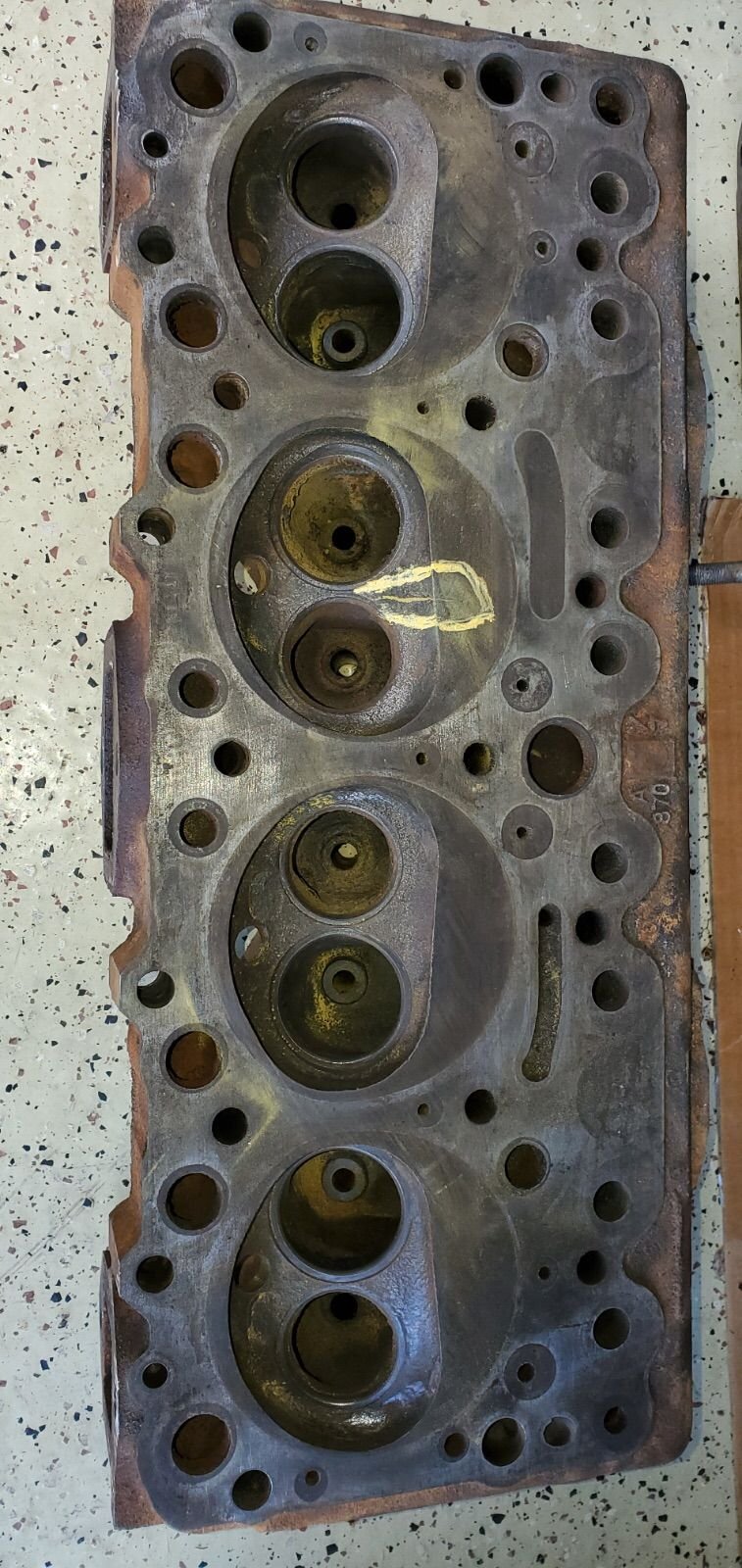

Those heads were definitely polished in the combustion chamber, possibly CC'ed also. The intake runners were definitely polished. Need to see if the outer dimensions match the gasket, usually best way to do the Olds heads. I found that leaving some roughness just before the valves was benificial in that it allowed the fuel droplets to be broken up, not entering chamber as droplets but rather as a "mist". Also narrow seats. I used to grind smooth the channels on the Spring side of the heads to have the oil from rockers get back down below, also chamfered the drain holes on the ends of the heads. Even went so far as polishing the valley to get oil down to pan easier. Olds always had probs w/oil flow and return 49 - 58.

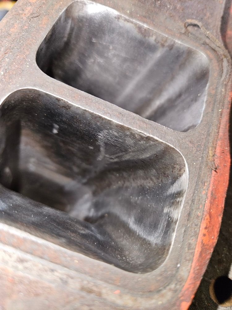

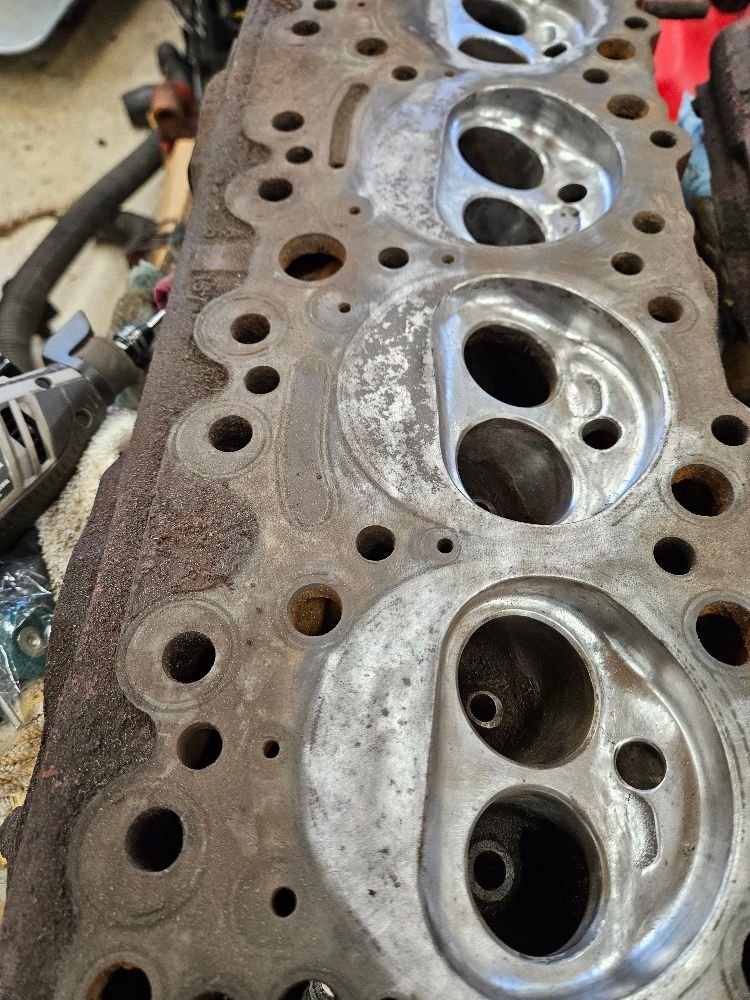

Well that post was a wealth of information. I checked and yes the intakes were matched to the gasket. Just for the heck of it I checked the exhaust and they are matched also. I hadn't expected that since it had manifolds not headers. I didn't have a small enough ball burr for the drain channel you mentioned but it worked perfectly on the drain holes. I was able to smooth out the area in front of the hole and open it up so oil could easily drain. Thanyou for sharing your technique. None of the things you shared have I ever come across.
I did do something else. My first reaction when seeing the valley was that the lifters had beat the crap out of the lifter boss's. Then I realized it was casting flashing. The thought of that breaking off bothered me.. I have now ground them down.

That one slipped my mind, but yes, that casting excess at the bottom of the lifter bosses can also be ground off. I scrounged all those little "tricks" reading thru all the articles being printed years ago by different racers and teams. I even ran a V-Stocker 50 Coupe way back when and did all those things inside. Even mounted a stock 57 J-2 Oil Pan on the engine to get more oil in the bottom. They had a "Can" welded on one side, looked like an oil filter, held an extra Qt. There was also (before Covid) a company in Cal that manufactured head gaskets which were thinner, but had the seals around holes, raised compression. I don't see them listed anymore. I've got (Not for Sale) a pair of Edlebrock cast alum valve covers that have the number 57 below the curved Edlebrock logo. Never saw another pair like it.

The "edges" you ground off is casting flash. This is typical with casting processes. It occurs when the "cores" or "patterns" are removed from the molds after tamping. If they are not tamped well close to the "pattern" the "core sand" will fall out when the mold is turned over and mated to the bottom mold. That casting flash can act as a dam to hold back oil drainage in the valley area. For a while, some people painted the valley area with Glyptal to aid oil drainback.
Intake and exhaust gaskets provide a finish line edge for porting and polishing to align the ports between parts. If your heads have been ported, I would expect to find they matched the gaskets.

When you grind casting flash, try to smoothly blend it in where you end. You want nice smooth edges and "fade out". A slight radius is better than a sharp corner. What are you using for grinding ?

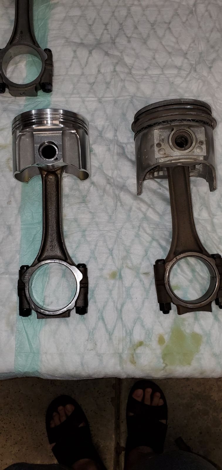

Here's a side by side comparison of the new piston, compared to the factory one. If you go this route the rotating assembly will need to be rebalnced.

Here's a side by side comparison of the new piston, compared to the factory one. If you go this route the rotating assembly will need to be rebalanced.
Whats going on with the connecting rods ? They look different also.

Forgot to mention I had another set of factory rods that were reconditioned. They look different because they were also shot-peened.
