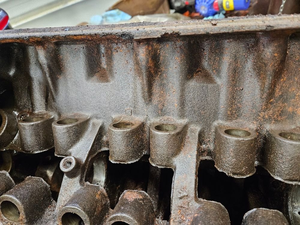

Looking for early Oldsmobile Rocket knowledge. I am dissecting a J2 motor that was out if a 49 drag car. It had the lumpy valve covers and Isky adjustable rocker arms underneath. Valves springs have gold metal retainers.
Upon pulling the valley cover I found lots of rust and roller lifters.
Heartsick at first I started wiping a cam lobe and it looks encouraging. The cam and lifters almost appear to be coated in assembly lube. There is standing oil in a corner of the valley and in the bottom of the intake. Looks like old school "pickling".
My question is about the lifters. I have not seen one like them. Do any of you have experience with them? Who, might have made them? Does this indicate possible roller cam? Who might know how to clean and refurbish them.
Much appreciate any insight.

Old Mar 21, 2023 | 06:04 PM
Run to Rund's Avatar
Joined: Mar 2008
Posts: 4,026
Isky roller lifters and the springs above them are their rev kit.
Old Mar 21, 2023 | 08:15 PM
OLDSter Ralph's Avatar
Posts: 5,219
From: St. Paul Minnesota
That "Rev kit" is definitely a step back in time.

Thanks, so far it looks like they went all Isky. Would they possibly run these with a solid cam or only with a roller cam?

The "rev-kit" was only used with roller cams. In those days valve springs were not developed enough to control adequately the rest of the roller cam valve train; thus the assist of the "rev-kit"!

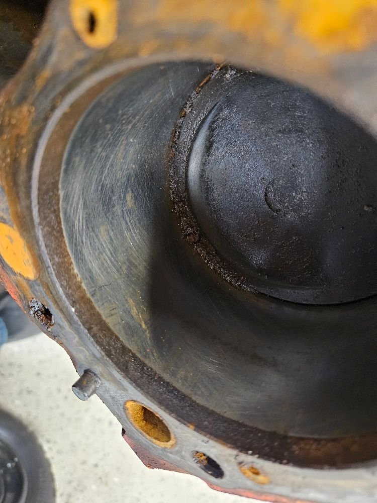

Couldn't stand it so went to the shop and removed a head. Rockers look excellent so they are a keeper. Heads will need to be done so will try to find stainless valves and have hardened seats installed. Exhaust valves were eaten up.
Cylinders have no ridge, can't even catch a fingernail.
Best can see crosshatch. Second is the worst, don't know if hone would clean it up.
Any one got a guess on compression ratio with this piston? Couldn't find any indication of manufacturer. Bore measuring 4.120 so will need to sonic check it.
Currently assuming pistons and cam will be to much for the street even if salvagable

Originally Posted by ncboat
I fully intend to go for a refresh of this motor and saving as much as possible. I think the valve covers came out of iskendarian stock with all the valve train stuff. Really looking forward to seeing the specs on the cam. I suspect it may have Jahns pistons in it so need to get the heads off.
Isky sold the valve covers and supplied them to Oldsmobile.......so the story goes. There were never any "Repops", its the original run of 200 pairs that were manufactured. I think only 200 pairs sounds lower than I would have expected to hear.
Jahns pistons were very popular for Olds pistons, back in the day. I never saw a Jahns piston catalog to know what compression ratio's were available. I do know they offered "forged" 12 1/2 to 1. The stock pistons were pretty much flat, so I am guessing you have forged 12 1/2 to 1 pistons.
Look for numbers on the cam to help figure out what cam you might have.
Compression ratio, see above.
Check the heads closely for cracks.
Since the bore is 4.120", it has been "punched" to 394 cubic inches. I think you should sonic check the wall thickness. You might be able to use an O.S. or custom 394 piston.
Disclaimer: I "think" the 371 and later 371 & 394 pistons have the same piston pin to crown height (now called the "compression height") My 1958 CSM shows 1.895" to 1.898". You need to check the 1959 to 1964 CSM to verify that its the same.
Connecting rod center to center is 6.625" according to the 1958 CSM. I have a 1964 CSM, but I can't find it right now. Charlie Jones will be able to help with his 1963 CSM.

Great info, thank you. I am bracing myself to have to have custom pistons. When I have a little bettter knowledge of what I am looking for I will reach out to Tony.
What would max bore be with a 371? I will absolutely sonic check the block. Did the heads have a common place they cracked?

Max bore for a 1957-58 "371" would be based on material thickness in your cylinder walls. Thats where the ultrasonic check for thickness will guide you.
1. "My thought" is to find a machine shop that can precision hone the bores with a honing plate. I can't help but wonder if a 455 honing plate would work, since they are the same bore size (4.125") and cylinder head bolt pattern could be close enough, to see where they clean up.
2. If honing won't clean up the cylinders, then you have to bore them, and cylinder wall thickness will be important. I would try to hold boring to .020" but you may have to go .030".
3. At this point, You need to talk to Race-Tech Pistons or Egge about custom pistons. My question would be, what "slug" are they using for your pistons. Do they use a different slug for 371 (4.00" bore) than the 394 (4.125" bore) ? My reasoning process here is........is it easier to get a .145" O.S. piston for a 371 or a .020" O.S. piston for a 394 ? Since you are getting "custom" made pistons, you should be able to specify the size. When I talked to Race-Tech, custom pistons for my 371 were about $750 a set.
4. I would have the block "decked" for a square and flat deck surface.
5. You should clean the top of about four pistons and mark them #1, 2, 7, and 8). Then measure how far down in the hole they are. When you remove the pistons, you can check "compression height" (piston pin center to top of piston edge (crown). I haven't found a deck height listed anywhere yet, but it does enter into compression ratio calculations.
Head cracks I believe they crack between the intake and exhaust centerline in the combustion chamber. This in generally in the center combustion chambers on #14 heads, but I have heard the same for a few #16's. Note: #14 (1957), #16 (1958) heads.
6. CC the heads for curiosity. I "think" I might have NHRA minimum limits saved someplace, I just can't find them right now.

Lets just go step by step and not get to many things going to cause confusion. Charlie is very knowledgeable and has a wealth of experience. Charlie got 394 pistons from Egge, I believe. I am not sure what oversizes they make for 394. In the "old days", piston manufacturers made +.020", +.040". and +.060" pistons. I think they have decided to only offer +.030" and +.060" to reduce inventory. Race Tec can make them any size you end up with and it would all be the same "custom price".
You really need to two things.
1. Hone or bore and hone the cylinder in the worst shape. This would give you and idea what to do. I wouldn't sleeve a cylinder unless you need to.
2. Ultrasound the cylinders because you are already .120" O.S. to determine cylinder wall thickness.
The compression ratio has to be computed with your machine shop's measurements. They used different thickness head gaskets in 1958. The NHRA head CC's in 1958 were different than 1957. I don't know what the 394 had.
Head gasket 1957 is .025" 1958 is .040"

Started cleaning using WD40 and a brush. It actually works pretty good on this. I wanted it to drain into the pan so I could drain it before turning it over. I will have the block hot tanked but I am encouraged by how it cleans up. I accept it will need new pistons because the compression would be to high with these. The question Is what size.

Were you using stock 371 connecting rods ?
Old May 3, 2023 | 04:51 PM
  #38
ncboat's Avatar
Joined: Feb 2023
Posts: 67
The engine was bored to 394 ci with Jahns pistons, full floating pins on stock rods.
Old May 4, 2023 | 01:18 PM
  #39
halffasted's Avatar
Joined: Jul 2014
Posts: 14
Yes. Learned too late that they stretched under high rev loads. Had Jahn's 10.5 pistons, P,P, & CC'd heads to 11:1 comp. Should have gotten Aluminum rods and Nitrided the crank. Long ago in a distant Galaxy.
