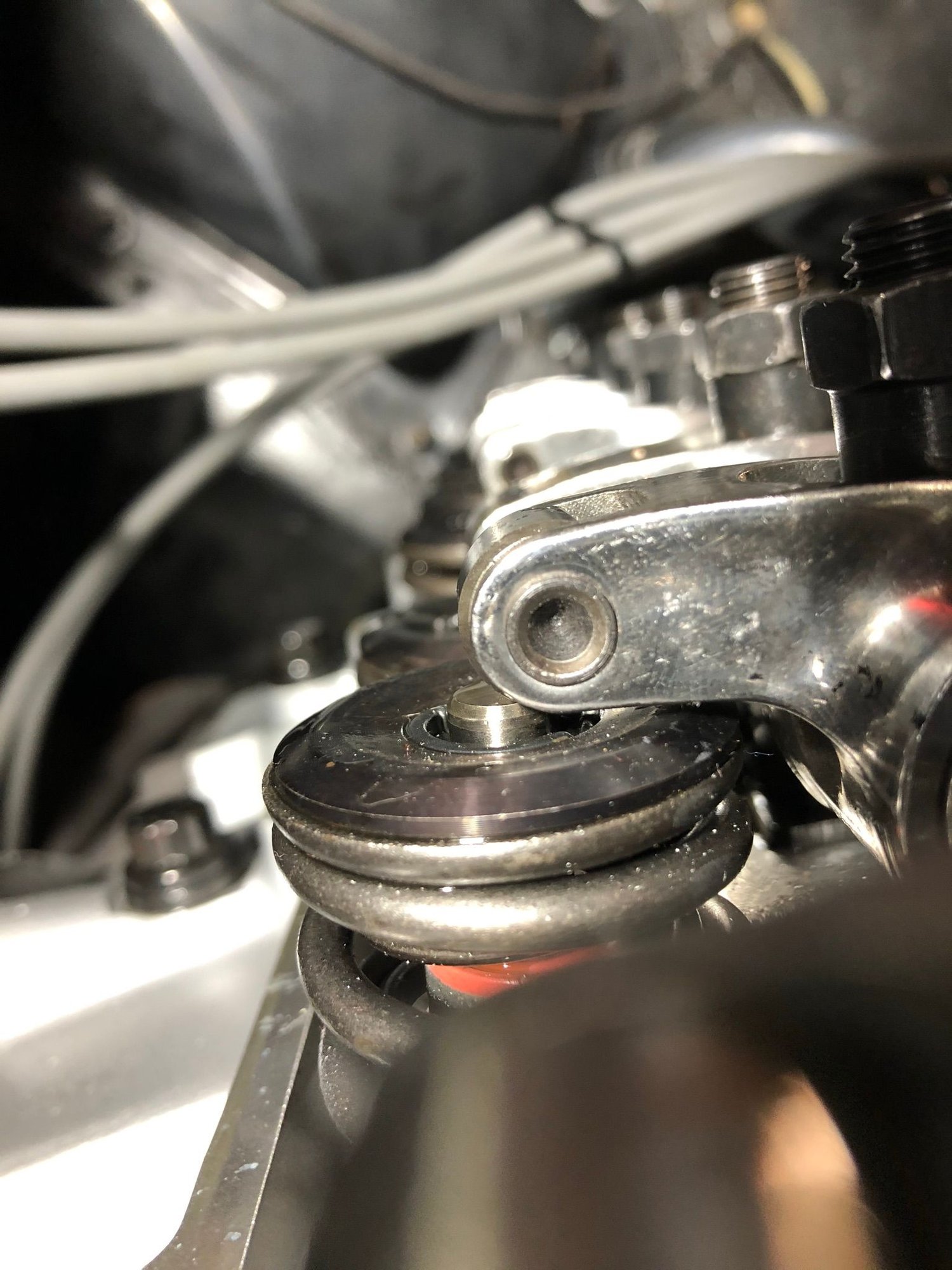

So here is the latest. I read up on pushrod lengths. Seems mine may be too short.
The line at the top, sorry it’s a little fuzzy, is where the roller sits on the valve stem at rest 0 lash
Here is a side angle that shows the roller barely hanging on. .05 lash on this one
the pushrods mondello sent me are 8.5” tip to tip. The stock ones would be 8.4” from what I read, although I don’t think that matters here

I'm not an expert engine builder but I would say the pushrods are way too short. The rocker is way far down on the stud. With the lifter all the way up the roller should be centered on the valve.

That roller looks so far off, is it even possible to get it over far enough w a longer push rod? I ask because i dont know?

The rockers are wrong. They are not over the top of the valve stem. Looks like it's hitting the spring retainer.
Valve height right?
Definitely a geometry problem.

That roller tip doesn't look like it ever reaches the middle of the valve stem and the spring retainer might be hitting the underside of the rocker. You should find out what those rockers are made to fit before you get pushrods to fit them.

Are the rockers wrong or the pushrods? Seems like if the rods are longer, they would be over the valve stem properly. What I read is that they should sit roughly 1/3 of the way from one edge to the other.

The rockers might even be 1.5 to 1 instead if 1.6 to 1 . Measure from the center to the long side, then measure the short side and see if the ratio is correct for 1.6 to 1. Coming from Lynn, he might have sent the wrong rockers.

witness mark is roughly 1/3rd of the distance toward the intake side from centerline. Centerline is the keyword.

I do know there are many dimensions needed to correctly dial in an Olds or any valve train. Deck height, gasket thickness, head height, stem height, spring static and compressed heights, spring pocket depth, rocker ratio... et al...It all stacks up.
Looks like you have a bit of adjustment on the lash nuts. Take off a lash nut on one cylinder that's on the base circle of the cam and manipulate the rocker up to simulate a longer pushrod. Will the tip center on the stem?
Do you have all the part numbers off of everything...Cam, lifters, rocker assembly, heads....etc? That data is nice to see what the existing dims should be. Then get out the micrometers.
