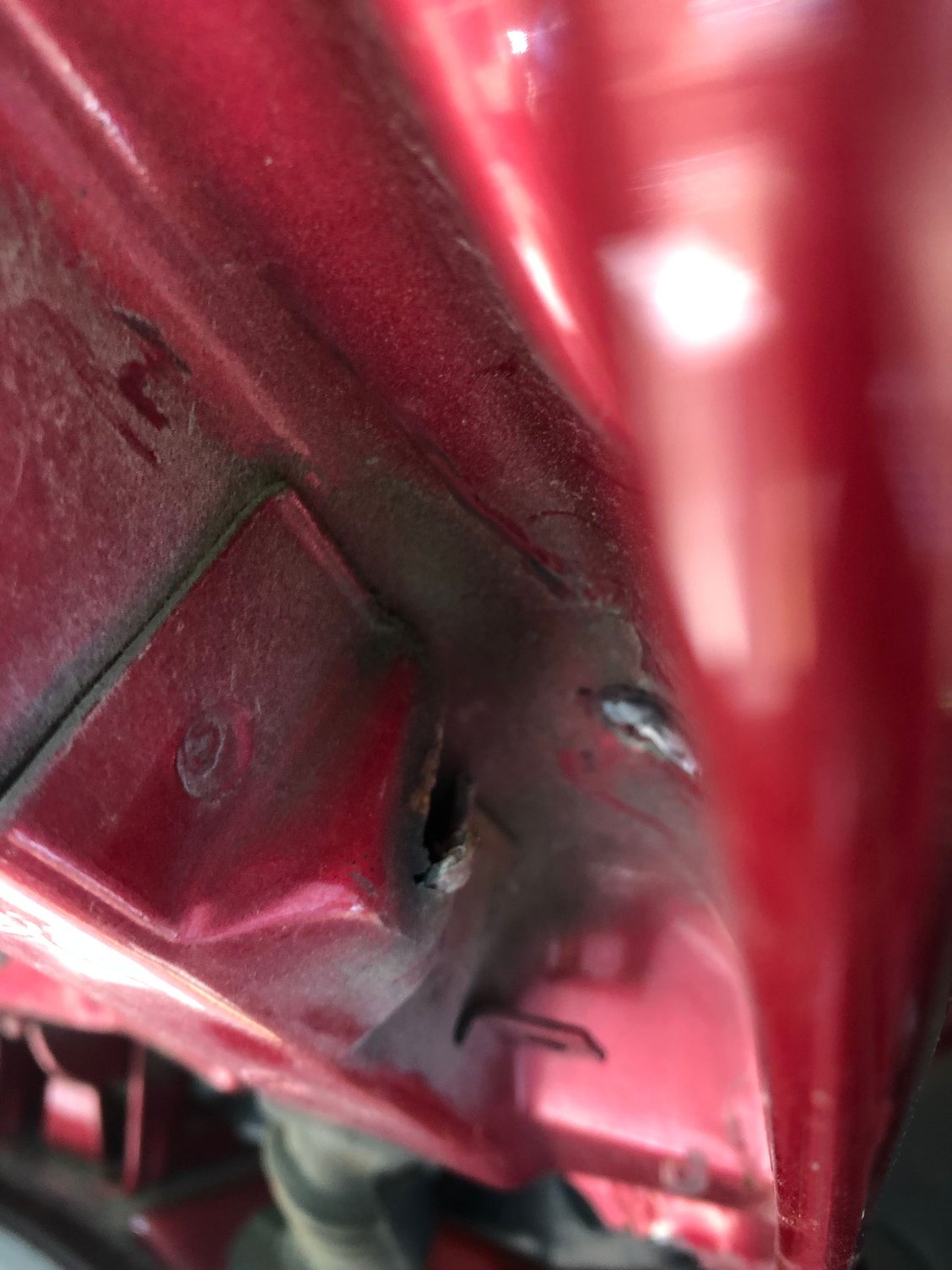

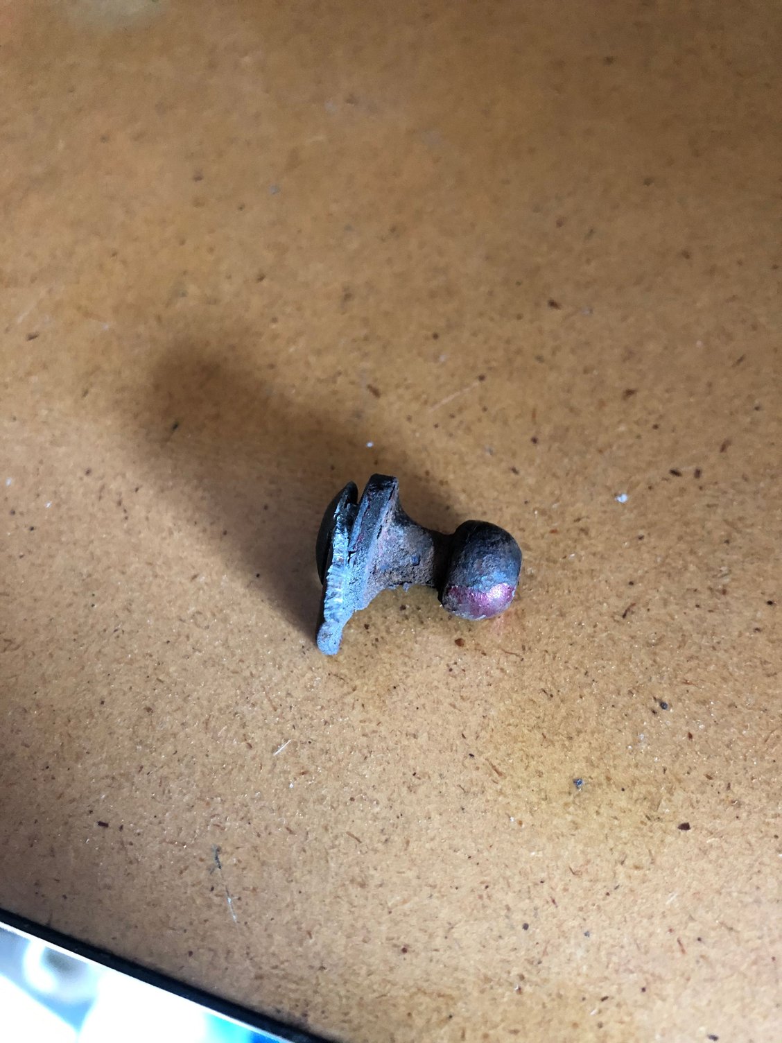

Old Jul 4, 2023 | 03:47 PM
deaddds's Avatar
Joined: Sep 2009
Posts: 2,858
Here is the tit and fracture.
Old Jul 4, 2023 | 04:28 PM
Posts: 12,810
I'd get someone to take off the bracket, one spot weld is visible, weld the tit in, slap a strap across the back, weld that down, then tack in the fixed bracket, test fit, fix, then burn it in.
Old Jul 4, 2023 | 05:13 PM
deaddds's Avatar
Joined: Sep 2009
Posts: 2,858
There are 3 welds but yes. I’m going to check with another shop to see what they say. Other than the hassle, I didn’t expect it to be super hard.
Old Jul 4, 2023 | 07:54 PM
Posts: 42,497
A good welder should be able to repair that.
