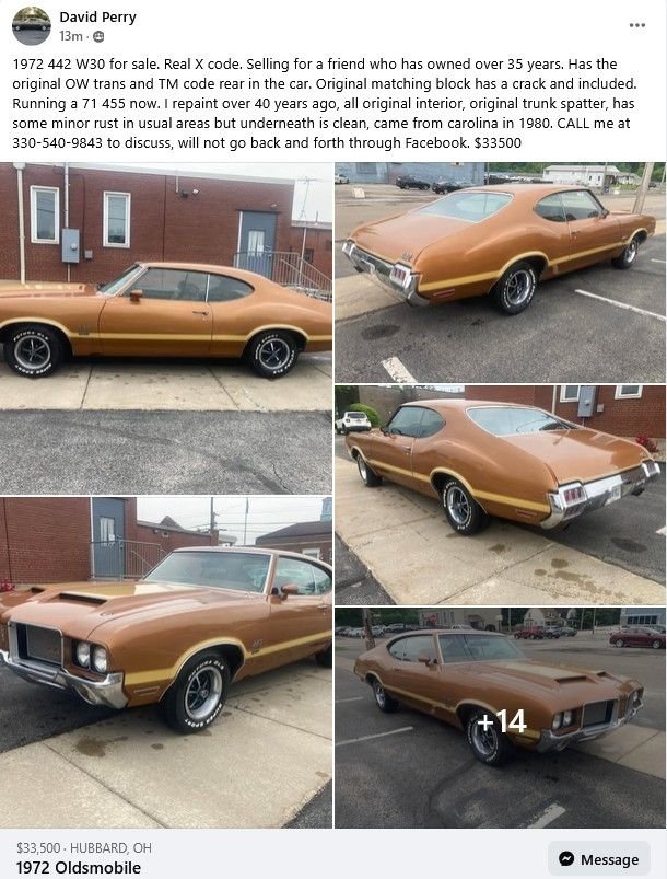

Here is another true X code W-30 on the market now that is much better buy:
