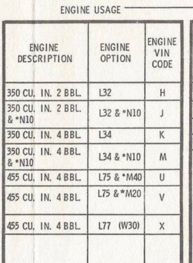

Bob the 1972 W30 is the only one from the original muscle era that is verifiable by vin code. It would have an X.
If its not part of the vin number its not a W30.

Yes X marks the spot and 72 for a W-30, therefore also confirming 442. However, hurst olds may also have an X as the fifth digit, (or a U).
If, as seller states, it was an original 455, U represents an automatic, and a V would be an original four-speed car.
U or V do not denote the 442 option, that would require W-29 on paperwork, but many would agree a big block is next best thing in ‘72, when one could walk into their nearest dealer and drive home with a 350 2 barrel single exhaust 442.

A. Must have "X" in the vin.
B. The vin derivative on the engine MUST match the Vehicle Identification Number.
Fyi: just because the vin has "X" doesn't make the car a W-30 unless the engines vin derivative matches.

1. If X in vin and engine and trans are matching derivatives, numbers matching W-30
2. If X in vin and powertrain does not match, then a much lesser value car that was once a W-30.
3. If U or V in vin, and powertrain matching, then original big block car, maybe not 442.
4. If some other digit in vin, then it's basically Cutlass value.

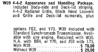

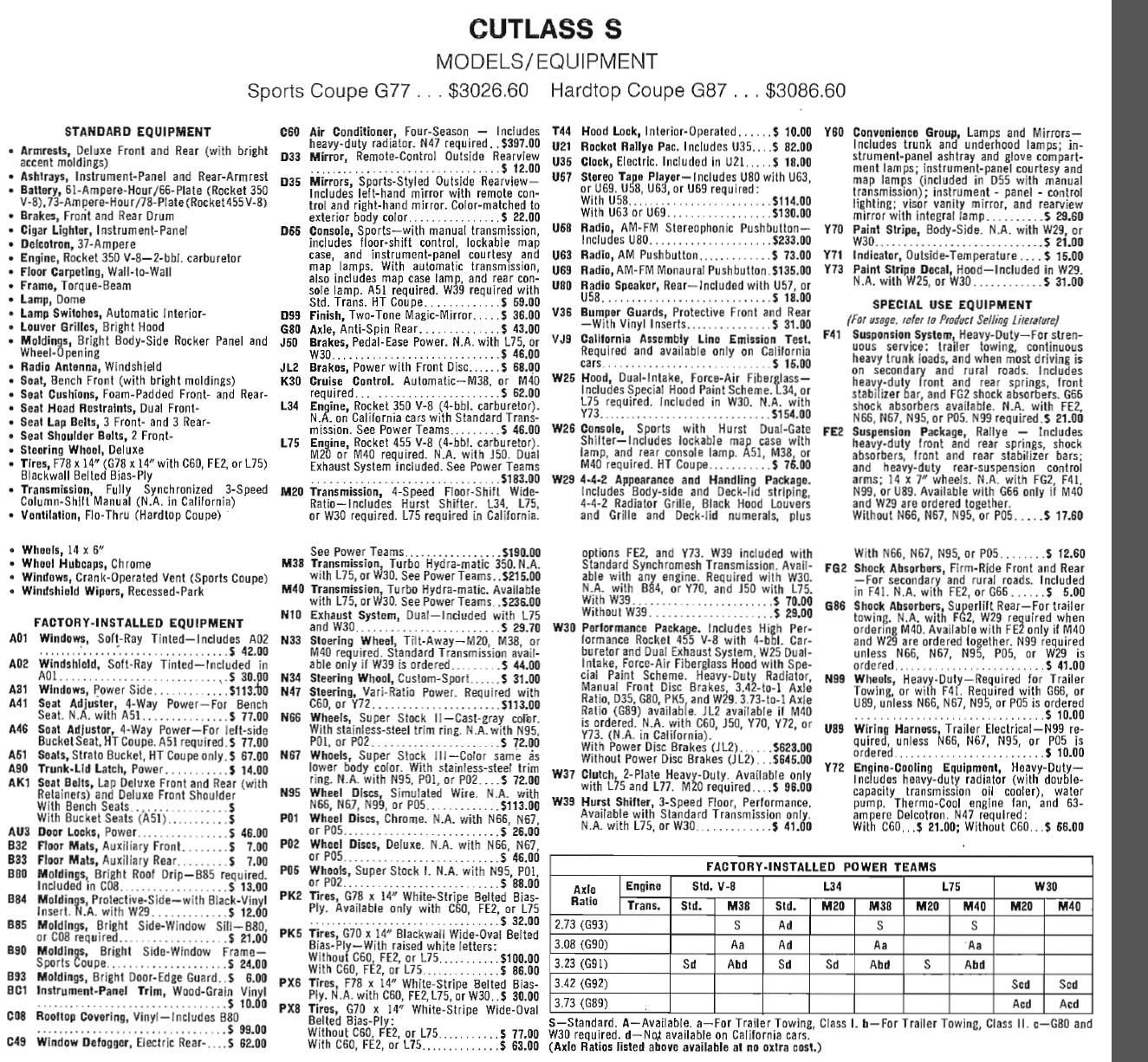

3G787U2Z is Olds Cutlass 2dr hardtop 250 hp automatic trans dual exhaust 455, 1972, Fremont.
So, it is, at the very least, a U code Cutlass. If the powertrain matches, it is the powertrain of what a big block 442 would have had. One should buy with confidence based on U code numbers matching. Now, for the 442 stuff, see this:
W39 is the Hurst floor shifter. B84 is granny grocery anti ding side moldings, Y70 is the Cutlass paint stripe, and J50 is 4 wheel drum power brakes and L75 is the U code 455, which this car has. In other words, no door ding strips, no Cutlass stripe, no power drums. This car either has 4 wheel manual drums, or some form of disc brakes.

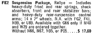

Y73 is the 442 paint stripe, you need that, and FE2 is the suspension package, which is this
That's springs, shocks, stabi bars front and back, and boxed rear control arms. Look for stuff that has been there a while, like light rust, and GM correct bolts. You can post pictures and we can help.

1972 442 pecking order by horsepower.
160hp
175hp
180hp
200hp
250hp (U code)
270hp (V code)
300hp (X code)
