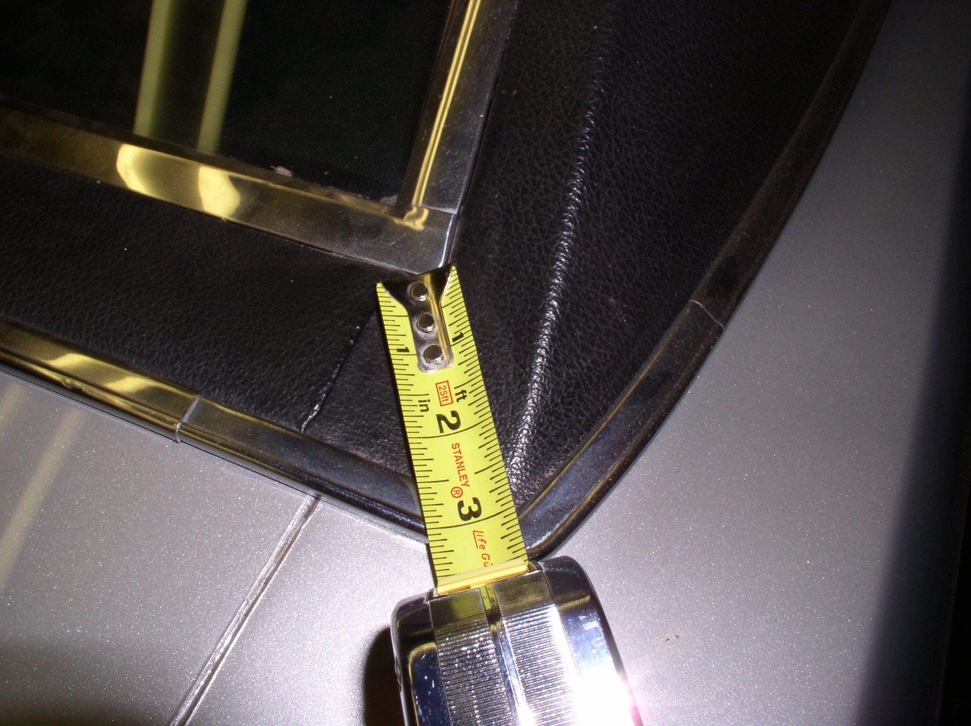

measurement? Does this help

Hell yeah , what's that bout three inches, That is exactly what i needed thank you so much

2 3/4 or so
