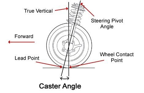

You want to remove from the front and add to the back. That means moving the upper ball joint rearward relative to the lower. The spindle axis needs to intercept the pavement in front of the tire contact patch, not behind it. And yes, swapping equal amounts of shim from front to back will accomplish this with no (or nearly no) change to the camber. This assumes that you have the same thickness shims on both sides. Unfortunately one shim is unlikely to provide much caster change. On my 67 Delta I have no shims at the front, quite a bit at the back, and I can't even get 2 deg. I'll be modifying a second set of upper control arms to relocate the upper ball joint rearward.
Note that the definition of "positive" and "negative" caster angle vary. I've found plenty of completely conflicting references. Suffice to say that the caster angle needs to look like this. Also be aware that the more you change caster, the more it can cause a toe change as well.
All spot on, the only thing lacking in this post is which side of the car your diagram refers to.
Think of the caster on the wheel of a small cart for carrying a load or around your house, or on a front bicycle wheel. A castered wheel either leads or follows, depending on the angle of the axis. On a car you want it to lead, as Joe indicated pretty much as large as mechanically possible.

Thanks.Joe
That is what I meant to achieve. I just forgot how the cutlass is shimmed for a moment.
