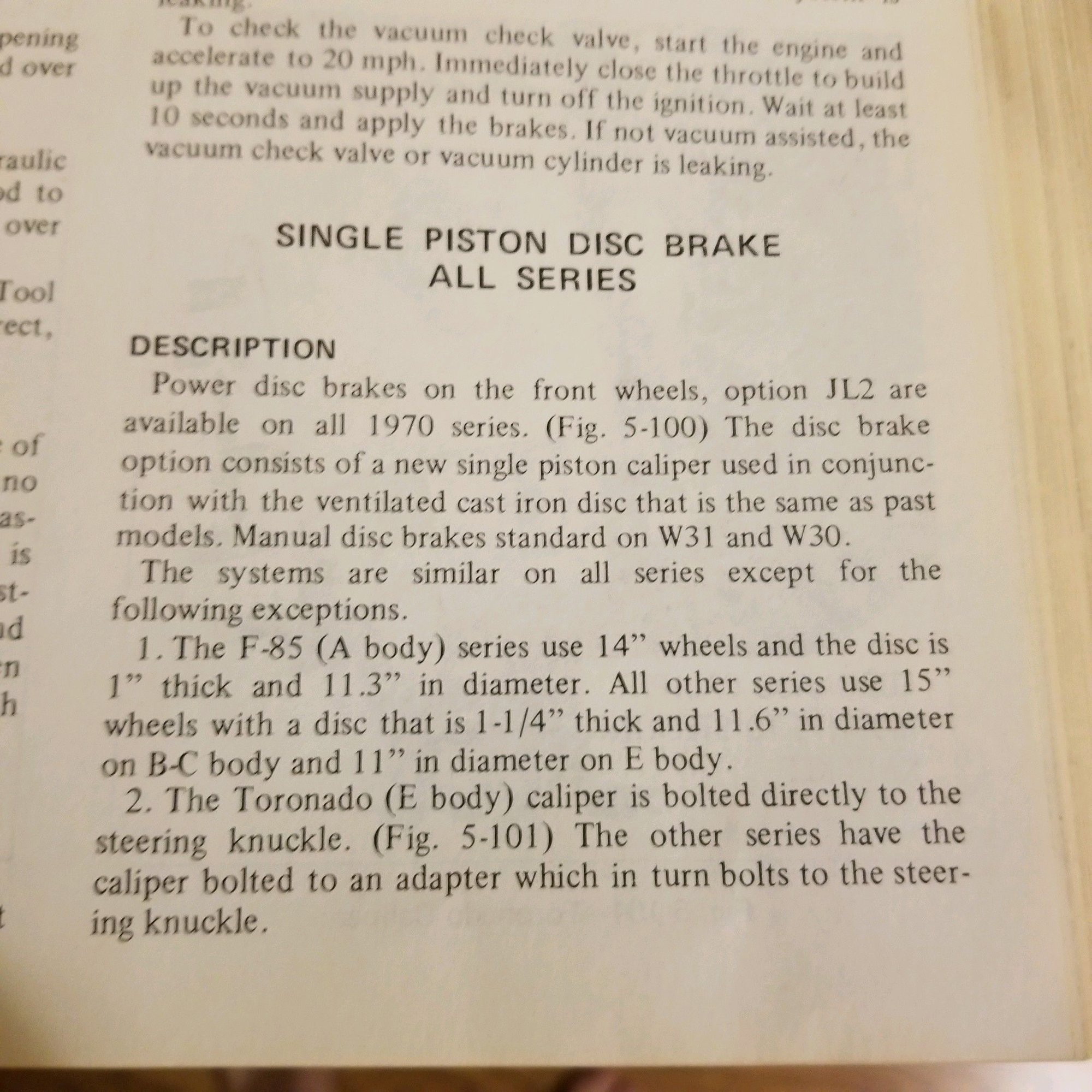

FYI,
From 1970 Oldsmobile Chassis Manual Section 5, page 43.
