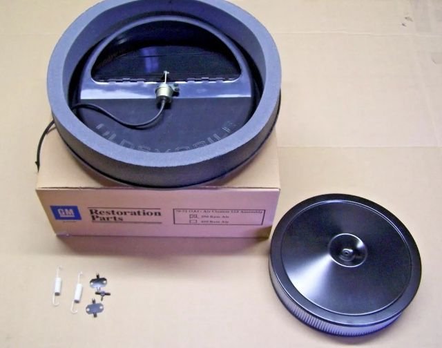

Here’s (last) one on eBay from Thornton, not sure if it’s new old stock but seems to be GM item. Also seems to answer my question, other thoughts about how “Oldsmobile” lettering looks in silver versus black?

The production air cleaner adapters were all black. You will see period photos from magazines and even Olds PR photos that show them painted, but that was not the case for production parts.
Thank you Joe, as always great information.
That is a repop. They are licensed by GM so they put it on the box. Makes it look like a GM part but it is not
The key to knowing it's a repop is "GM Restoration Parts". Nothing with that logo will be NOS, although in *some* cases, they may actually have the original mold/die/tooling to do the repop's. As you stated, they are officially licensed by GM, and the parts are published in the GM Restoration Parts catalog.
