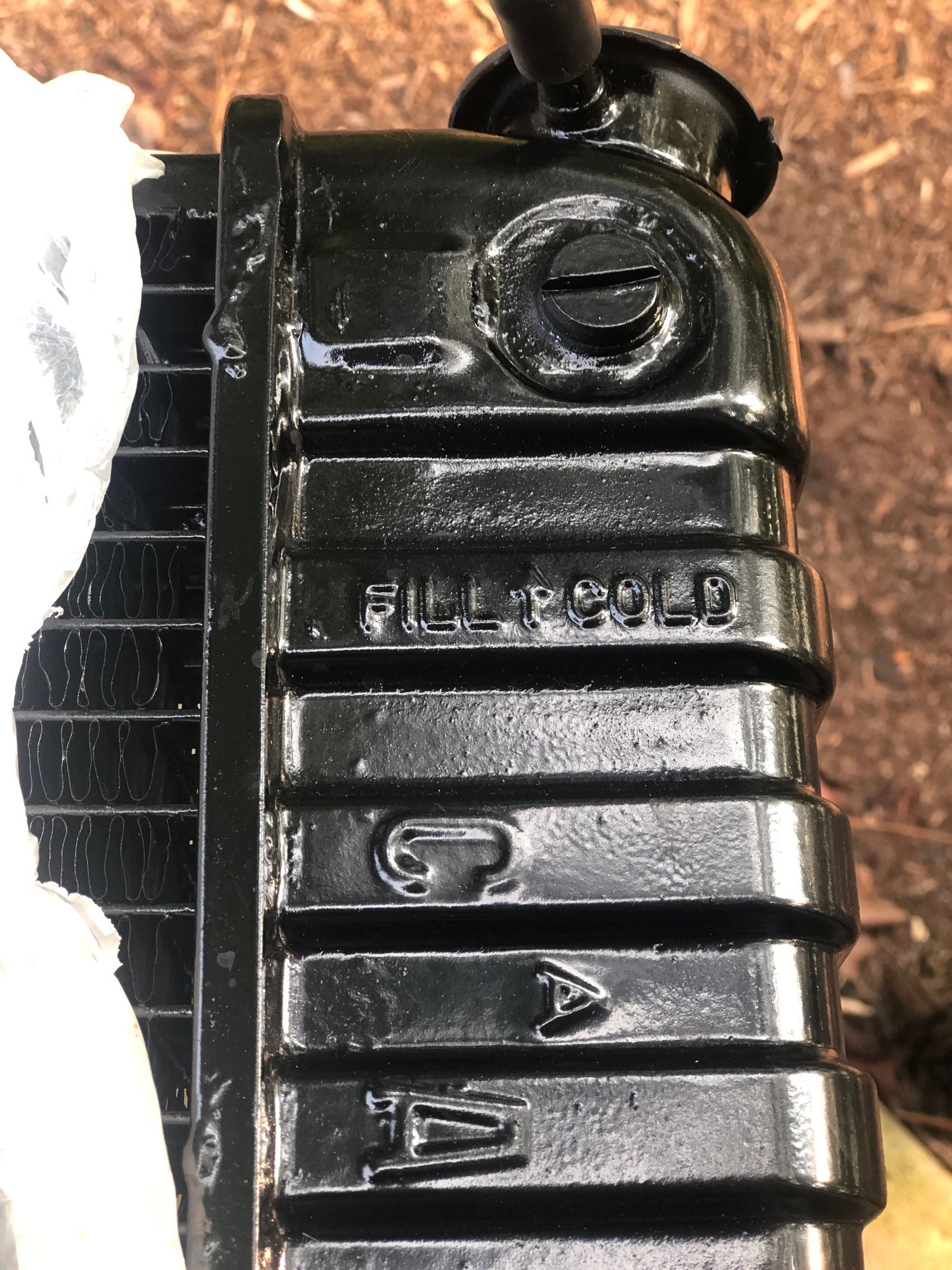

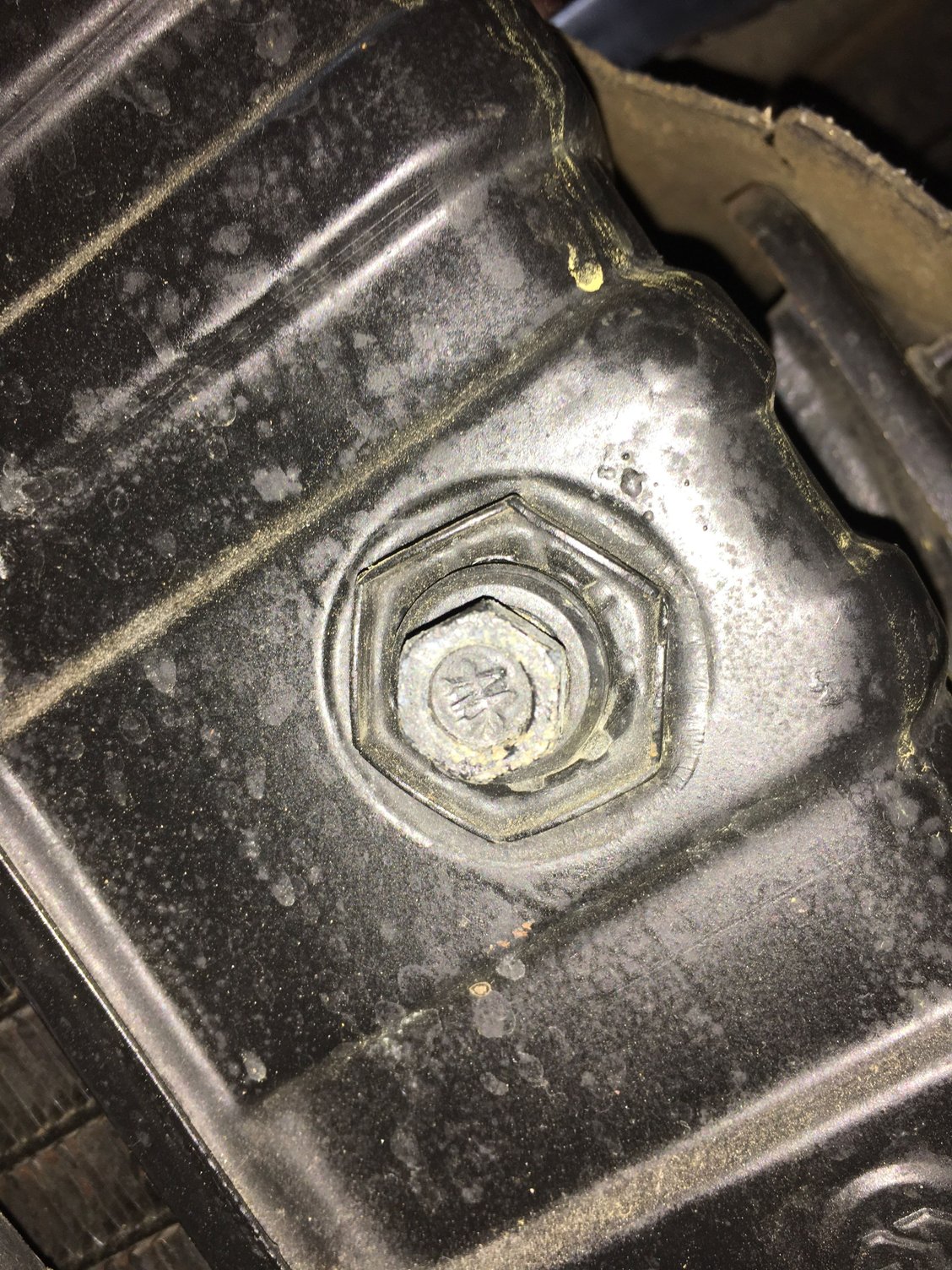

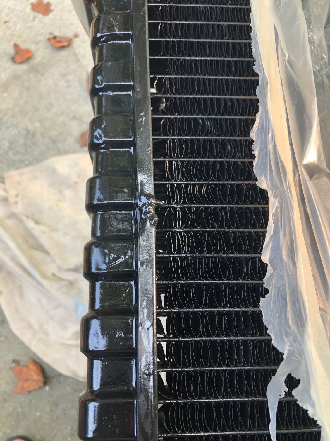

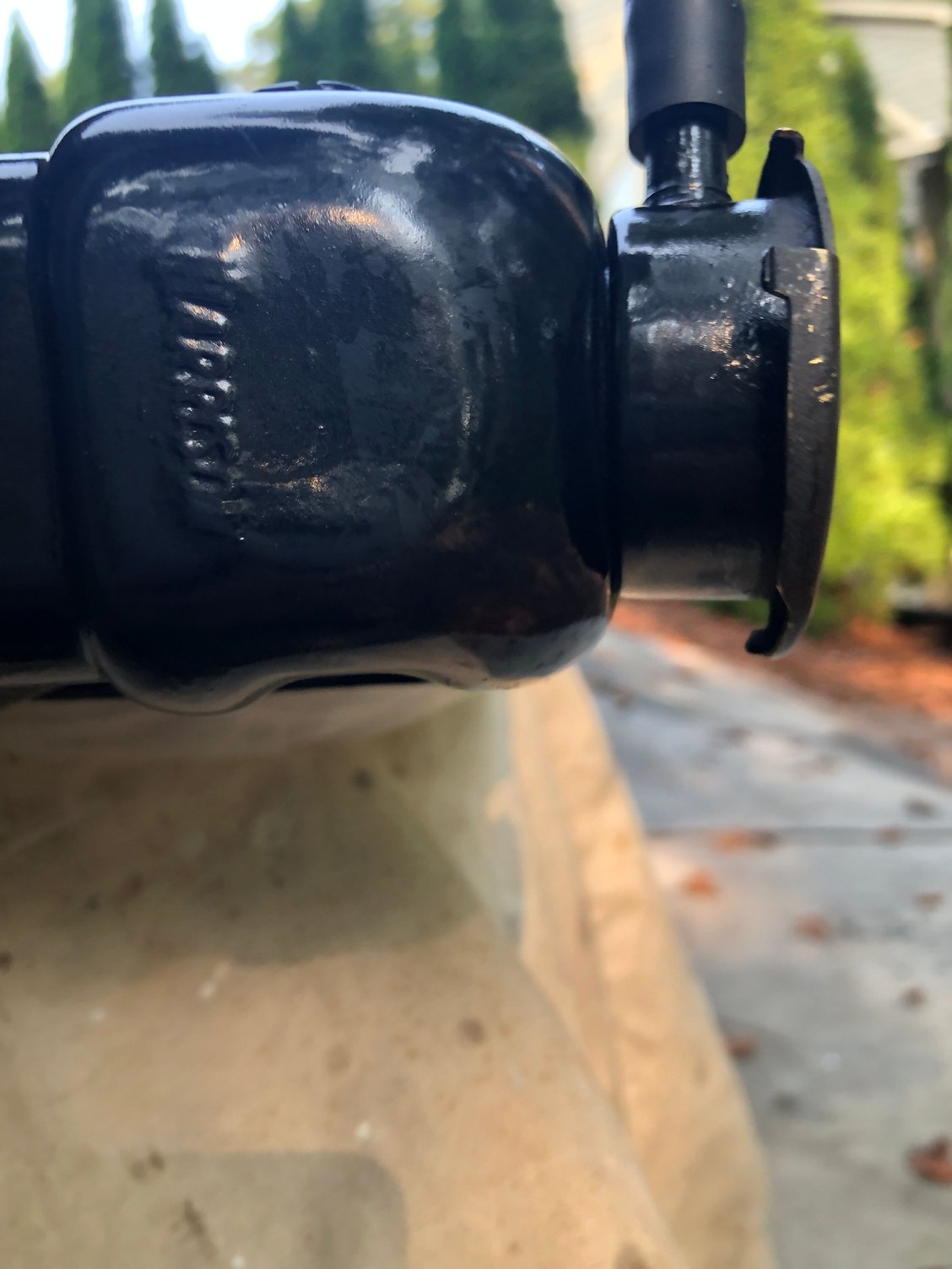

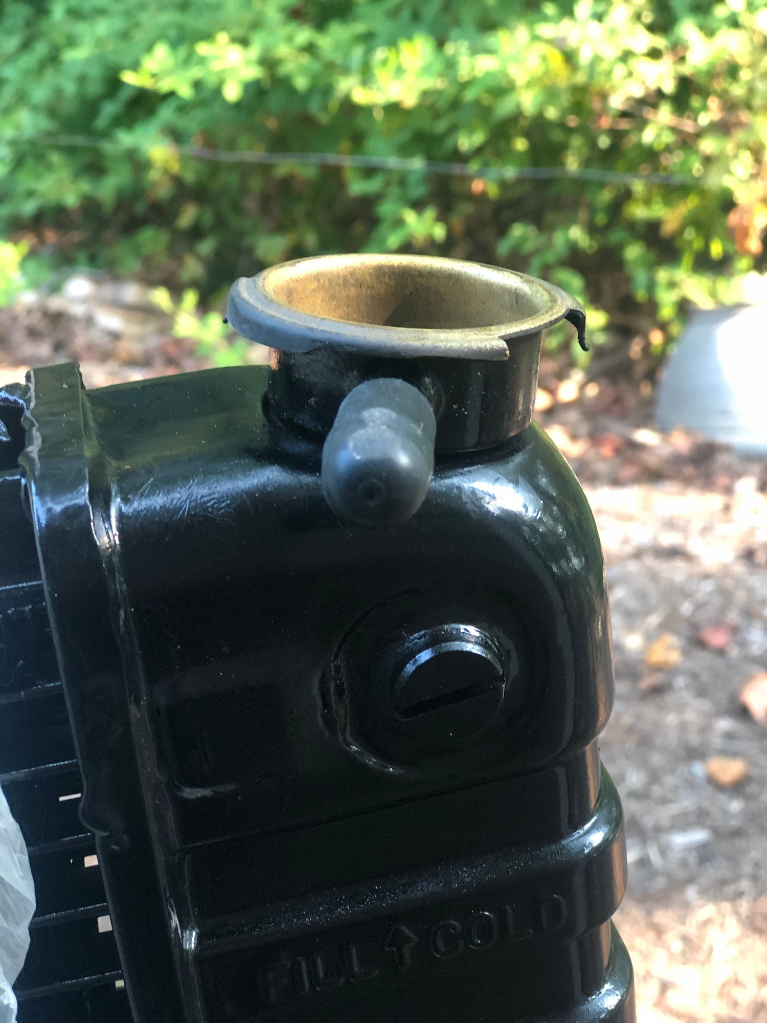

Andy, in 1970 W30 presented with either a 3 or 4 core radiator. Cars with ac received a 4 core, or with 3:91 rear end, V01 option.
Rear end ratio 3:42 received the 3 core V02 option. The bottom tank outlet is larger on the ’70 version radiator.
GM transitioned to the slant tank filler opening in 1971, and by 1972 all radiators came that way. You may also want to investigate your radiator cap too.
I’ve attached pictures of the correct radiator for the ’70 W30 4-speed with 3:42. Harrison stamp several inches down from the filler cap which is about at 1 o’clock with a non-slant feature; LH tank embossed I A; RH tank C A. The small capital A is the January month code. The transmission plugs are standard flat-blade type.
A 3:42 W30 4-speed presented with no fan shroud, but did have a clutch fan (OR 4949861), and the 404837 X water pump along with the KM (405461) 2 groove water pump pulley.
Probably more information than you wanted, so perhaps it is helpful. Credit given to past RocketDevo posts.
