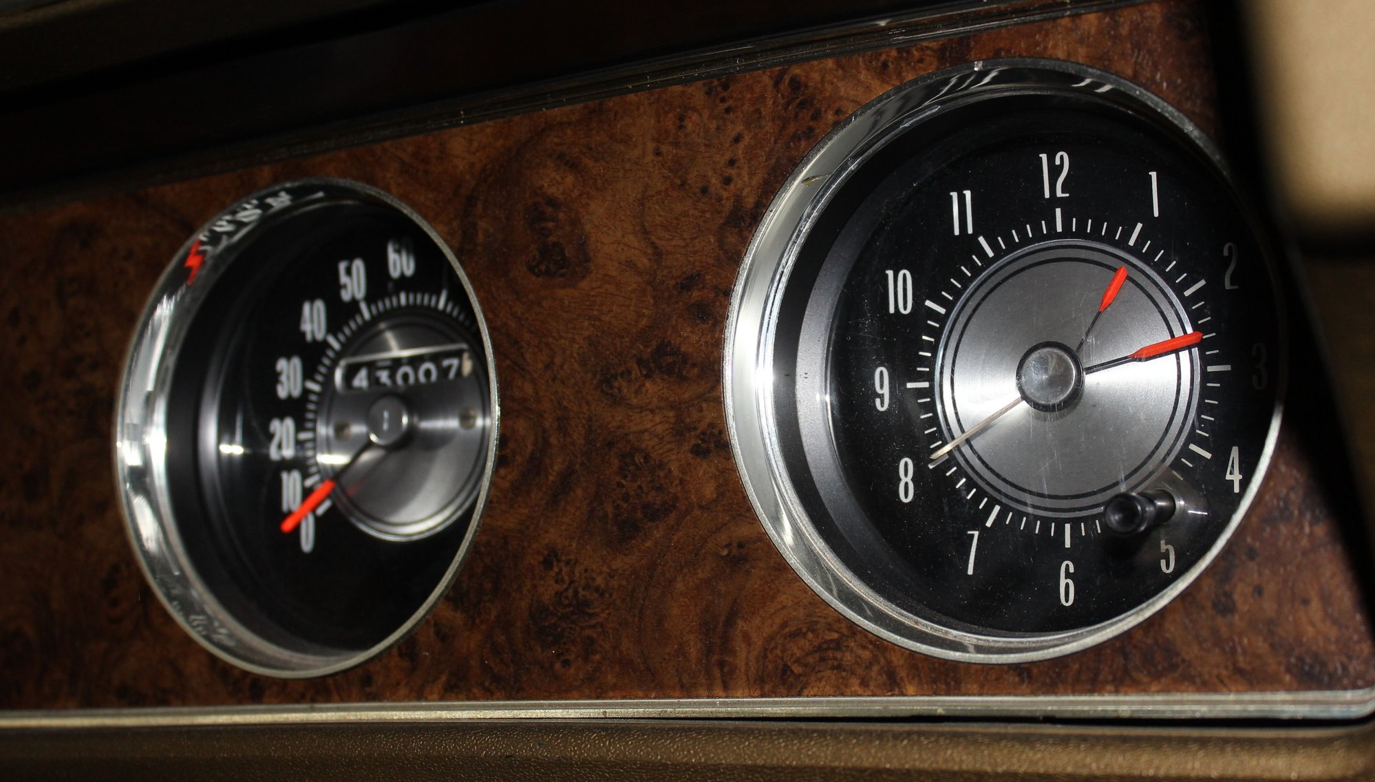

Tic Toc Tach (clock / tach combo) was part of the Rallye instrument package that also had oil pressure and water temperature gauges. The "regular" clock was a completely separate option that as far as I know could be ordered on any level Cutlass. There was no other tach option.

On a 1970 442 you could order
  • A standalone clock
  • The Rocket Rally Pac which included the tach and clock as one unit.

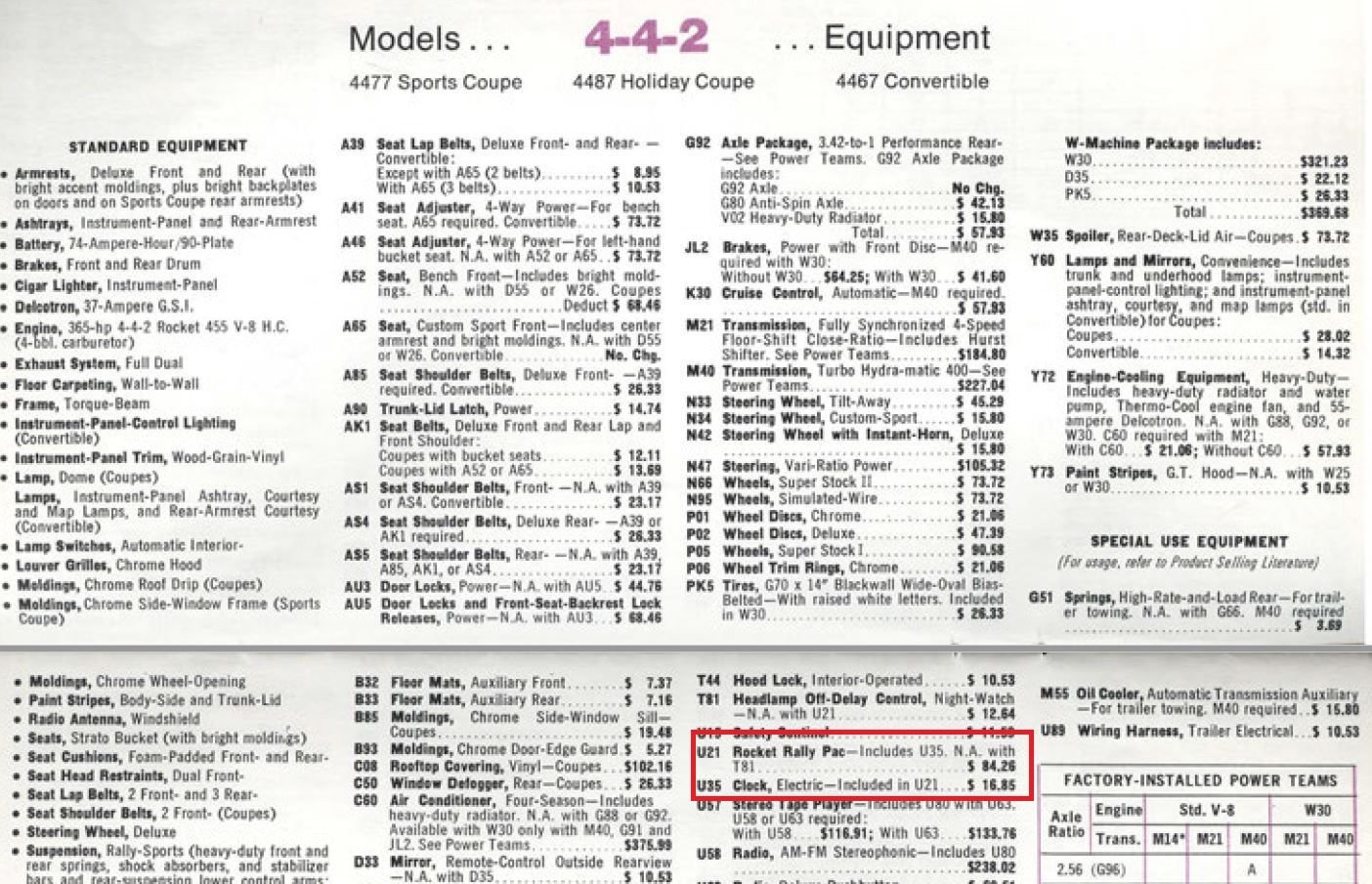

If just a clock was not possible, where did all of them that you see out there come from?
My 1970 Cutlass had a plain clock.
Here’s a build sheet showing the U35 option as a stand alone:

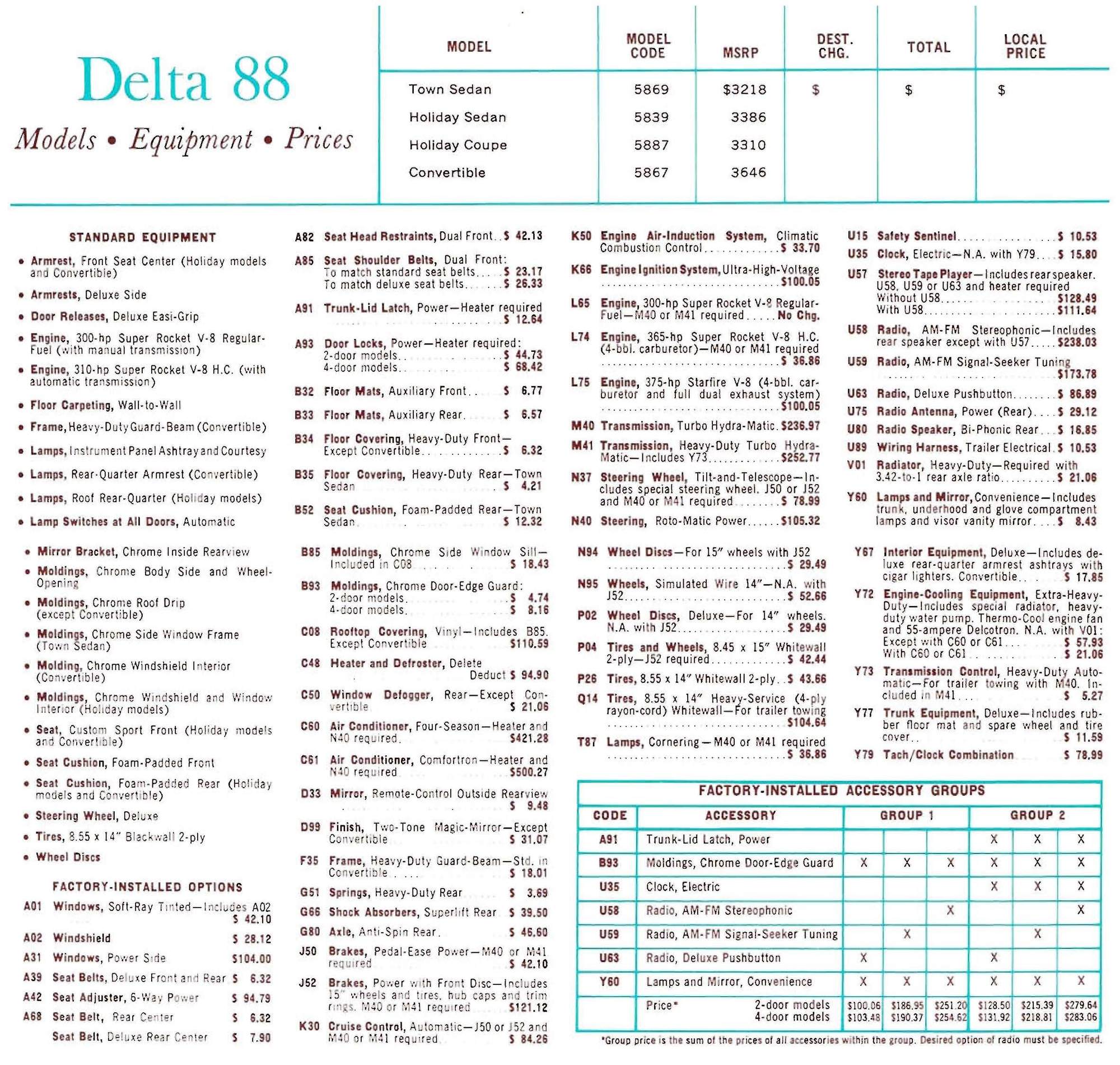

Olds has only offered the Tic-Toc-Tach without the matching gauges in one year (1967) and only on the full size cars (RPO Y79). It was never offered by itself on the A-body cars. This was essentially the same tach/clock combo used in the 1968-69 A-body Rally Pac option.

I have build sheet for a '70 442 with a U35 clock.
