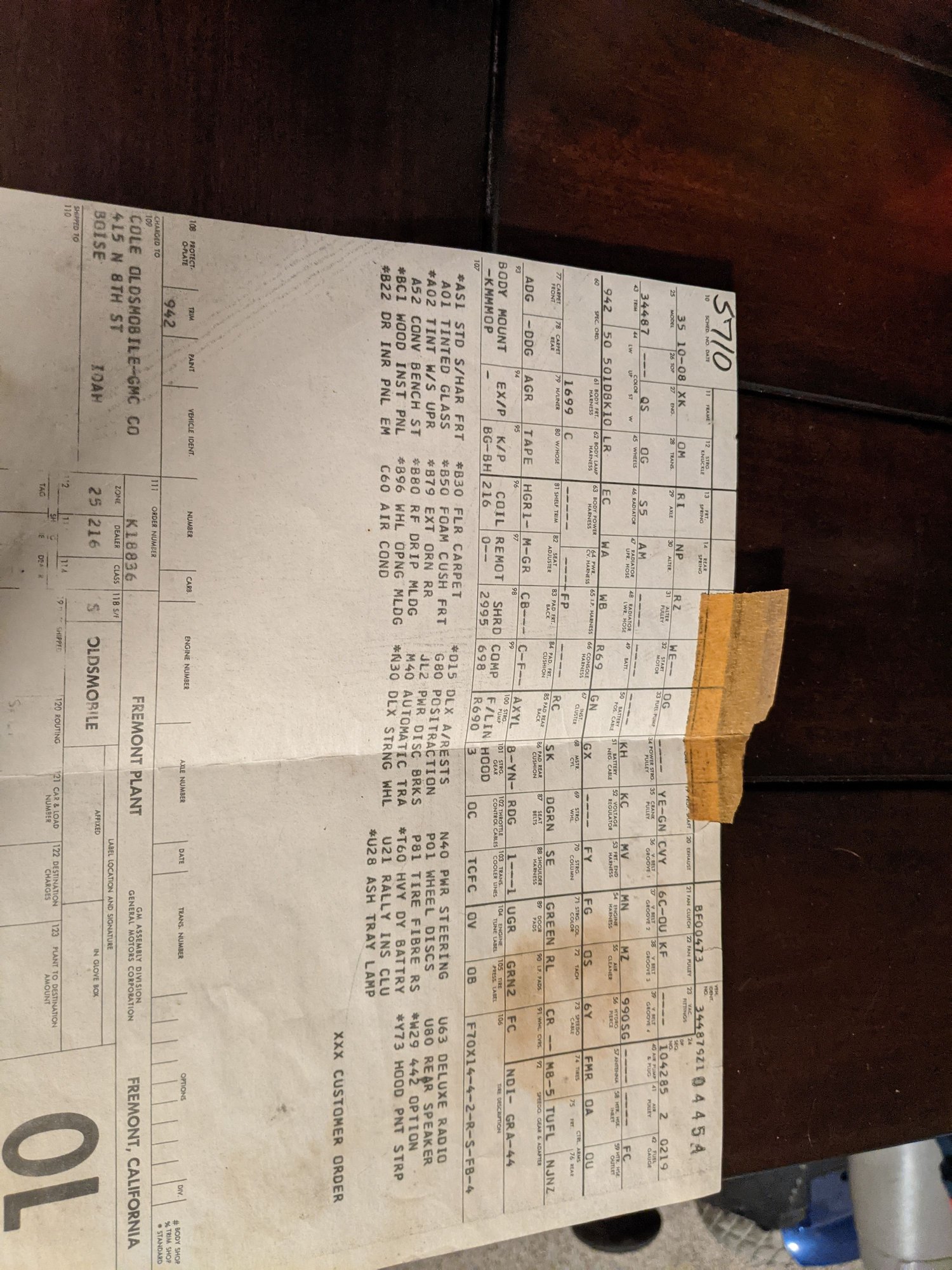

Here is the build sheet. If it is on the rare side I am considering going all original. I already started building it my way.

QL would be W-32 engine code. Yours shows QS. Which is auto 400 found in 68/69 442. Also, I didn't see any W-32 option on the sheet anywhere.
It appears you have a nice example of a 442 with TH400. Still after 50 years...not that many around. Rare in the fact that survivors are dwindling, but rare as an investment vehicle? I would say no unless there's some sentimental value to it.
The car came with a regular" 442 air cleaner in block 55.
GM p/n 6484804
Cleaner, Air Cleaner Asm- Code "OS"
1969 442 400 4bbl (exc. OAI)
1969 455 perf. engine except Toro.

Olds built 19,587 442 Holiday Coupes in the 1969 model year. Bench seat column shift automatic is relatively rare but not particularly desirable. Still, it's rare to have such a well-documented car with build sheet. Totally restored value would probably be low to mid-20s. It would likely cost you that much to get it to that point, however. Your call.

Thanks for the information. I was having some troubles figuring out the build sheet. I'm still in the process of building it. So pictures I do have are not very good. Currently I'm working on floor pans. Engine is done 455 punched .30 over, transmission is a built 400, suspension done.
