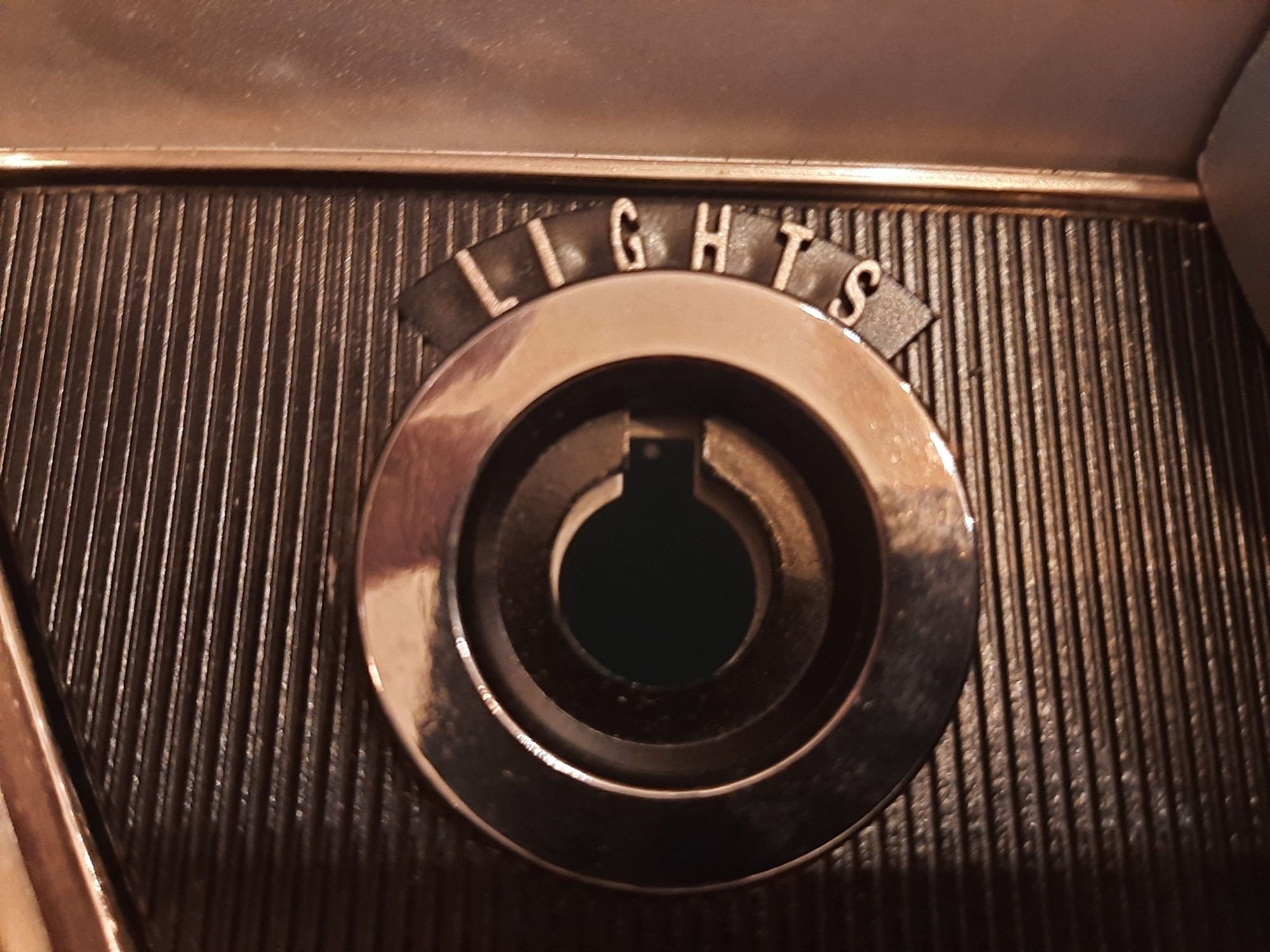

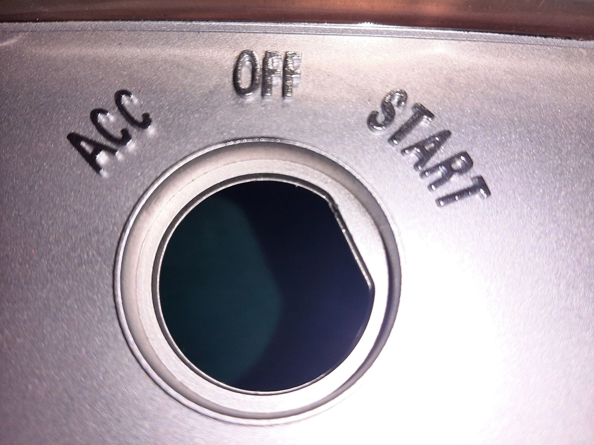

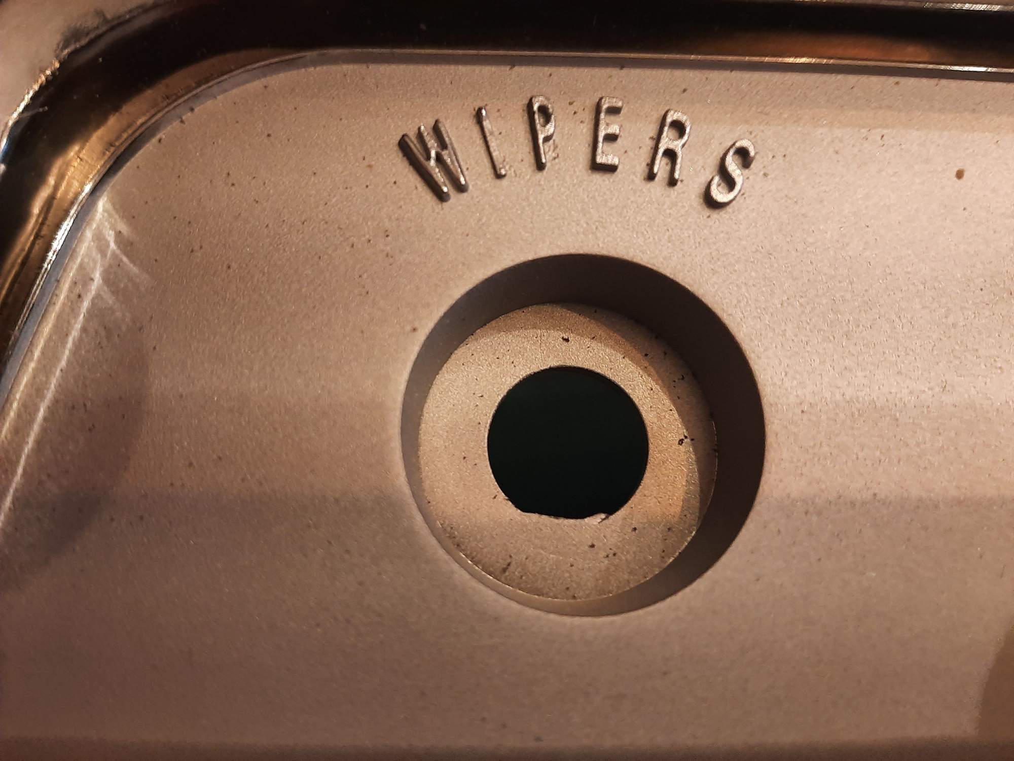

All of that work repo'ing the dash bezel and they didn't get it right. TPP is notorious for that. Not knocking you oldsmaniac,not your fault.
What didn't they get right?
The lettering around the switches and gas gauge opening are supposed to be chrome,not painted

The lettering around the switches and gas gauge opening are supposed to be chrome, not painted
Hard to see in the picture but the letters are not painted silver like the rest of the dash. They are chrome or possibly chrome painted. The only possible deviation could possibly be that the vertical speaker bars ARE just silver paint, not sure if they should be chrome. For my car this dash is very acceptable and a GREAT improvement over what is there and a thousand dollar saving over what a restored on would cost.

I'd be willing to bet the speaker grill area is chrome under the paint. The whole piece was probably chromed then painted/detailed .Maybe a cue tip with lacquer thinner ????
On that subject does anyone know for sure how much of the grill is chrome ? The few i have are so worn it is tough to tell.
That's better,looked painted in the original picture.
